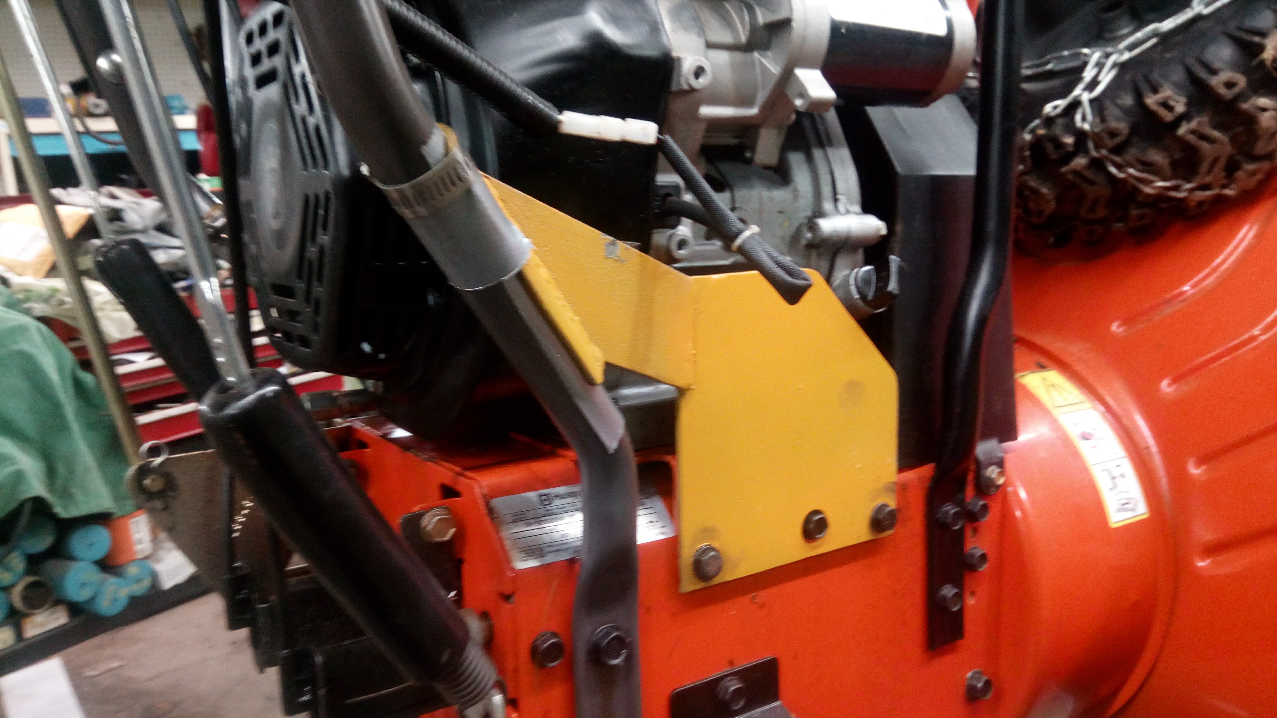

First year the lift cable for the chute broke and it's almost on it's way out again. Traction is terrible even with the chains I added. The bolts that hold the handle on won't stay tight, they're the self tapping ones, even when tight the handle feels like it's about to break. I added a reinforcement on each side for the handle to hopefully preclude breaking and replaced the self tapping bolts with regular bolts, flats and Loctited them in.
