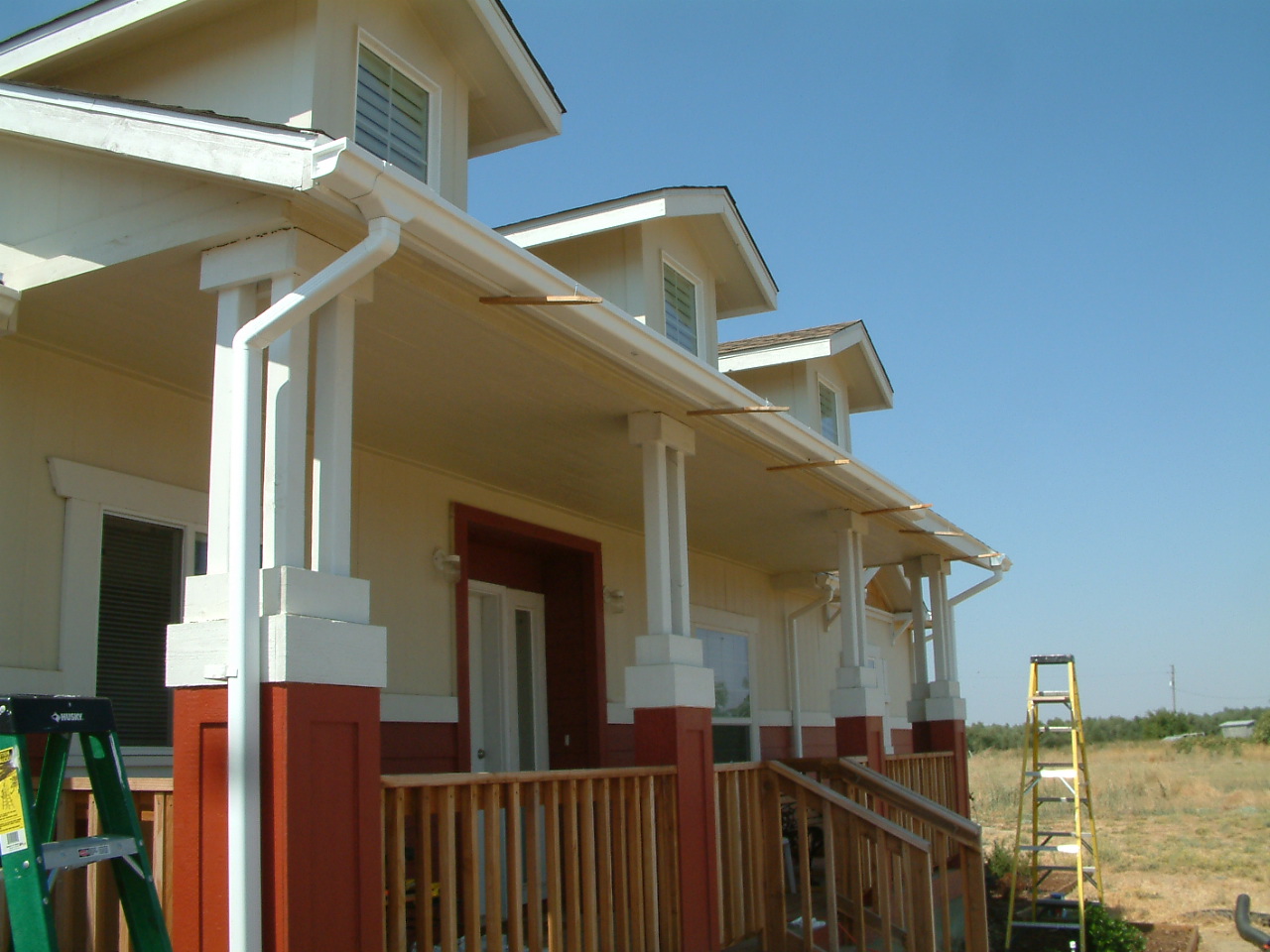

Got leaky gutters? I do.... Not sure if the water running off the roof is just missing, but it seems a lot of leaking for it to be a seam leaking.
   / I hate gutters
Lowe's aluminum....nothing special. I sealed the joints, I still don't think that's the problem.... The bottoms of 2 sections are wet and drip from one end to the other.

Afternoon Bo,
Well it sounds like youve been up there to seal and inspect. I was just gonna add that if the downspout is plugged up and you have a lot of water in the gutter that it could actually leak out of the point where the spike passes through the gutter into the roof joist.
   / I hate gutters #5
Hi Bo. Perhaps you have a problem of your roofing not being sealed to the flashing of the gutter. I have that problem with some of the gutters on our metal roofing. The runoff comes down the metal roof, sort of doubles back a little and runs underneath the gutter flashing, wetting the bottom side.
Post some pics.

Those gutters you get from the box stores are a great value, but they are very, very dificult to get to seal. The almost always leak when you use the sealant they provide with them. I've found that a really good roofing cauld spread over the seams and pushed into the seams on the inside of the gutter will solve your leaking problems.
Make sure the gutters are clean and dry. Use your fingers to really work it into the fitting that holds them together, then spread it out over the fitting. I like to use plenty of sealant so I don't have to go back and do it again. Make sure to go all the way up the sides too!!!
As for sealants, there is a black roofers caulking stuff that is very good. It's pricey, but it takes the weather better than most anything else. Next choice is a top dollar silicone. Window and door type stuff. Make sure it's for outdoor use!!
After your done and it's had a day to dry, use the hose to test it. Just let it run into your gutters and see what happens.

It sounds like an installation problem to me. Gutters shouldn't hold water long enough to have leaking be a problem. You might check to see if you've got the guttering pitched right to flow water and enough downspouts.
My son in law installs seamless gutter for my adopted son. They have a product they call "guttermans friend" that is the meanest stuff the far side of Gorilla Glue. If you get it on you it's a wear off clean up. But it will seal and it's self leveling.
