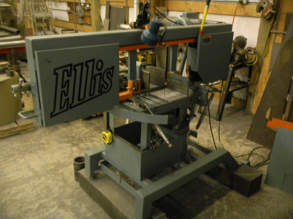

I found an ellis 1500 bandsaw and drove 5 hours to pick it up for $800. :D It's in good shape but appears to have not been used in years. There are a couple things I need to do before putting it to work. The hydraulic downfeed doesnt work and I'm hoping its just out of fluid. Also the vice shaft seems too short to let the vice clamp all the way closed. I'm not sure why it would be like this maybe its just setup wrong or possibly operator error but any material less than 3/4" it wont clamp down.

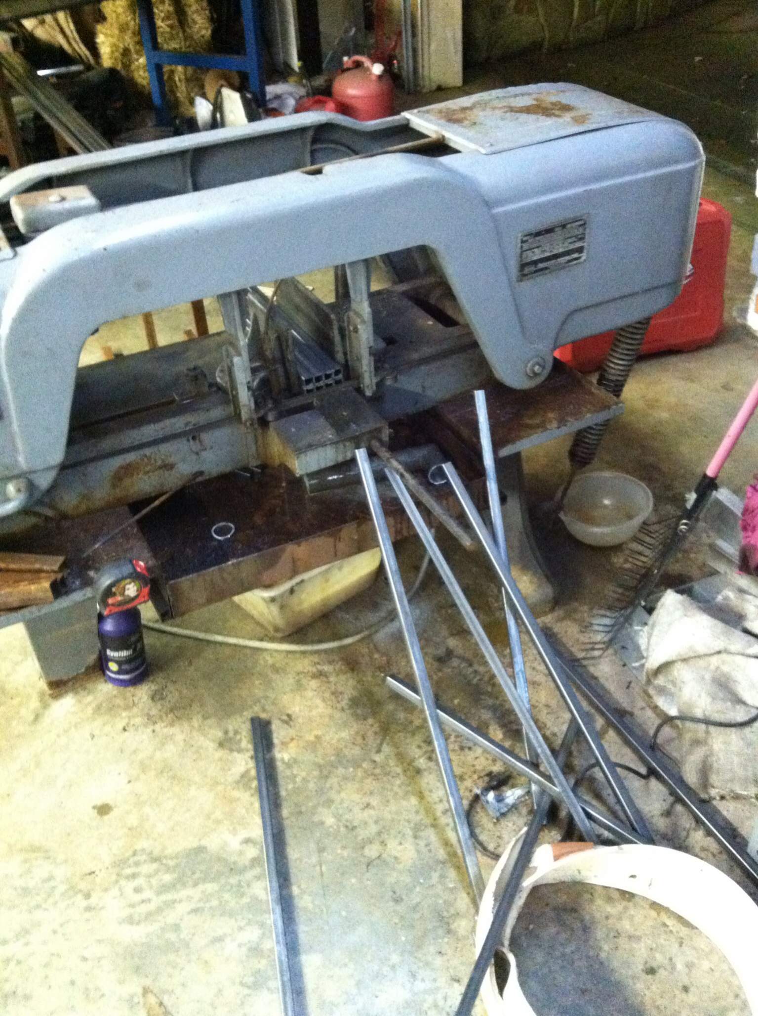

Here's my old kysor Johnson model j I kinked off craigslist fer $300 with, get this, 100' of 10-14 tpi blade to go with it. Glad grandpa taught me to silver solder!

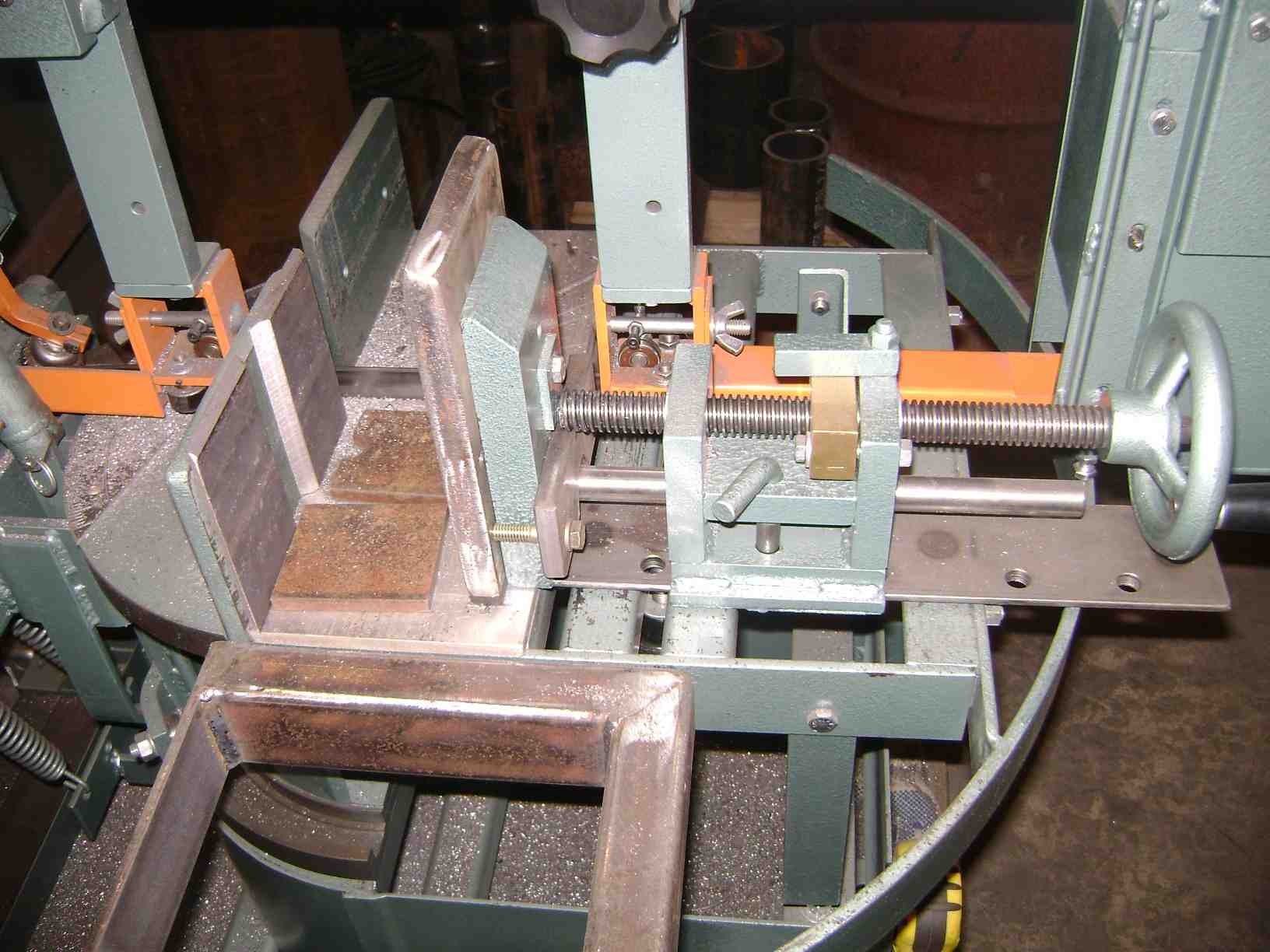

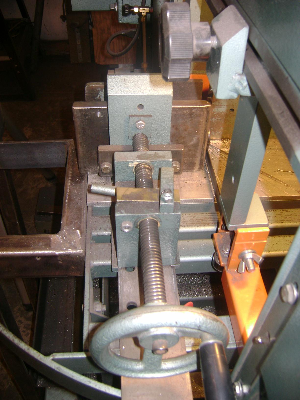

Did your saw come with the cam lock vice, or the screw vice? It didn't take long for me to discover the cam lock vice is a joke! I damaged a $50.00 blade because of that POS!:mad: I ordered the screw vice, nothing has moved since.

I know that cylinder on the left side of the machine is supposed to take some of the head weight off the blade while cutting but mine is just letting the head drop full weight either way I turn the valve. Ellis was nice to put an operation and parts manual on their website. I see there is supposed to be an oil fill plug near the top of the cylinder but I cant find this plug anywhere on mine. I will probably give them a call and ask for their advice on it.
Shield arc that screw vice looks expensive! How much was it? My saw has the cam type. This is my first bandsaw other than a harbor freight 4x6 so there are many things I need to learn about it. I was wondering is the blade supposed to cut into the aluminum bottom plate and if so do you have to replace it every now and then when it gets grooved out in a lot of places from mitering?

Oh gezz,:confused3: seems like it was close to $200.00. My saw cuts into the aluminum saw table just a little bit, maybe 1/16-inch. Yes you can buy a replacement saw table, I think I've seen them for around $50.00. I got a piece of aluminum set aside, I'm just going to make one when the time comes.

thanks I got mine to work. It was completely out of oil. I found out my bandsaw was made in 1983 and although the cylinder does not have a plug like they show in the manual for the newer saws, I was able to unscrew the top cap, remove the seals and just fill it through the top opening. Bled the air out and it works like new!
