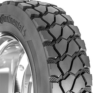

I’ve never seen these.
Anyone try them?

I havent run those. I ran the toyo 608z. I thought they were an ok compromise. I got almost 100k with regroove and they were adequate on mud. I had the 265s. Current 2023 ram 5500 has the oems, and they are horrible off pavement.

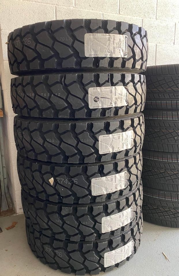

Made in 2922 (August 2022) for 2/3rd price of new. He might come down a little more on the price.
If they wear out quickly enough it probably doesn't matter that they're already two years old.
Larger commercial tires, like 11R24.5s, are generally good for up to 10 years.

They’d prolly last me 2 years. I roll about 12K/year

We switched to those on F550/F600 bucket trucks. Trucks are loaded pretty heavy. Getting about 15,000 miles out of them. Very good offroad traction. Noise not too bad.

Are you using them on the front (steer) axle, too?
Did they have too much vibration of front?
   / I found a legit 19.5” traction tire 450/550 4500/5500 #10
Yes. Able to rotate them with all same pattern. Seems to help extend life and combat any cupping.
No complaints of vibration and didn’t notice any the times I have been a passenger in one of them.
