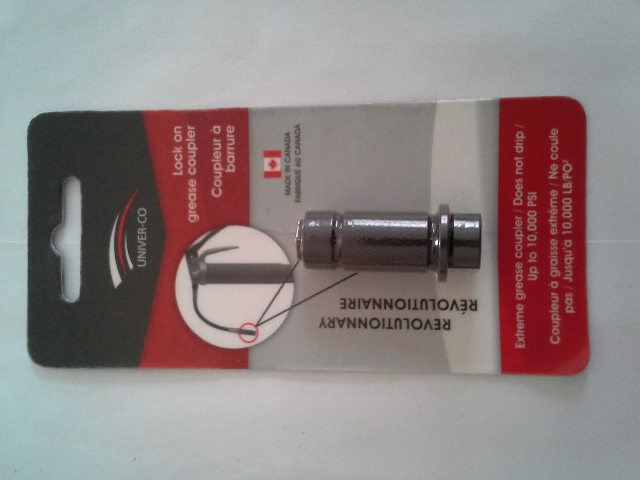

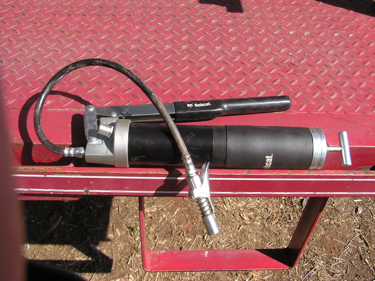

I have read the threads on here and on other forums about the LockNLube coupler and I am skeptical still for the price. After watching this video and actually seeing it, I went an bought one. They have free shipping on Amazon. LockNLube Grease Gun Coupler
The video is on youtube
   / I found a better LockNLube coupler review #2
I have two of them. It's a game changer when it comes to greasing equipment.
   / I found a better LockNLube coupler review #3
It's a game changer on "modern" items that are plastic, where the "old style" (push on and yank off) rips the whole fitting out of the plastic threads. Or even breaks off steel threads. With the old style, theres always one fitting that won't let go, and I skin up my knuckles yanking it off which is a maddening outcome for the simple task of greasing.
I find the lock-n-lube is much cleaner, often doesn't leak at all. Makes the job that much easier, and you don't change grease tubes as often with less waste.

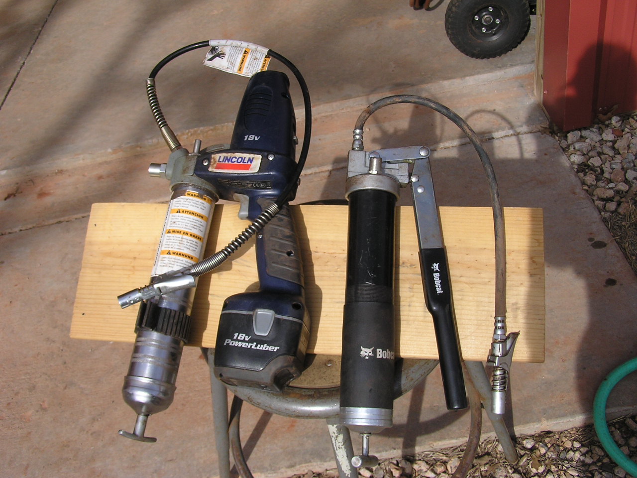

He says it didn't fit the Milwaukee - anybody have more info on that? I have the Milwaukee and was going to get a LockNLube, need to know if it can be made to work. Thanks.
   / I found a better LockNLube coupler review #5
I have one on my 12 volt Milwaukee, standard pipe thread.
   / I found a better LockNLube coupler review #6
Davrow, if your Milwaukie has a 1/8 male pipe thread on the outlet it should fit. Do you have a 1/8 NPT thread fitting (maybe a spare grease fitting) that you can compare to the thread on your Milwaukie?
   / I found a better LockNLube coupler review #7
Thanks murph1, I have the 12v, too. I'll go ahead and get one then. :)
Just an FYI on the Milwaukee from reading more. It seems that some Milwaukee's were sent out with metric fittings "on accident" and that is why it will fit some of the same models and not others. I got this info from talking tot he Lock and Lube owner. I guess he has seen this a lot.
