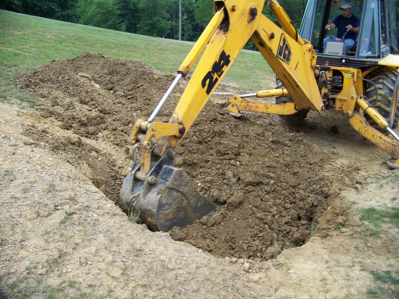

Finally the state approved the funding to repair this suspected mine subsidence related hole that I first talked about in this post;
http://www.tractorbynet.com/forums/rural-living/141129-i-fell-into-hole.html

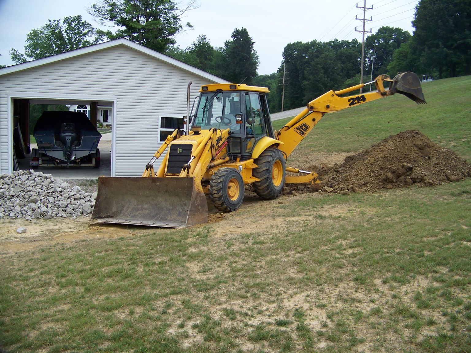

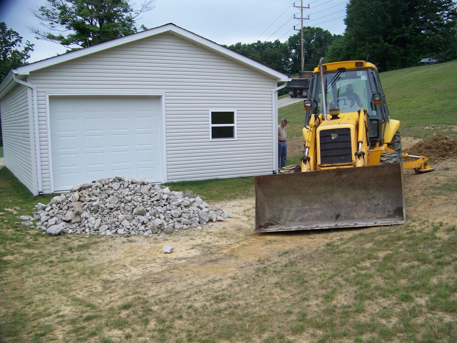

What they did (private contractor working for the state) was to dump the limestone and they began to excavate the hole.

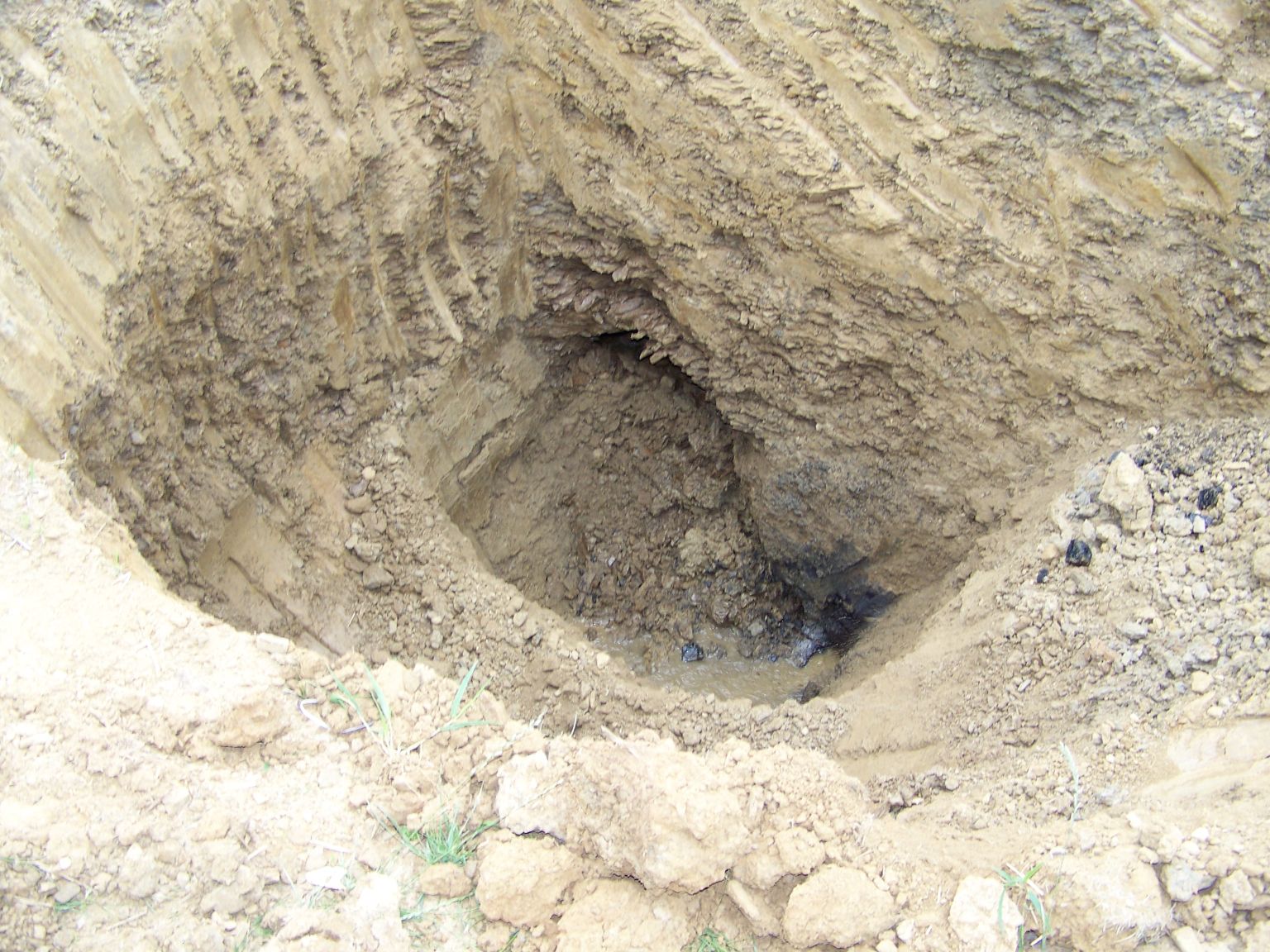

In the last pic, the state inspector noted that he felt that the black material was the beginning of a coal seam.

It the last photo is that a tunnel or something they dug out?
Maybe you should keep the hole and burn coal to stay warm? :D:D:D
Though there does seem to be some water down there...

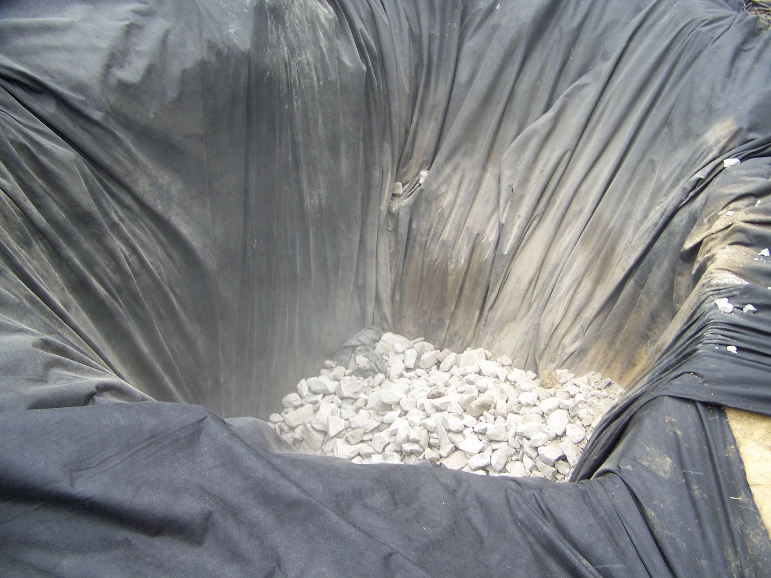

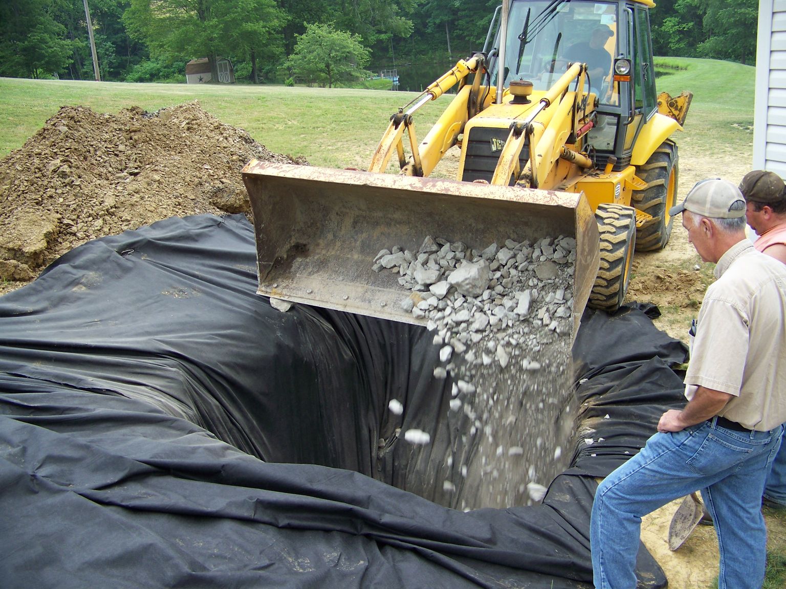

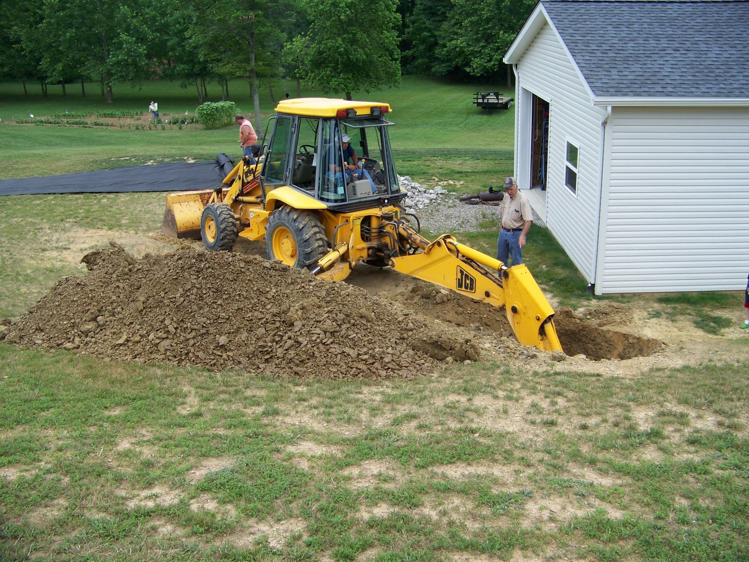

After the hole was opened up, it was determined that there was no threat to my garage. They then lined the hole in a crossed method with fabric and filled with the limestone, effectively making a "plug".
After the fabric and stone was in place, they then backfilled and packed it down.

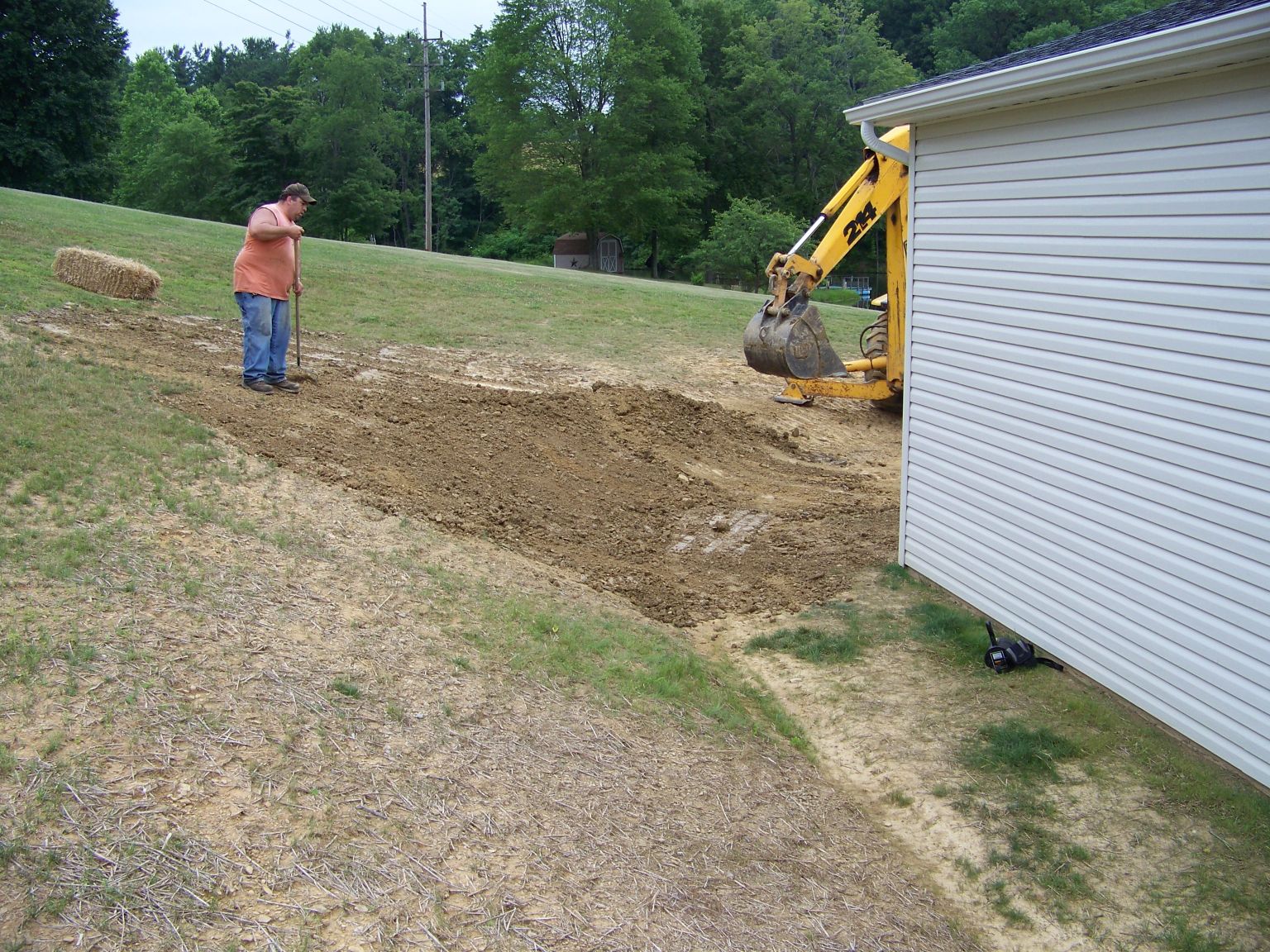

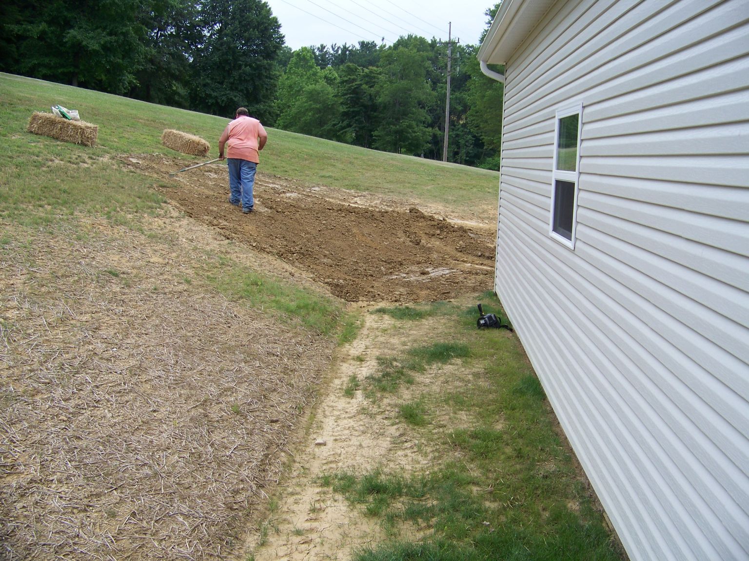

Done. They raked it out and put down seed and straw.
It seems nobody knows for sure what the cause was, however there is a great amount of ground water around here as well as a significant history of coal mining.

How deep is the hole in the last picture with the coal in the bottom?
