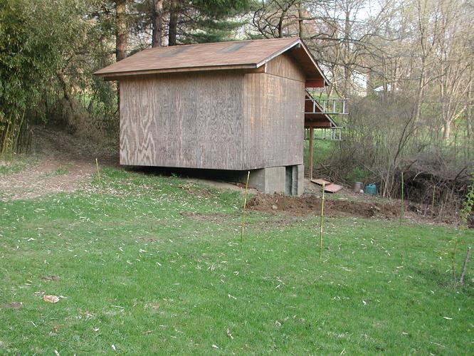

This first shot is the shed just after I scooped out a bucket or two of soil. The shed is 12x12 sitting on top of a 8x12 spring house foundation.

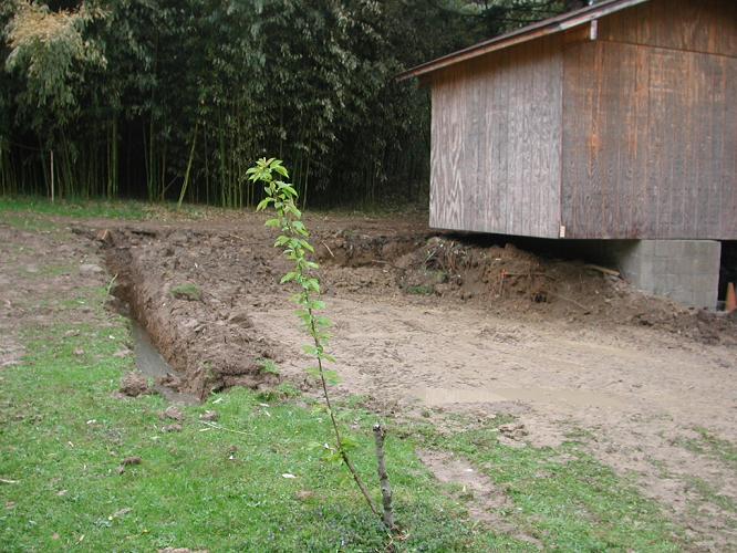

There is a gap in the photo sequence.
Here the outline of the excavation has been dug with my backhoe and some of the earth inside has been removed with my front bucket. Toothbar in place at that time...
Notice the block wall of the foundation is still all there...hint of things to come?

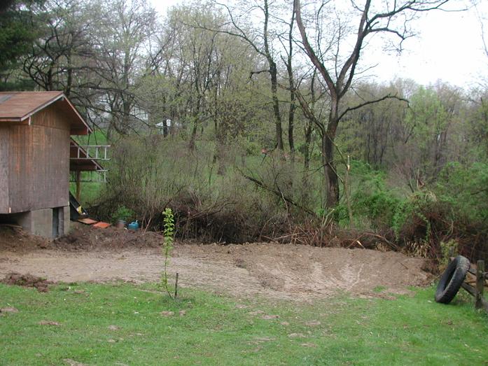

Earth coming out is dumped on the low side to give a flatter area for dropping implements and so on.
Will that little cherry tree survive the ordeal? [so far so good...]

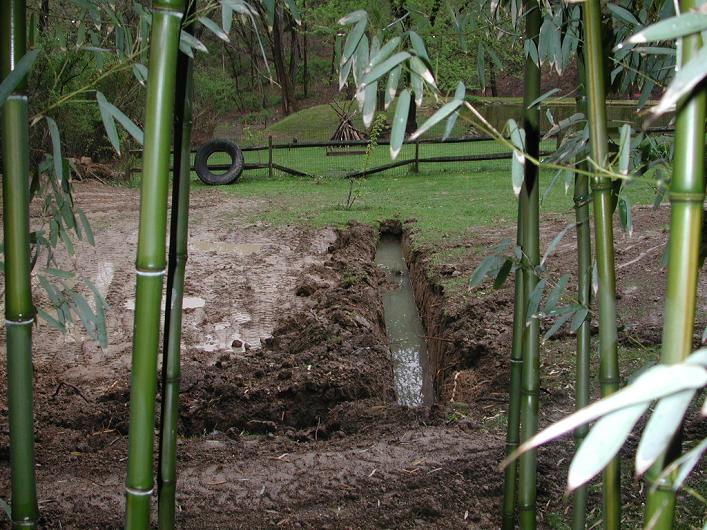

An accurate wate level helps when roughing out the floor level.
Yes, bamboo can grow in Pittsburgh, PA!
Some years ago I had a backhoe guy dig a trench and diverted most of the spring over to my pond, but there is still some water that comes out in the area by the old spring house. That water is what filled the trench. I put drainage in to catch that water and dump it into a little catch basin and send it to my pond as well...

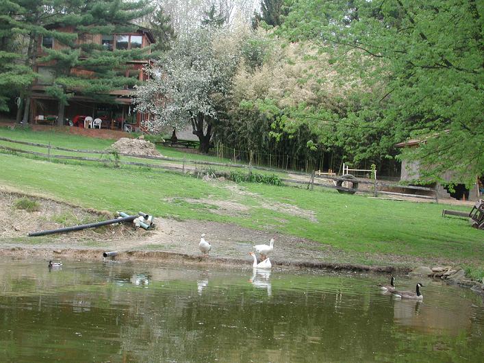

A view from down at the pond...hummm...that block wall looks a little different now! /forums/images/graemlins/blush.gif

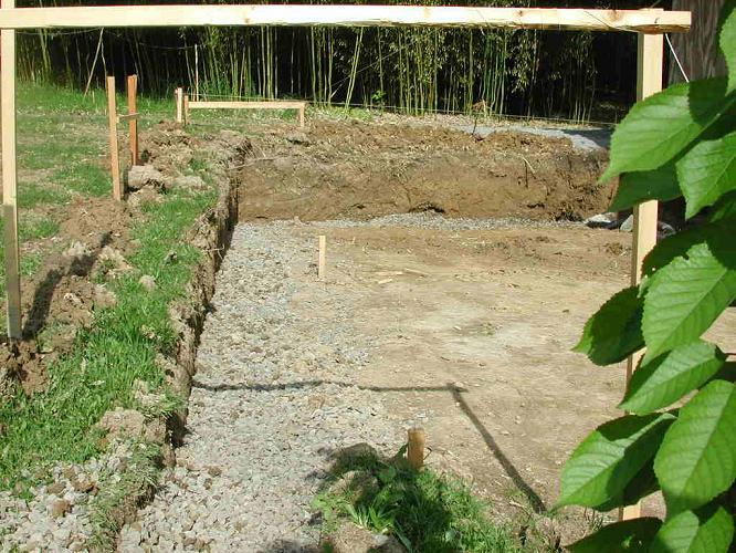

Another gap in the photo sequence. The bottom of the backhoe trench has a drainage pipe in it and I have backfilled with some crushed stone.
Posts will be planted and a "floating" wood wall will hold back the earth and crushed stone for drainage...
It was a major pain laying out the new to align with the old shed, by the way. Especially when I found what I consider an error in one of my tape measures that put my measurements off by a foot! So I had to do it twice!
By the way, I did not discover that until after I dug the ditch this photo is looking down...so I had an extra foot of width to walk in on this side...

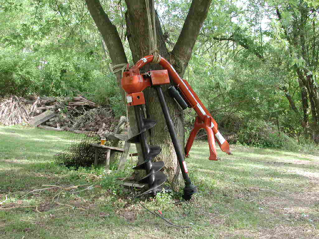

Let me introduce you to one of my new friends and helpers.
Can't imagine how I ever lived without one of these! Manually removing dirt from the bottom of holes is such a pleasure. Man, I'm grinning ear to ear as I use that manual post hole digger for final clean out of the holes!

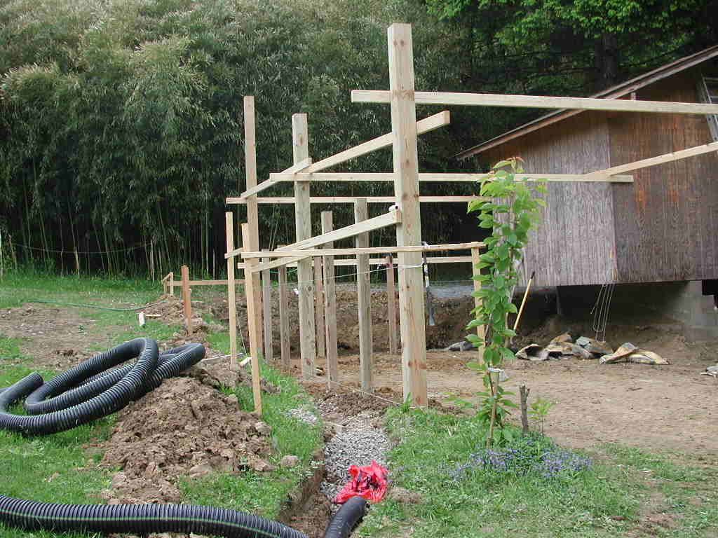

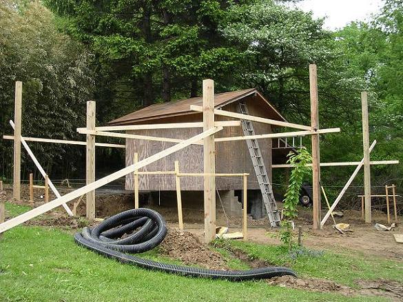

The main posts went up in one day of me working by myself.
I believe that if there were two of us it would have taken only three hours. But there wa only me...
First post I used the loader to help raise. 16' 6x6. Then I realized that on that side I just needed 12' poles. Went and got two of them and raised them by hand. Then decided that I probably could raise the 16' ones by hand too...they were heavy but doable.
Finally got to the camera at the end of the day. I set the posts on a 12 inch stepping stone at the bottom of a 14 inch hole. Then used two 80 lb bags of high early strength concrete per post, followed by earth well tamped...
