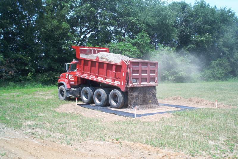

Started our mini-barn project last night. No where near the scale of Henro or Spencer but it will be a nice place to tuck away the lawn tractor, gardening tools and kids toys. Big barn for the "big" tractor, camper and such is still a couple of years away.
Last night I scraped away the vegetation and some topsoil. Today I had some crushed concrete delivered and leveled it into a pad for the barn to rest on. It will be conventional stick framing with a wood floor. Hope to have it all framed in by the end of the weekend.
Here's my solution to the dump trailer situation...

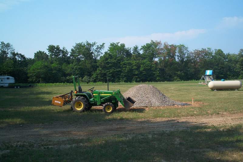

And here's my trusty little 790 next to 10 yards of crushed concrete. I was a bit intimidated at first but the stuff is really loose and works easily with the bucket or box /forums/images/graemlins/smile.gif

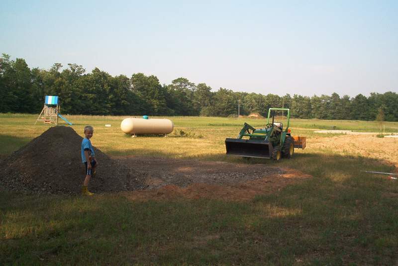

And the final installment for today... My 9 year old helper standing next to what's left of the pile. I leveled a pad about 8" thick for the barn and some extra space behind it for implement storage. I knew I'd have extra crush and that's just fine. Most of the cost is in the delivery so I got all they could carry. The leftovers will get used for driveway repairs, ramp up to the barn floor and various other things.
Tomorrow night I rent a plate compactor to make this really solid. Lumber arrives Friday so I'm all set for the weekend /forums/images/graemlins/smile.gif

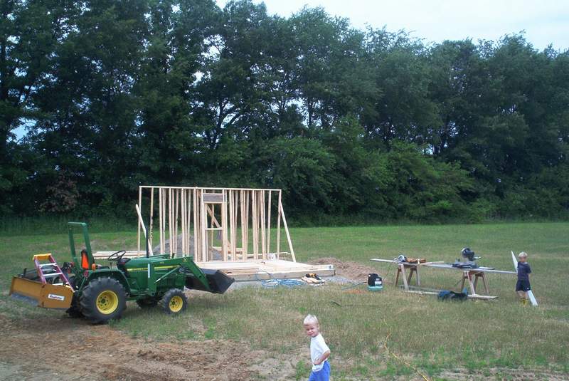

Well, the framing has begun. Not much time for pictures plus the batteries were going down. I've got all three helpers here, two boys and one tractor /forums/images/graemlins/smile.gif

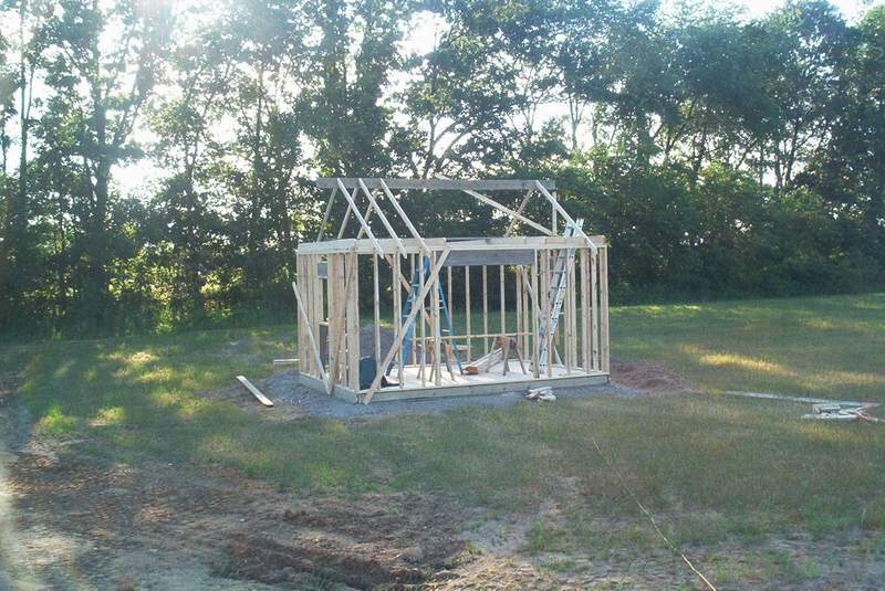

Walls framed, started the roof. Setting the ridge beam was a challenge, particularly as no one else was home at that time. I figured a way to do it and kept the progress going /forums/images/graemlins/smile.gif

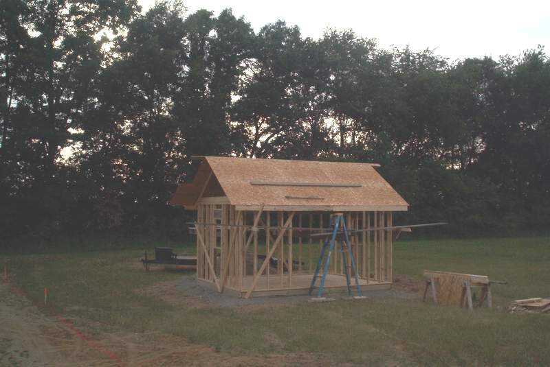

And my final installment for this weekend. Ended up about where I thought I would. Nearly all the framing is done. Just need to trim off the roof sheathing and add the flyrafters. Shingling is next but that will have to wait a week or two /forums/images/graemlins/smile.gif
