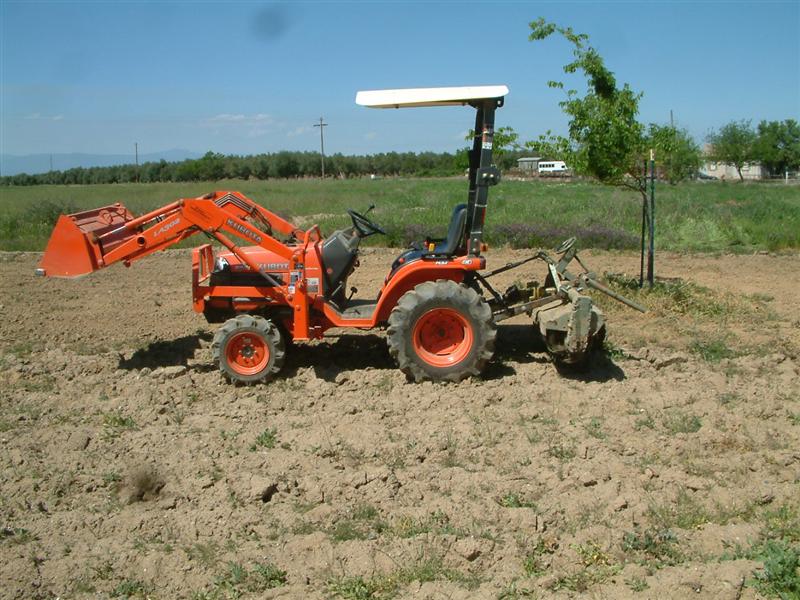

I have a 21-hp engine Kubota B7510HST with the LA302 FEL (4-ft wide bucket). Bought it new in May05 for $12600 plus tax (10% down, 0% for 36 months). I have 10 acres of flat pasture land. Use the 7510 and a 4-ft wide KK brush hog to mow the weeds. Takes about 8 hours to cut 7-8 acres.
It weighs less than 2000 lb, so it's easily hauled with my F150 and a twin axle trailer on a standard receiver-type trailer hitch.

flusher, that looks perfect for food plots!
