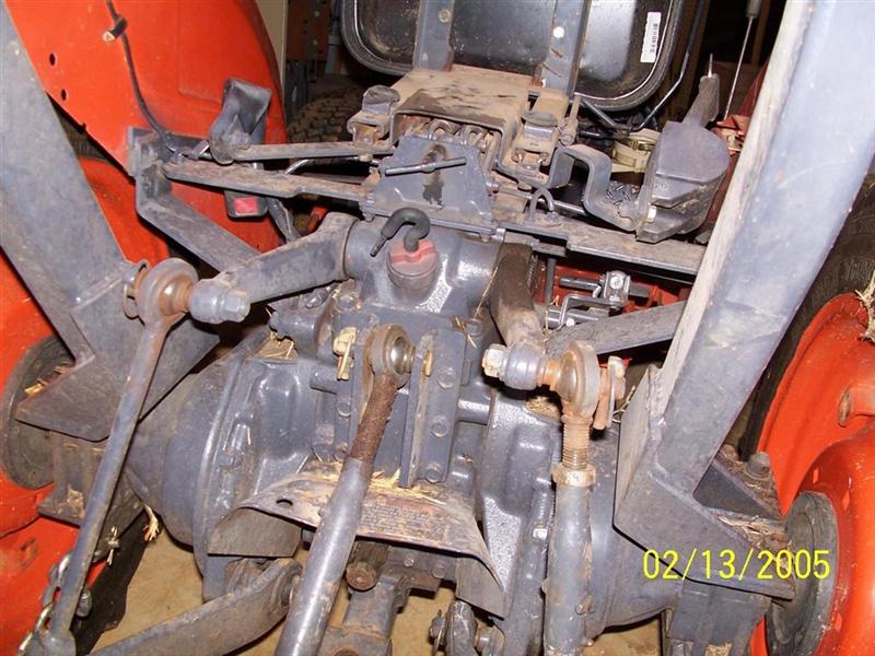

Follow-up. Yes it is a bad crack, not hairline. Crack is between both top bolt holes and extends one onch or so on both sides. Bad enough that top bolts won't tighten and material may have fallen inside housing so I am not moving it till I know more. It is cast iron, but I don't think I'll try to have it welded. So we are down to DIY or dealer. Have studied parts breakdown and can't tell if it is something I can do. On the surface it looks easy. Remove wheel, remove and reinstall housing and wheel. What I can't tell is degree of diffuculty with seals and how axel connects to drive line. Any ideas appreciated.
/ I Broke It $ $ $ 3400 HST #15
On my L the ROPS sort of clamps onto the axle housing. But I looked up the p/N on mine. About $300 and the replacement doesn't look that bad. The hardest thing looks to be removing the rops and wheel. Perhaps the fender to get some more work room.
Good Luck,
Rob

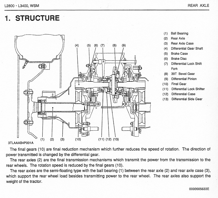

That's the million dollar question..."can I do it?"
How much wrenching experience do you have? Have a ever done major engine repairs (rebuild, head gaskets, valves)? Have you done a brake job before (drum brakes...cylinders and springs and all)? If you have then I would definitely give it a shot. A manual may help but not always. I have a copy of the Kubota L2800/L3400 workshop manual and I can scan pages if you need. From reading the rear axle section, it looks like something you can accomplish in your garage. Looks like you may need a puller. Otherwise it looks pretty straight forward. I would also ask a mechanically inclined friend to lend a hand. I'll scan a diagram when I get a chance. And if you need help you always have TBN friends who can lend a hand over the net. Good luck!
/ I Broke It $ $ $ 3400 HST #17
Here's a diagram of the rear axle from the manual...

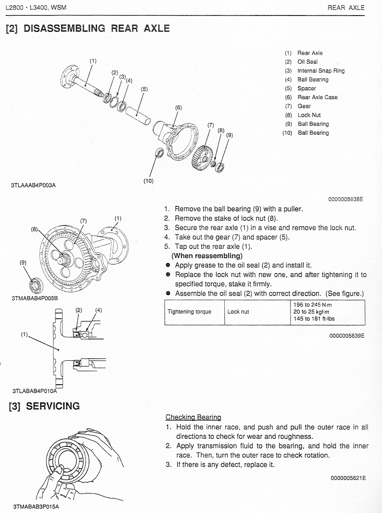

/ I Broke It $ $ $ 3400 HST #18
And one more...

I agree, and even though I use to do this for a living I would not call this a major repair. Some heavy stuff, expensive, but it's still a slow moving part unlike a high revving engine. A major part but not a complicated one IMO.
Just guessing about $500 in labor mininum if you went to a dealer.
Be sure to take some pics and post if you go forward.
Good Luck,
rob
