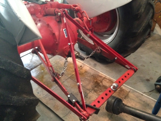

First thank you to all who have made suggestions regarding a tractor capable of pulling and stopping my manlift.
I've purchased a Kubota L3010 and it pulls the lift without even noticing it's there. Now I need advice on my method of moving the lift. I'm trying to connect the lift to the tractor using the 3pt. This works really well, except when I start moving the lift the ball "tilts" back and forth. See attached. Is there some special "connector" for this task? Or how do I keep the red bar from rotating? I know I'm showing my ignorance, but i figure it's better than doing something really wrong.
Thanks

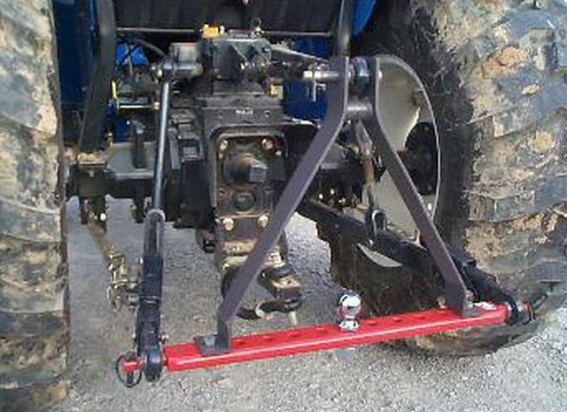

   / I bought one --- #2
Something like this will do the job.... I actually made one similar to this...
Or something a little more exotic....

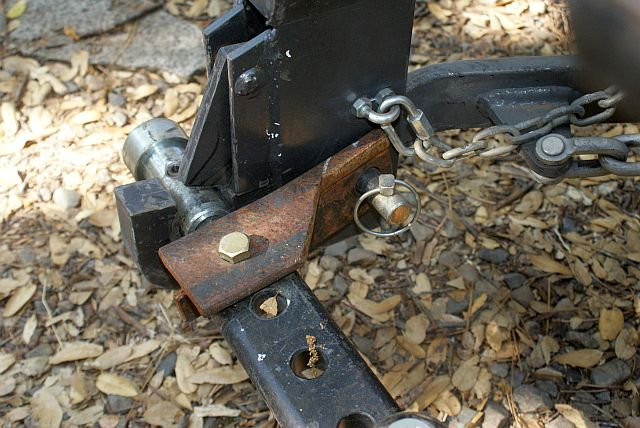

Home brew... Just a section of 2x2x1/4 angle iron (comes off with drawbar) ...
