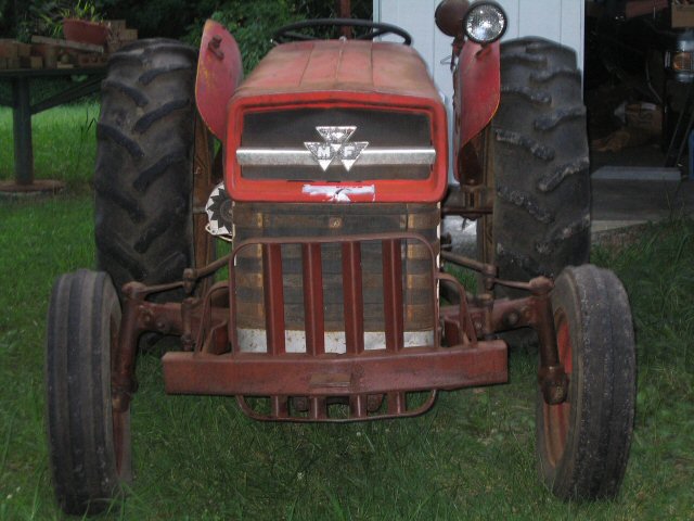

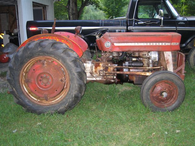

I bought one at auction for $2300. It is a diesel MF 135. It needs new tires in front, and I am thinking of getting turf tires for the rear. I will use it for mowing and some augering for fence posts. If anyone has any model specific information please spill the beans. /forums/images/graemlins/grin.gif /forums/images/graemlins/grin.gif The current rear tires are slightly mismatched (they have some funny twisted metal things on the wheels too??) It doesn't have power steering /forums/images/graemlins/frown.gif If I can afford adding it later I will, right now I am going to concentrate on fixing it up. I found out yesterday the hydraulic oil has water in it, so I will flush and fill it soon. Pressure plate in transmission was replaced recently. The steering has lots of play in it. Who has the best repair or factory manual on these old tractors?

Here are some pics

Does Wally world carry this PermatranIII? How much would a gallon cost? How many do you think I need? Is it worth the money verses Walmarts tractor lube?
