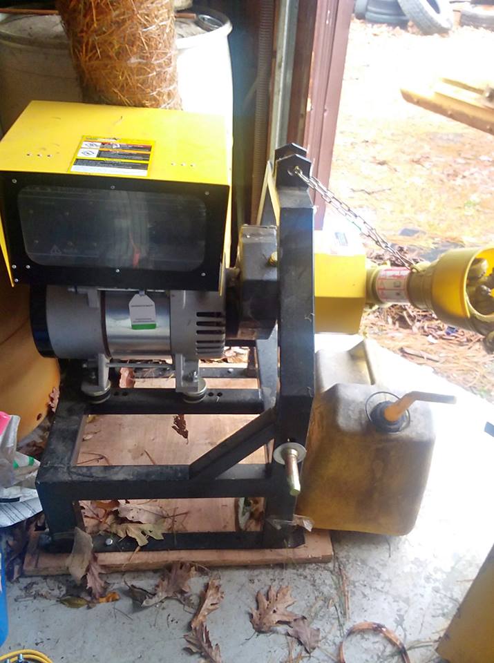

I bought a 15K PTO generator. It was used and it had 1 hour run time on it.
   / I bought a 15K PTO generator. It was used and it had 1 hour run time on it. #1
Gofast
Gold Member
Mar 10, 2013
371
Greenville SC
MF GC 1725, 2016 MF GC 1710, Belarus 300
I will be using the 50-amp 12K plug that is about right for my tractor.
I should be able to run my welder off this.
I have been looking for a while and I finally was able to pick one up.
I have a 5K gas generator. I will tune it up and sell it. I will be nice not maintaining another gas engine.
I wounder what the run time will be on a tank of fuel.

I made an offer on it Feb 2 they said they would just let is sit there and not sell it for that. I sent message back saying if you change your mind just let me know.
Today I got a message so I was able to get it for $700.

You probably have already but if not check your gearbox oil SAE 90 . First change after break in period i think is 25 hrs .
That is first on the list to change the gear lube. It only has had one hour on it but that lube has to be old so I will just change it.
   / I bought a 15K PTO generator. It was used and it had 1 hour run time on it. #8
Does unused "lube" deteriorate while just sitting?
#9
The manual says change 25 hours then every 250 hours or every 6 months.
I just want to start with known good lube and moisture could be in there from sitting so long. I don't know that SAE 90 is in there now.
I would not think it would go bad. Think how long gear lube sits in a trucks rear end and still works fine.

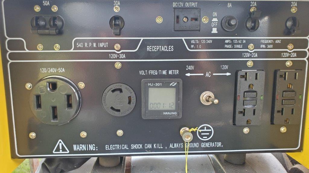

One thing I noticed in the pict. is, there's a toggle switch to go from 120V to 240V. Is that right?
I wouldn't like that at all, as when I'm welding, (240v) I like to be able to pick up my side grinder and use it. (120v) AND, if I have some help I may have them grinding as I weld. Also I may have lights also hooked to the gen set and they are 120v too. I wouldn't want to have to be switching back and forth between voltages...
There's no switch on mine, you can use any or all of it at the same time.
