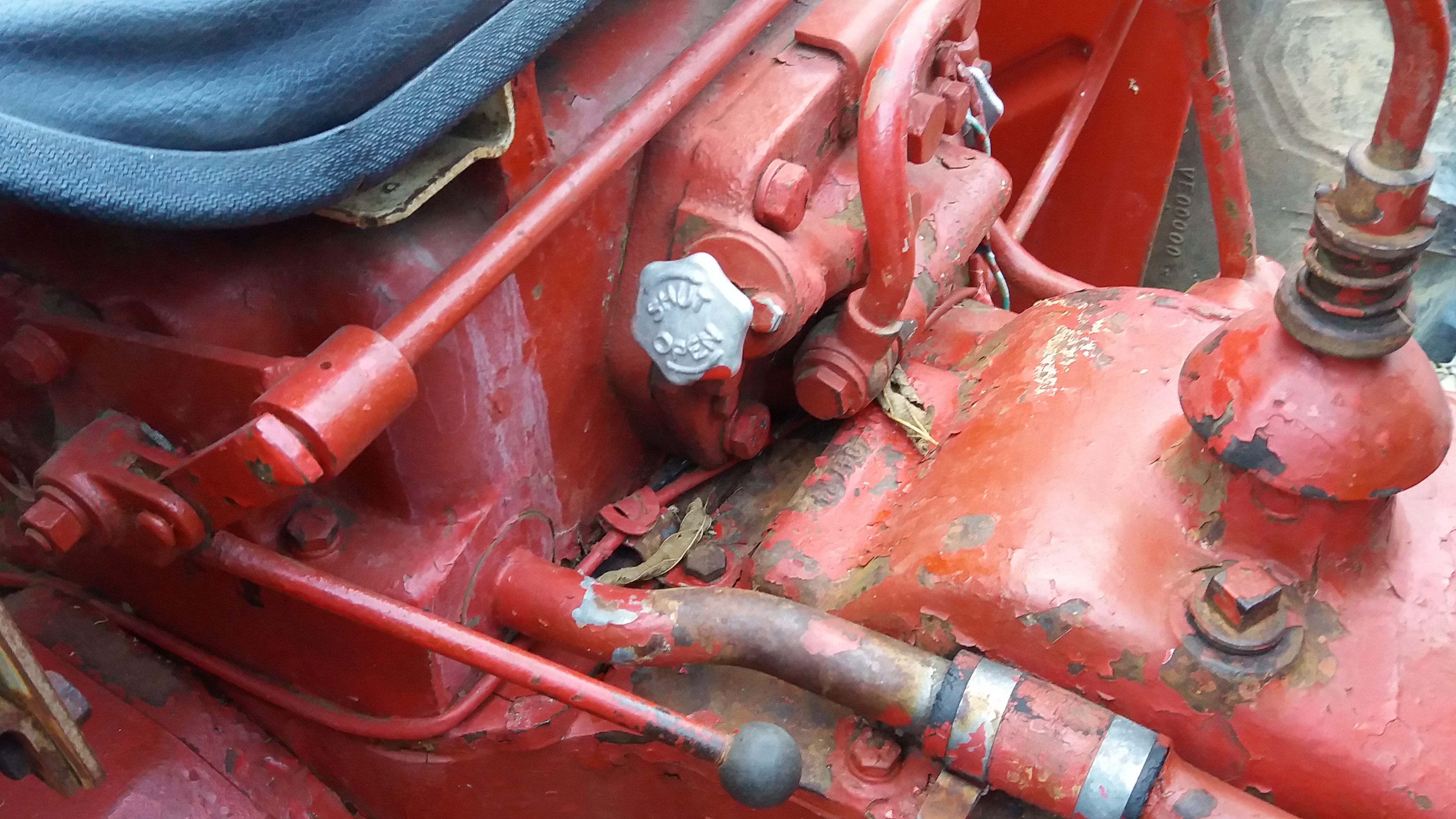

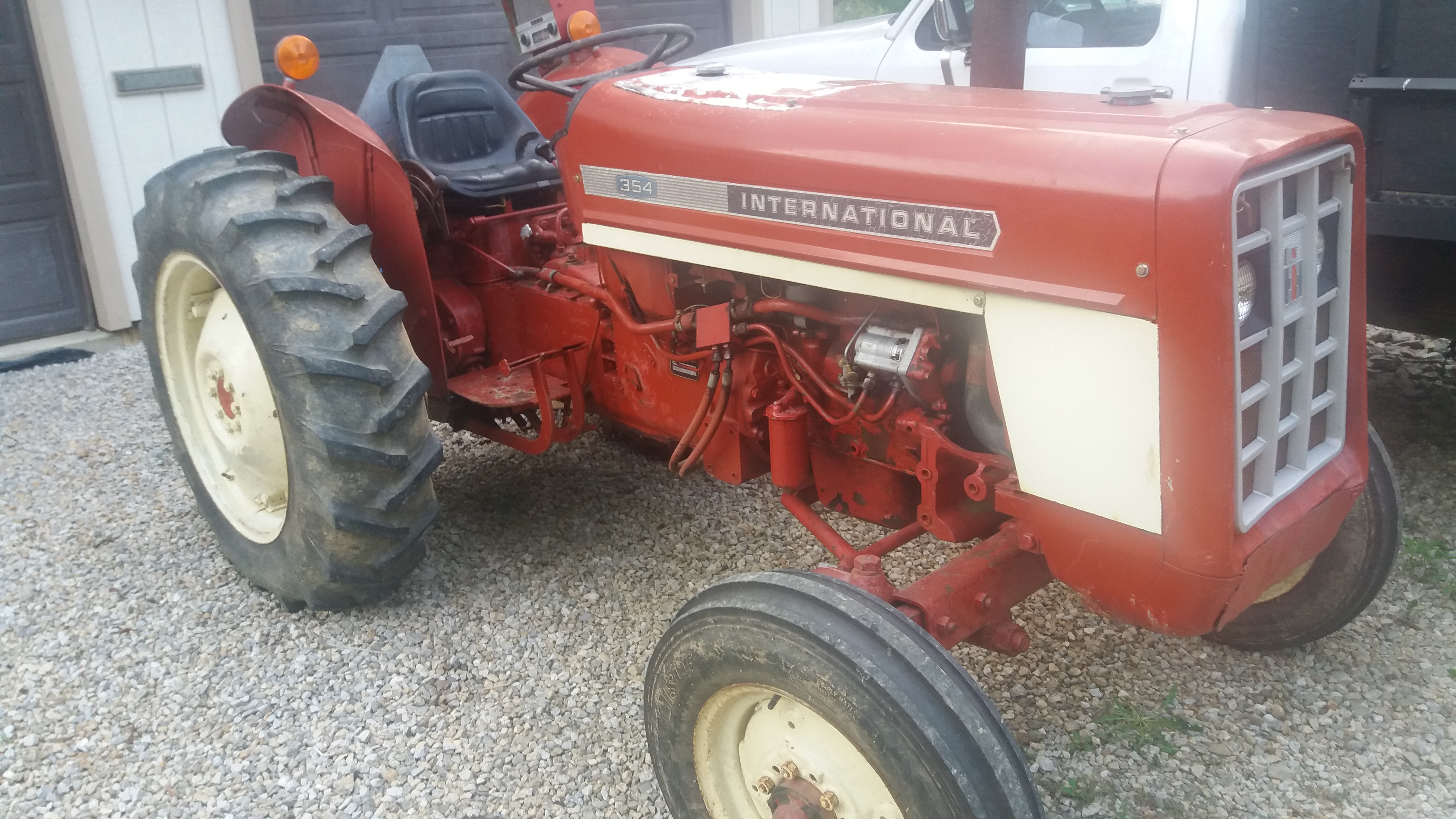

Ive purchased my first tractor this week, a International 354 gas. 20170830_192912.jpg There is a few things i dont know what they do . Plus whats a good manual to buy?
1. What are these Silver knobs for and how the heck are you suppose to turn them? They seem really tight.

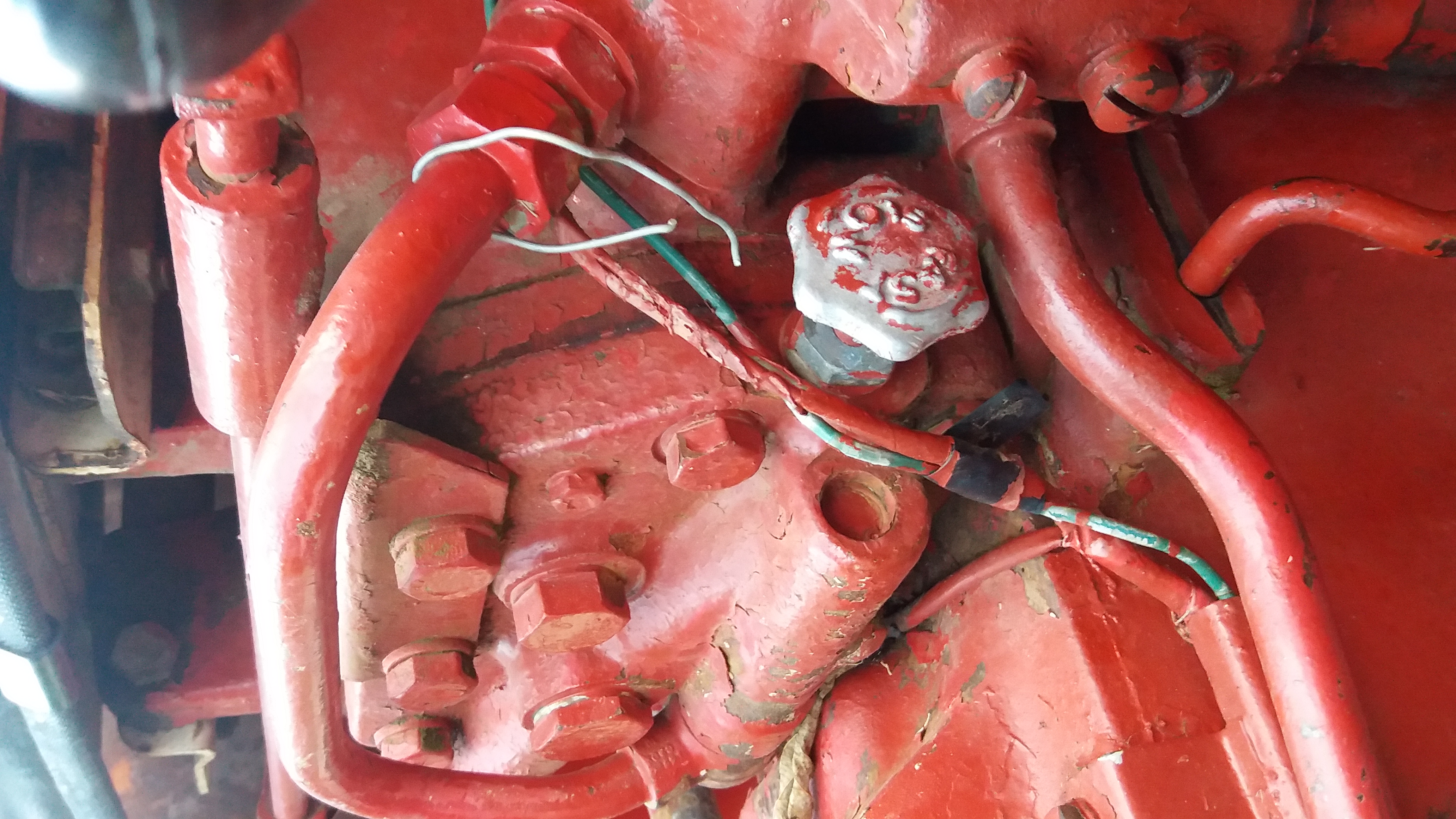

Opens/closes hydraulic blocks. Chances are they're open if there's lines connected to them, and closed if not. Normal operation you should not need to touch them.

Hydraulic lines from the pump can't just be shut off. You need to always have flow, one way or another. Look at your second picture. Those really big bolts are most likely hydraulic hookup's in the block. If you were to connect them to something, nothing would happen because the valve is in the closed position, meaning the high pressure line that goes into it goes back to the resivour insteadd of the ports. If you open it, those ports will be active, so fluid will flow out one of them and back in, then back to the resivour.

Port side silver knob controls how fast the 3pt hitch lowers down. You can see where it says "SLOW" and "FAST".
Starboard side opens and closes hydraulic flow to that block under the seat. I can't see for sure what that block does. Can you get a picture of that block and where the hydraulic lines from it go?

I wasnt able to turn either knob. is that normal ? is there a sequence to run to make them turn?
   / i bet this is a simple question for someone #9
It's normal, it likely never got turned from the day it rolled off the factory. I have a few like that as well, it's just stuck.
