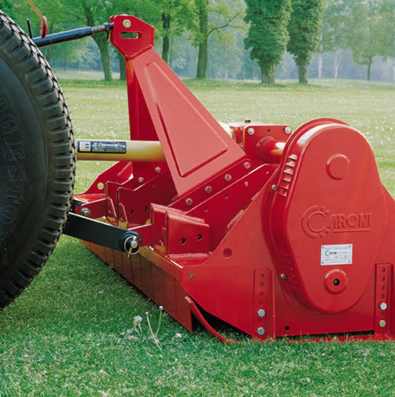

This weekend I hooked up my first PTO attachment. It's a Caroni TL1500 flail mower.
It took some time to get it hooked up since I had to remove 4 inches from the PTO shafts. The hardest thing was getting the shaft connected at both ends. I dread trying to remove it (and connecting it again)! Finally after lifting, lowering, lengthening the center link I heard the 'clicks' that locked the shaft on the mower, then the tractor.
Now it was time to mow! Everything was going great. The top link was floating in the upper slot and I was raising/lowering the mower as needed, although I did bottom out several times. No big deal since its just an open meadow and not a manicured lawn.
A few times I needed to back into an area to mow and I sometimes did that with the mower down. When I was done for the day I looked at things in the back of the tractor and saw that the center link was no longer floating. All of the weight was resting on the center link and it was bent!:ashamed:

Maybe there wasn't enough grease in the slot and it got stuck in that position or the pin is the wrong size. Does anyone have any input on how to prevent this from happening again?

It bottomed out in the slot pretty hard and bent the toplink. That usually happens while backing up a hill with the 3 point hitch too low. Some sort of chain or a longer slot would stop that from happening again. Ken Sweet
   / I Bent The Shaft On My Center Link #3
It also happens when the toplink is too short. In this case, you had to extend the weakest part of the toplink to achieve your desired cutting height. If that's the height at which you intend to do a majority of your mowing, I suggest buying the next longer toplink. Cat 1 toplinks are available anywhere between about 13" and 30". Then pin it in the top hole on the mower. Don't use that slot.
And your bent one isn't a total loss, you can buy replacement threaded link ends. But be careful, opposite ends are threaded differently. Make sure you get one to replace the bent end - not the straight end.
//greg//

Your toplink yoke is installed upside down. I'm not sure why they don't stagger the holes or something so it would only fit one way but they don't.
(from Caroni site)
If you flip it over, the slot with be horizontal & shouldn't bind up as readily.

You clearly have never used a flail mower. Cutting height is set by lengthening or shortening the toplink. I haven't met anyone yet who's had any success in pushing a chain.

Top Links are sold at your dealer and Tractor Supply. They aren't too expensive ($30-$40).
As greg_g wrote, the threads are opposite (one right hand, the other a left hand thread), like a turnbuckle.
If dennis33 had his extended too far out, and that caused the bending, I suggest he buy a longer link.
