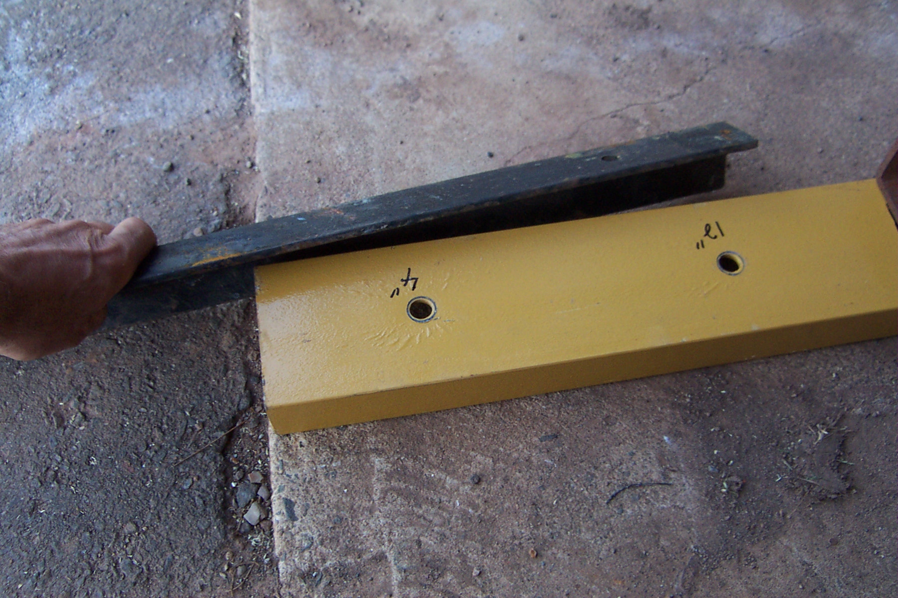

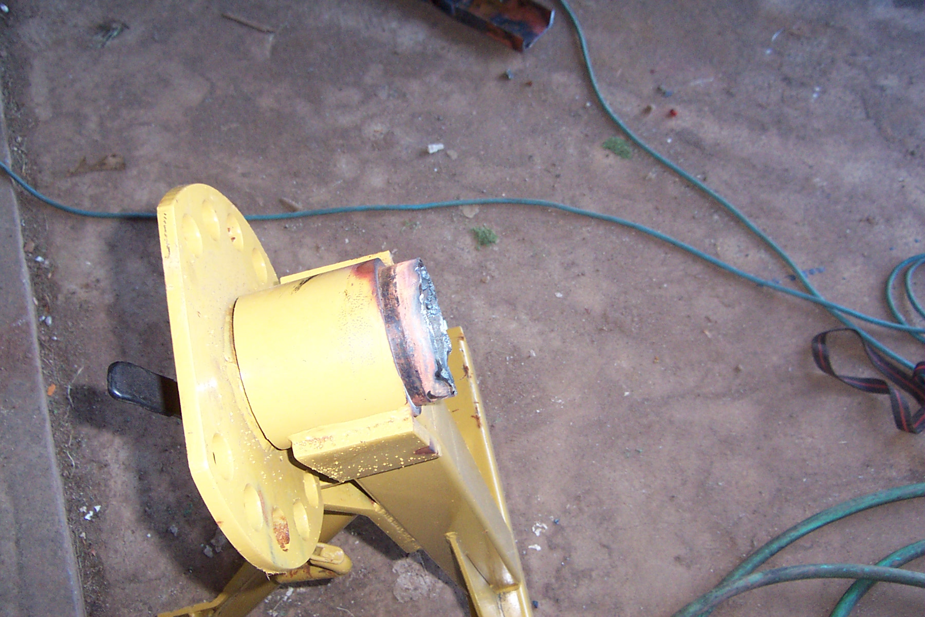

I was going to straighten my rake, but after reading about rakes bending on this forum, I decided to fix it permanently.
So if you buy a new rake or if you have an unbent rake i would beef it up now, because it will 10x easier than fixing it later and you'll have a rake that lasts for years without spending big dollars.
I would use angle heavy angle and reinforce the pivot area. Like in the first picture.
I had to cut out my bent piece and install box metal. 2nd and 3rd pic.

You cannot straighten a piece of twisted channel in a reasonable amount of time and effort. That is why I cut it out and installed a heavy piece of rectangle stock that resists twisting.
Like I said before, If you currently own a county line rake and it is not bent, then reinforcing it with heavy angle would be easy now, than fixing a twisted channel.
