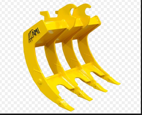

I don't have a need for a full pledged Grapple. I do have branches/brush when I trim trees and clean the fence line. I just take these and load the either in a dump golf cart or a 16' trailer.
I can use my new 16" bucket or my pallet forks. To do this job.

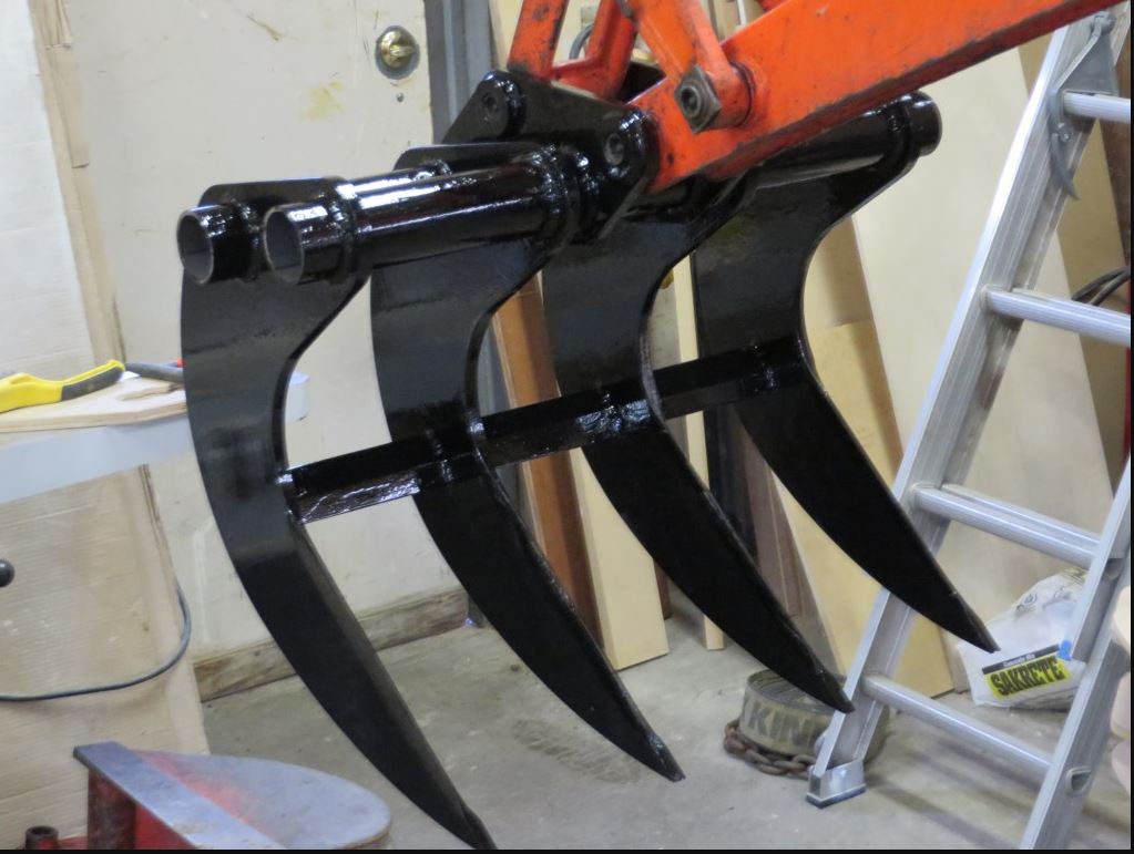

The other option I am considering is making a backhoe rake or mini grapple. I would make maybe 24"-30" (I have BxPanded thumb)
I have a QC on my backhoe so switching out is no issue.
And maybe similar to one of these.
old cheddar made this.
https://www.tractorbynet.com/forums/build-yourself/371409-backhoe-rake-fiinished.html
I would buy surplus steel and fab and weld this myself. I have the steel for the brackets already left over for my other projects.
The cost would be low.
Does anyone have something like this? Do you think this attachment would be more useful than just a bucket?

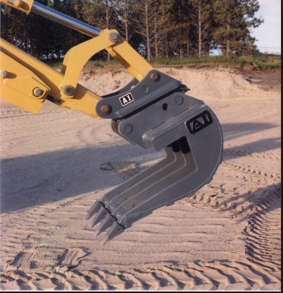

   / I am considering making a backhoe rake. #2
Hey Gofast,
It seems like that will work by pinching the brush against the dipper tube steel.
I build a set of 5, brush forks out of 1"x3"x1/8" tube steel that sits inside the front bucket and bolts to the sides of the bucket. I think all 5 forks extends pass the bucket about 30". It's welded up as one piece, easy to install/uninstall. This works for me and I also cover the top of the brush forks with 3/4" plywood and use the platform to haul firewood.
I also built another set, but they only extend out the front of the bucket about 4" and I use them for bucket teeth.
Whatever you end up making, I think will work fine for you.

   / I am considering making a backhoe rake. #5
That is a cool looking rake,, and it is possible it will work,,, BUT,,,
I just have not seen one before,, being used, or for sale.
If it was a great tool,, wouldn't there be a dozen of them for sale on Amazon,, and eBay?
(There may be a bunch for sale,, I did not look,,,)
The rake may be a buggy whip,,
   / I am considering making a backhoe rake. #6
I thought I have seen this as a tool for lifting slabs of concrete,, :confused:
