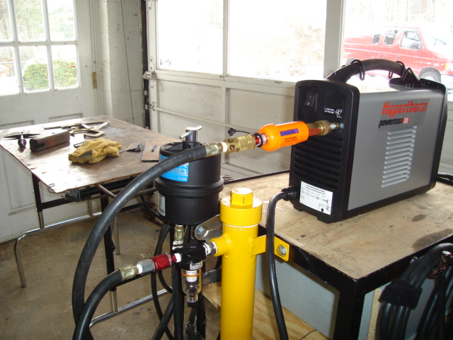

The fitting is connected to the Internal filter. I did not like the way it moved either. so took the cover off the unit and reinforced the air filter Just to be safe. Here is what I use to filter air Everything is connected to the cart so it is dedicated to the Plasma cutter. Maybe a little over kill.

That little filter connected to the cutter has a little window so I could see the pellets .If they change colors than moisture is passing the other 2. I do not think that will happen ,But you never know. It is a Motorguard sold in pairs.The black filter is a Motorguard Paper filter And the yellow pipe is a Dessicant filter that I got from HF. When I mounted all of the filters I used High Flow Fittings Just to make sure I had Volume as well as Pressure.Some good advice over at Welding web and Hobart weld talk. But for Hypertherm None better than Jim Colt. He Monitors almost all of those Forums as well as this one This is also my first Plasma cutter One of the best tools that I own.I use it to cut everything .I just plug it in and hook up air . My torches are only used to Heat and bend now. Great piece of equipment Good luck with it
