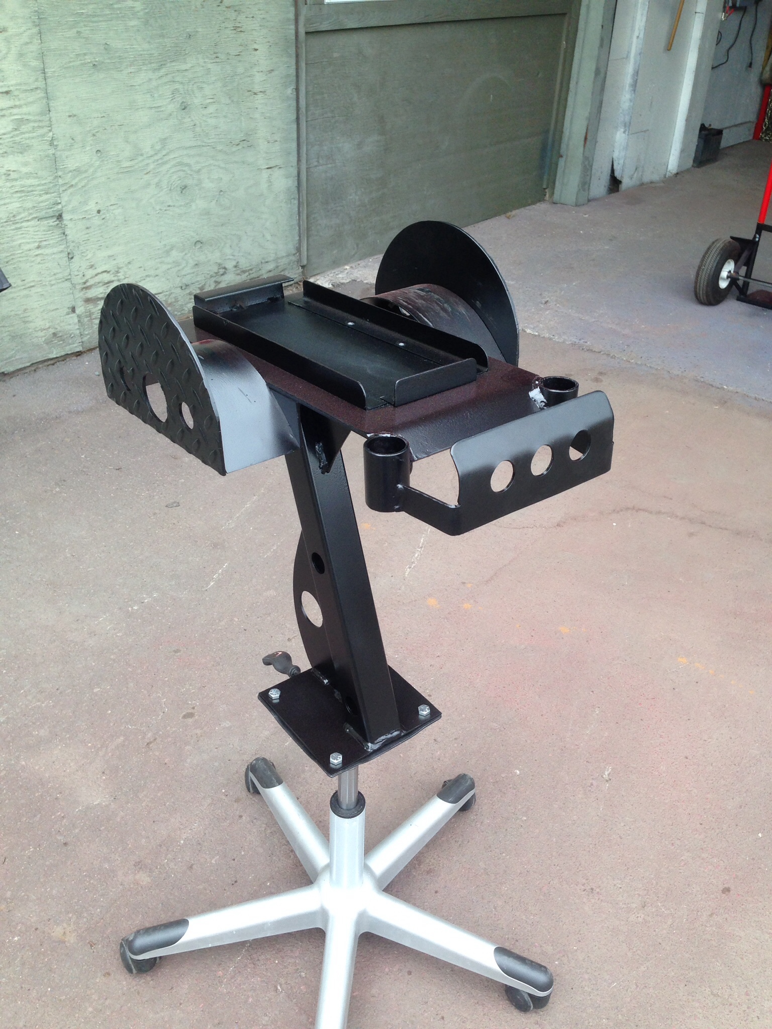

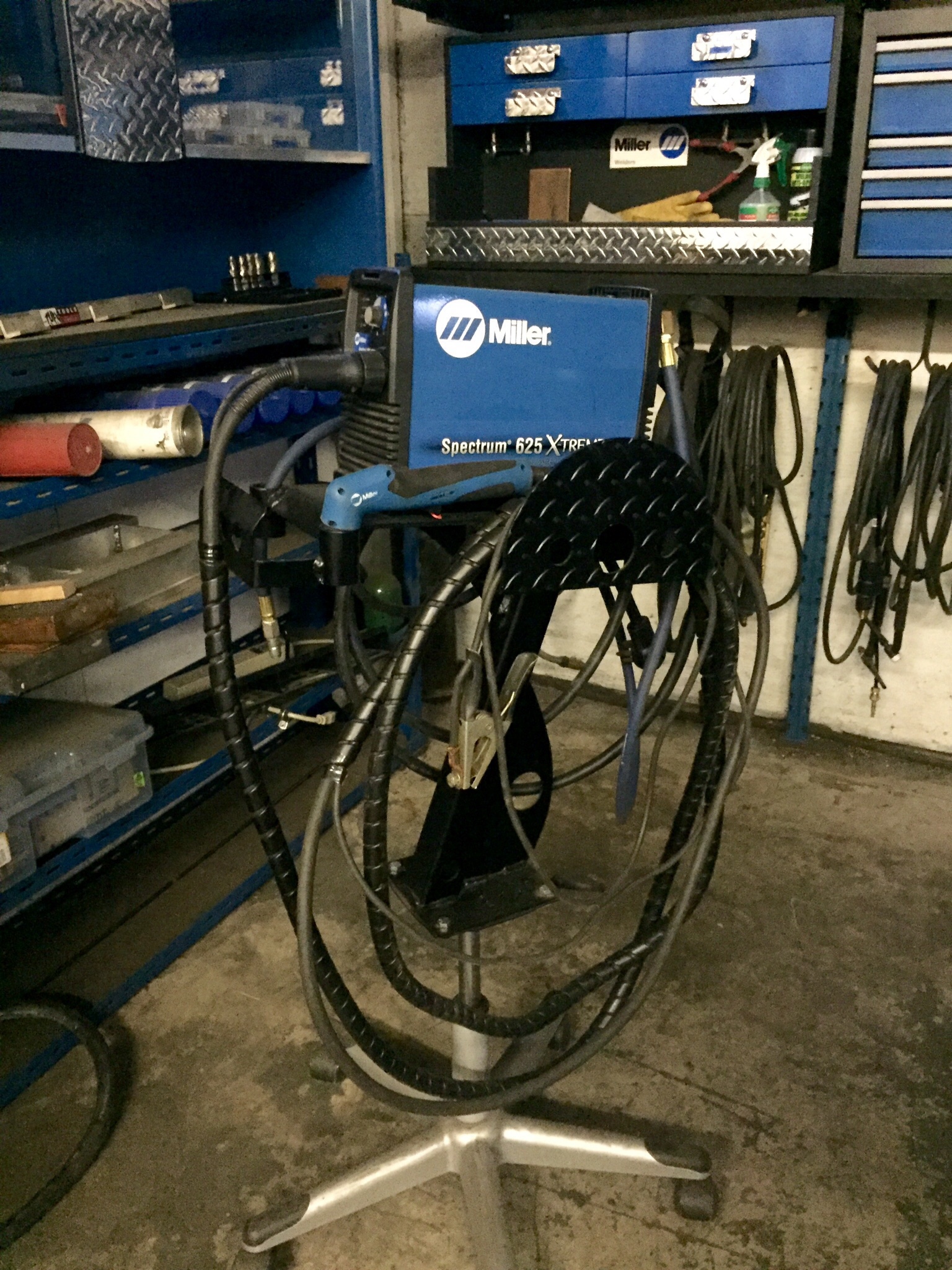

With 50 feet of torch you might want to protect your cables.
I used spiral hydraulic cable wrap for mine. Torch AND 6 gauge work cable in the same enclosure.
Terry
   / Hypertherm 45XP question.
Terry
I was out in the shop earlier with the torch and ground leads stretched out and thought I need to cover the leads. I never thought of hydraulic hose covering though. Good idea. I also decided I'd rather have it on a cart.
   / Hypertherm 45XP question. #8

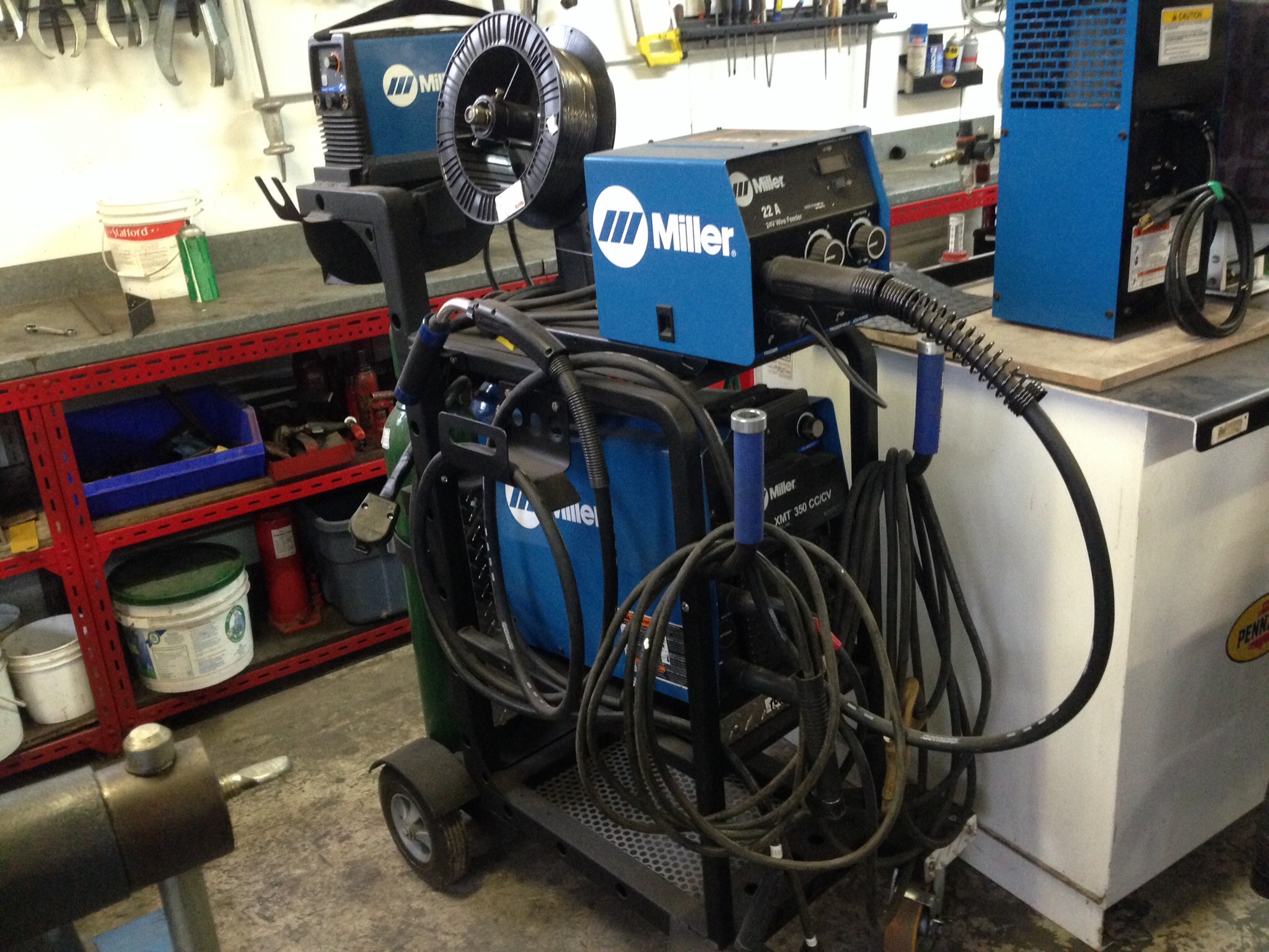

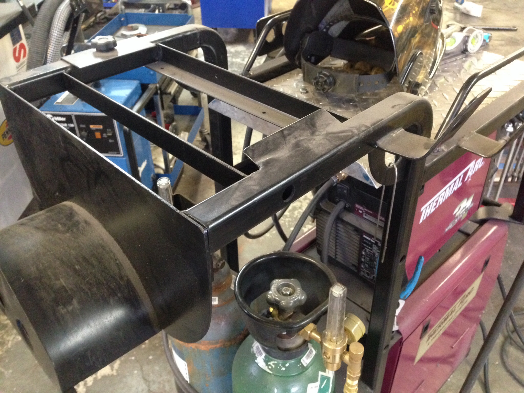

I originally had mounts so the plasma cutter could sit on top of all my welding carts, but found I preferred using it on a dedicated cart.
Terry
