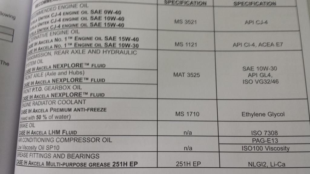

   / Hydrualic Oil versus Motor Oil
I guess for me I'm just lazy and would like all my machines to run the same :laughing:
   / Hydrualic Oil versus Motor Oil #7
What viscosity is that?
I do run the 424 in all my machines. It meets all the specs for tractor/hydraulic fluid. (Ford, JD, NH)
MobilFluid 424
