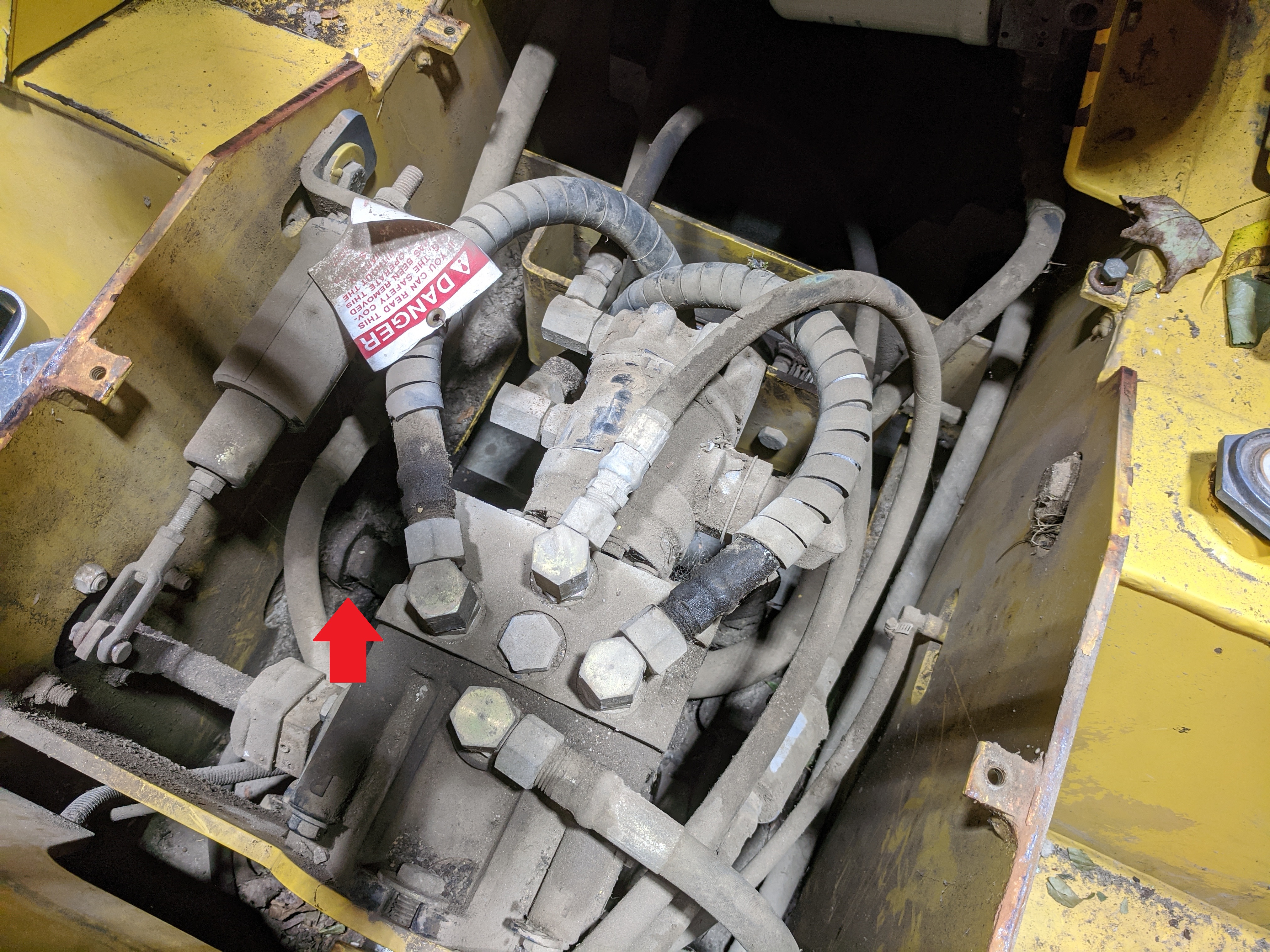

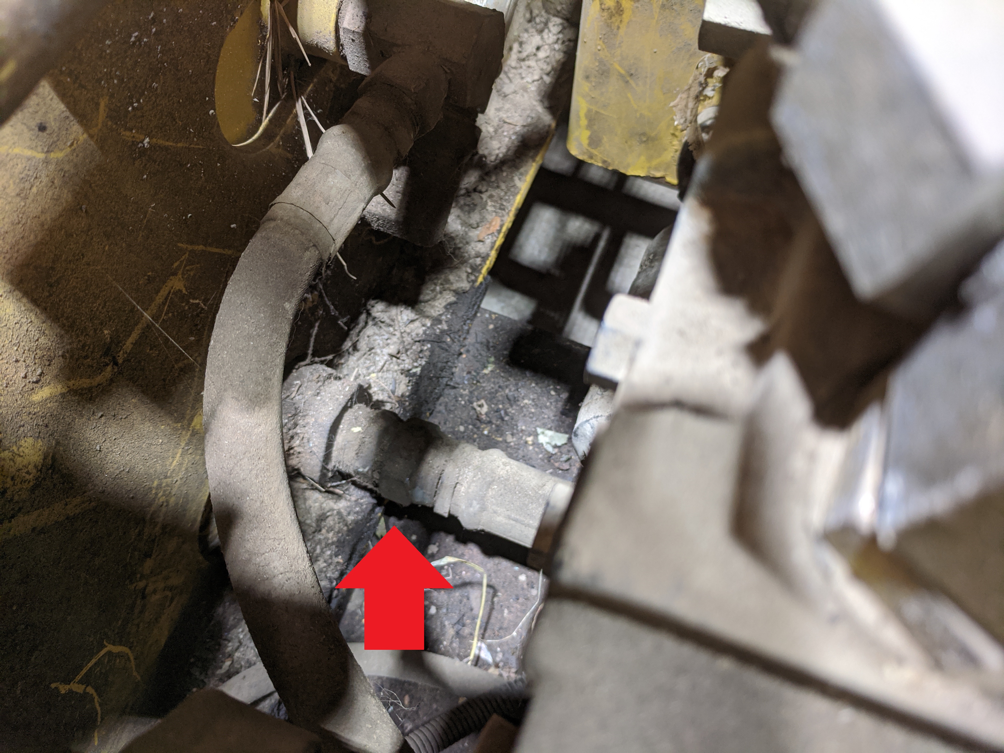

Hey guys, have a similar whining sound as described in this thread, but only when I use the front loader cylinders. I changed out the hydro fluid and filter but reading this thread was not aware of the "tank screen". I have a Terramite T7 (2007), does anyone know where the screen would be located? My guess is the location with the arrow in the below photo's, which both point to the hydro fluid line coming out of the bottom of the tank going to the pump. Figure I would ask before draining the fluid and disconnecting...
Thanks in advance,
Ralph
