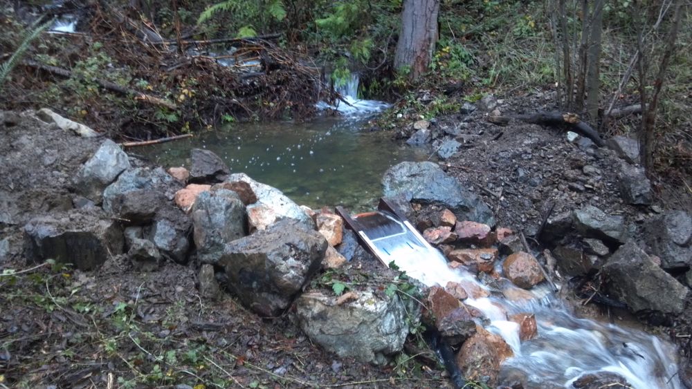

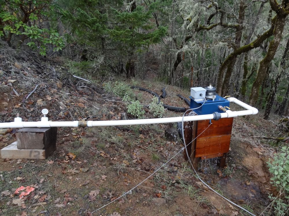

1st some backgroundd: We live off-grid -- not connected to utility power at all. In summer there is plenty of power from solar panels. In fall and winter, things are not so nice. Lots of rain and overcast. We have to charge batteries with a Lister diesel generator when the sun's not shining. (Some of the time I burn old waste engine oil in the generator which offsets diesel cost.) There is a steep little seasonal creek around the corner from the house, which just started running again. Last spring in May, just before the creek dried up, I installed a hydroelectric turbine.

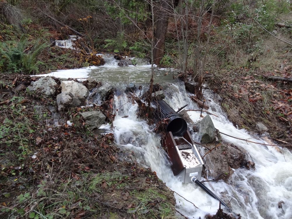

Over the past week, we had 10 inches of rain. The culvert at the intake screen got clogged from debris. The whole intake system then got washed out on Wed. night. Luckily the expensive stainless steel coanda screen didn't get washed down the creek because of some strategically placed cables I had installed last year. Time to redesign.
After getting the culvert unplugged, but just a few hours before it washed out:

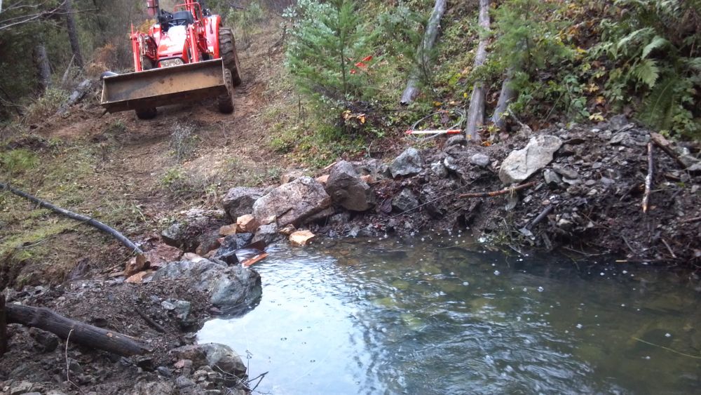

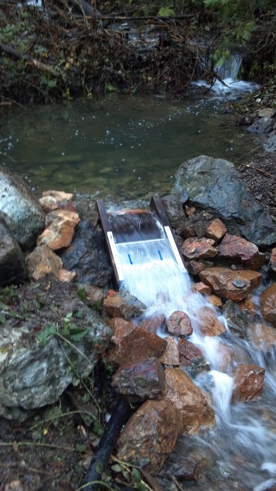

On Friday afternoon, with a lot of tire spinning in 4wd I finally got my Kioti w/ backhoe up to the intake area. First, I dug a new settling pool to about 3 ft deep and used the spoils to make a new mini-dam. Tried to use as many boulders as possible. Then, instead of placing the coanda intake screen under a culvert, I placed it at the lowest point along the dam. Now, when the water rises hopefully it will just flow deeper over the screen like a normal spillway. The mistake was using a culvert for this application.

Probably --- don't see why not. You'd want it down at the bottom near the turbine. I just put a T in the 2" penstock and installed a regular water heater TPR valve. If the pressure gets above 100 psi it should leak water. I just mentioned stuff like this because it's not as easy as putting in a penstock, turbine, and hooking up to the grid. I'm finding out the hard way that the intake is probably the most crucial and needs to be well designed.
I'm not an professional in this by any means, but I read a few books on it before attempting my own system. We came home tonight after a weekend at my parents house, and the system is producing only 10 watts. Hmm. Hope it's just a pipe joint that blew out somewhere.
