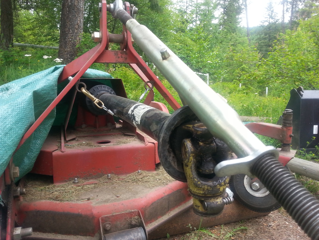

Does anyone have tips or tricks for holding a hydraulic top lift up while it's not connected to an implement? My original mechanical top lift had a bracket that held the link up by clipping into a bracket on the tractor. I've been thinking about using a loop of rope around the cylinder to loop over that same tractor bracket. Then I decided to ask for any ideas here.

Some 1/4" or 5/16" rod and bend up a new hanger, or bend your existing hanger 90* and use the hydraulic port to hook onto if it will reach.
A hose clamp around the cylinder with a link of chain.
On my 75HP tractor I was able to just widen the loop to hold the cylinder. On my 32HP tractor, I twisted the existing loop 90* and latch it onto the hydraulic port. I was able to make use of the OEM bracket-holder on both of my utility tractors. :cool:

Use a bungee cord as you won't be able to bend the bracket.

Why? I bent both of mine. Just because it is hardened, if it is, does not mean that you can't bend it. You can always put a torch to it. ;)

Use #9 smooth wire (tempered or annealed if it has enough strength), vise grips, pliers, hammer & punch in a vise, etc. and bend up the form you need - go for it! :confused:

Could you make a small cable sling with a hook on the end similar to my PTO hanger?
If you don't own a crimper you can crimp it with against a nail in a vise.
