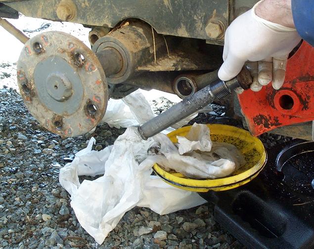

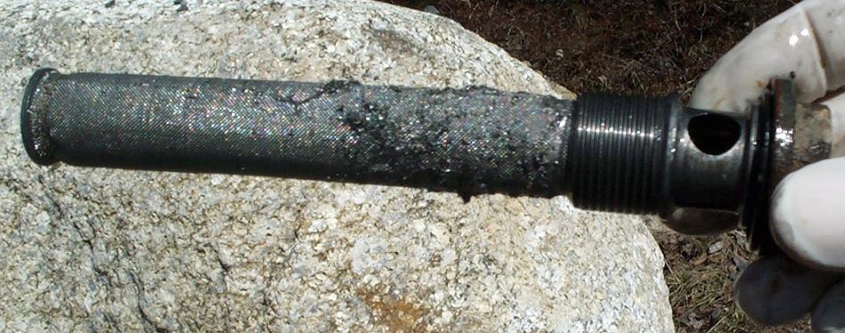

Here is a hydro screen at 400Hrs, yes these are all metal shaving... The dealer did (was supposed to) have all done this for me at 50Hrs.
I strongly suggest doing this at the recommended interval....

/ Hydro Screen
#2
Here is where u can find it... /forums/images/graemlins/grin.gif

/ Hydro Screen #3
Thanks for posting the pictures. I am approaching 50 hours and I was wondering about this step.
What do you do with the filter at this point. Do just clean it off or do you put a new one in. If it's a matter of cleaning, how is this accomplished.
It also seems by taking the time and doing this step yourself may give peace of mind knowing it was done and done right.
Your post will help many. thanks
/ Hydro Screen #4
I can tell You for $11.00 or so I replaced the strainer and "O" rings.

/ Hydro Screen #5
I also replaced mine- and then cleaned the old one for future use.
You need to use spray-type brake cleaner.
/ Hydro Screen #6
I would venture to guess that is was done at 50 hrs. I did mine at 300 hrs. (bought used) and it had considerable more shavings than that... and I don't think it had ever been done before. If yours had never been done before I would think there would be more shavings present.
It is a very simple process to clean the strainer. I used brake cleaner to wash it off and then rinsed it off by dipping it in hyd. oil. I was tempted to buy new o-rings but after looking at the setup, IMO, it is unlikely that they will get damaged and should be in ok shape. It is simply a metal screen so I see no point in replacing it. Just clean it off and be careful with it! /forums/images/graemlins/cool.gif
/ Hydro Screen #7
That screen sure is dirty. I did my BX1800 at 50 hours and it had a few metal shards on it. I did it again at 350 hours and there were next to none. The second time I did it I thought I'd wasted my time but by the looks of yours you sure didn't.

/ Hydro Screen #14
Seeing its on the right hand side, that particular image could be the screen that supplies fluid to the loader, hitch, power steer etc. On mine the HST screen is on the left hand side. But both screens are the same anyway. I cleaned mine with petrol, compressed air and a light rub with a wire brush because the gunk was so hard caked in the mesh.
