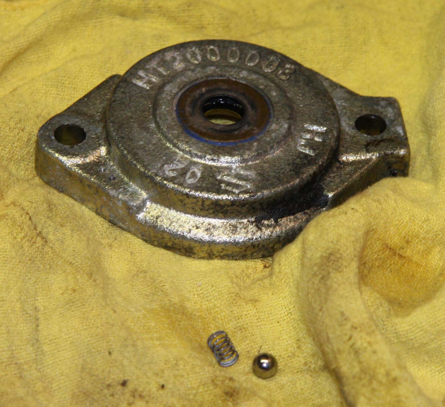

I got the heavy washer-like part off the shaft using a battery terminal puller, of all things. It worked fine.
Once you get that small top cover off [which I punch-marked to indicate orientation], you will see a small spring and ball. Note their location and pull them out of their bore. I got the notion of orientation from a video on Youtube about rebuilding a different model Hydro-Gear pump. The video indicated a primary reason for improper operation was that top cover reversed from where it belongs.
Turning the pump over I removed a snap ring. The shaft is supposed to pull out the bottom. The seal is holding it in. I used a dead blow hammer to tap it out the bottom. A spring remained behind inside. For the moment, I believe it simply slides on the shaft. There is notable end play in the assembled pump. Given this reality regarding shaft removal, I conclude the end play is normal?
The bad news is that the bearing on the lower end of the shaft is bad. The cage is broken up in pieces, many of which were lying on top of the seal. That is why the shaft orbited and why it leaked fluid.
There may be more reasons, like a piece of cage is stuck in valve somewhere.
The symptoms again; I lost the right side function and the left side was not real good. The reservoir is about half full. Now I am wondering if the lack of function results from debris migrating somewhere in the system and either blocking a passage or interfering with a spring loaded check valve or other valve.
It makes me wonder how to flush this out. It also makes me think I should do the left side motor also. Bearing and seals.
The kits from Hydro-Gear seem to have too many parts. There are a lot of parts. Multiple model applications, perhaps?
I believe I will buy the bearings, as Hydro-Gear only services them as a bearing and shaft assembly. Why?
I would rather not disassemble the wheel motors to check for debris. Any experienced thought on that?

You have made good progress- thanks for the update, also, each side serves each motor so I would blow air both ways thru the lines to the right side motor. If you can get new oil into the line (sticking the one line in oil while pressurizing the other with air) should suck oil in as its a motor driven by pressure. Maybe use some lighter weight mineral oil then 15-40 synthetic.
On the left side since its more or less independent (after the filter) it should not be contaminated but I would disconnect the motor lines and flush, then do the same in the pump.
From here, I would put a magnet on the filter and run it (Wheels up/off) with the bypass all the way open and cycle the handles back an forth. Opening the bypass circulates the oil to the tank and back and not the motors.
On the bearings I agree, get them locally.
I apologize about my lack of specific knowledge on Hydrogear but hydraulics are pretty much the same and anytime this occurs your need to clean out as best possible which I think you know too.

I picked up two new bearings today. One for the bad pump and one for the other pump. In talking with the dealer, he told me he had never seen a wheel motor damaged by debris, so I will hope for that.
I paid serious money to buy this new. I can't rationalize or accept buying expensive, new parts when the machine only has 122 hours.

Lessons learned.
It is possible to remove a snap ring and remove the seal from below. You have to have a way to hook the seal to pull it. If the bearing is fine, then that would be the way to go. The risk is in how you hook or pierce the seal to pull it. I did not have what I considered to be a viable answer there.
if you pull the shaft, or drive it out, to remove the seal, then you leave a spring and washer behind inside the housing. You cannot put that back on the shaft and slide it back in with the shaft. You have to remove the end cap and cylinder block assembly.
The cylinder block assembly looks somewhat like the cylinder from a revolver. There are seven pistons in this pump. When you pull the cylinder block out you will likely have pistons and springs come out of the cylinder block.
In behind, or below, the cylinder block there is a thrust bearing and race that rides in the swash plate. It is possible the swash plate will fall out once you have removed the cylinder block assembly. There is a small, square piece called a slot guide. It will probably fall off or out, too.
Hydro Gear has a great .pdf of a service manual available. It is long, covers many models, and initially is a bit off-putting, but it has a lot of good information and illustrations.
Assembly necessitates putting the shaft and bearing in the empty housing first, then retaining it with the seal and snap ring. There is a spacer between the seal and the bearing.
The seal seems a slip fit in the bore. I would expect it would have to be driven in, but..... apparently not. It is not clear to me why that does not leak, or at least weep.
I think [I have yet to do this] the hardest part will be to get the cylinder block back in the housing. You are supposed to lay the housing on its side. That is great because that orientation will keep the pistons from falling out of the cylinder block. The downside is that I am not sure how likely it will be for the swash plate to fall from its position.
Petroleum jelly is mentioned as an assembly lubricant for O-rings. I wonder if it would also be acceptable for retaining little parts.
