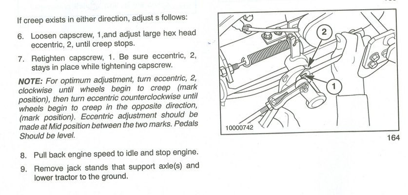

I have a NH 1520, and am getting annoyed with the hydro creeping when in the neutral position......is this easy to adjust? I haven't had a chance to investigate yet, but plan to this week-end. Any suggestions to make this an easy fix? Thanks! Kerry

I'm not a hydro guy.. but are you sure the pedal is centering.. or returning to center completely? If you pull on it does it stop the creep? if so.. check linkage and spring returns.. etc.

This information applies to my TC-40D but I'm sure it's very similar to your situation as well. See attachment for adjustment procedure.
