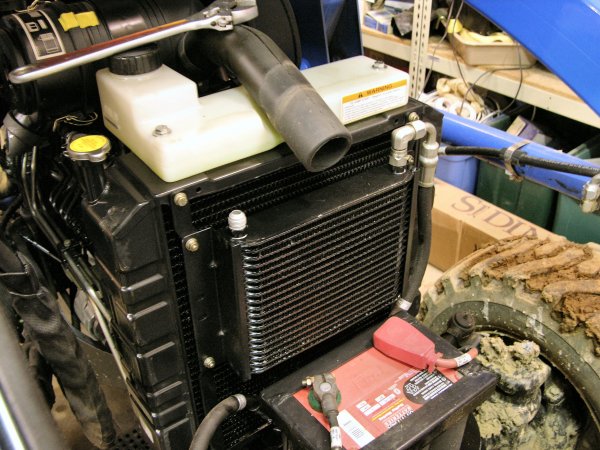

Yesterday when I went to jump on our TC40D I noticed a wet spot under the tractor. Upon closer inspection I located a stress crack in one of the hydraulic oil lines right where it exits the shell of the oil cooler. I understand that NH has since come up with an improved oil cooler because of failures in the inlet and outlet tubes on these oil coolers. (Part number 87301196) Can anyone elaborate on this problem a bit more?

The oil cooler

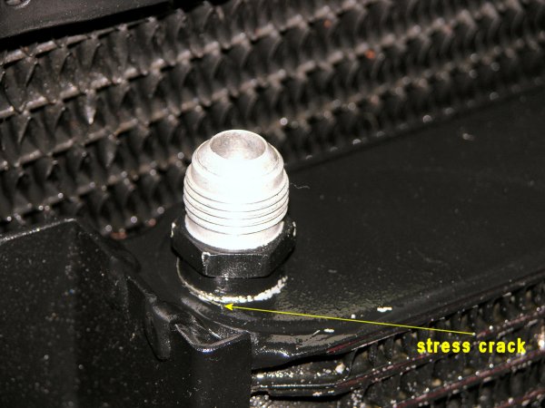

The damage, follow the arrow and you can just make out the stress crack. This happened at 500 hours on the meter.

Hey PineRidge.. I see you have some dirt on your tires.. but your engine looks pretty clean.. isn't there any dust in Ohio?
I also have a stress crack on the oil cooler.. it is not on the oil line exit.. but on the weld for the bracket.. right next to the oil line exit. Wonder if it's just from all the vibration... bad welds?

If your cooler is no longer under warranty think I might suggest that you repair the mount before it gets any worse. If it looks like mine you could probably double up the thickness of the metal at the mount to eliminate that from happening again in the future.

Jim it appears to me that the tube passes through the end plate and is mechanically welded to the plate to stabilize the stub from vibration. Unfortunately the harmonics eventually cause the failure at the junction of the plate/stub (probably the weakest point). I haven't seen a new style cooler since my dealer didn't have a cooler in stock. Can't make a comparison at this point. Maybe once the new cooler comes in I can snap a picture or two of it to compare. It's not a bad job at all changing a cooler, 15 minutes and it was out, I'm sure installing the new one won't be any more difficult. In fact it will most likely take more time to top off the hydraulic fluid after the job has been completed.
