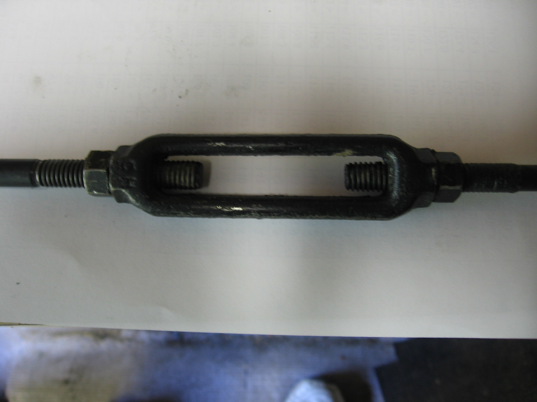

I am trying to figure out how to adjust the hydro in my 317. It is a a little bit sloppy and reverse is very slow. Sometimes reverse is normal, so I feel like it is an adjustment problem. Since I have rebuilt the engine and replaced many worn parts, I would like to address the hydro issue as well. I bought new fluid and a filter today to change the fluid. I was wondering whether to change the fluid first and then adjust the hydro or to adjust first and then change it. Is it better to run the tractor until it is warm or just change as is.

On my 316 there I a turnbuckle between the shift lever and the transmission. To get to it you either have to take the fender assembly off or the bottom screen. I just know how I get to it don't know what the adjustment does. I am bringing mine back to life after ten years in the shed. I cannot get it into reverse. Forward works but no reverse.

Right Wichman. Jdparts shows that turnbuckle on the 317, but no indication what to do with it.
I'm sure you adjust them all the same way.
Rear has to be up off the ground,tractor running,then you adjust the turnbuckle. It is kind of scary because the driveshaft is turning,and you have to be very careful,but this is the only way to get a completely accurate adjustment.
I definitely would check the linkage hardware first though There should not be any play whatsoever. If anything is worn,you will not be able to adjust the creep out of it. I thought mine was OK,until I disassembled the rods. Boy was I surprised!

Are these adjustments on the hydro or in the linkage behind the battery box.
The front rod is behind the battery box persay,and the other half is connected to the transmission.

I finally got the time to tear my 317 down and find out the problem. It seems that I have wear on the pivot arm of the hydro shaft. It was loose on the shaft and the roll pin was also loose. I ordered replacement parts and while I had it apart I removed all the hydro linkage. I found that I had some significant wear on the fiber bushings at the pivot points on the control arms. I ordered all new bushings. I hope to receive the parts by Mon. or Tues. of next week. I feel like this will fix the problem. More to come.
