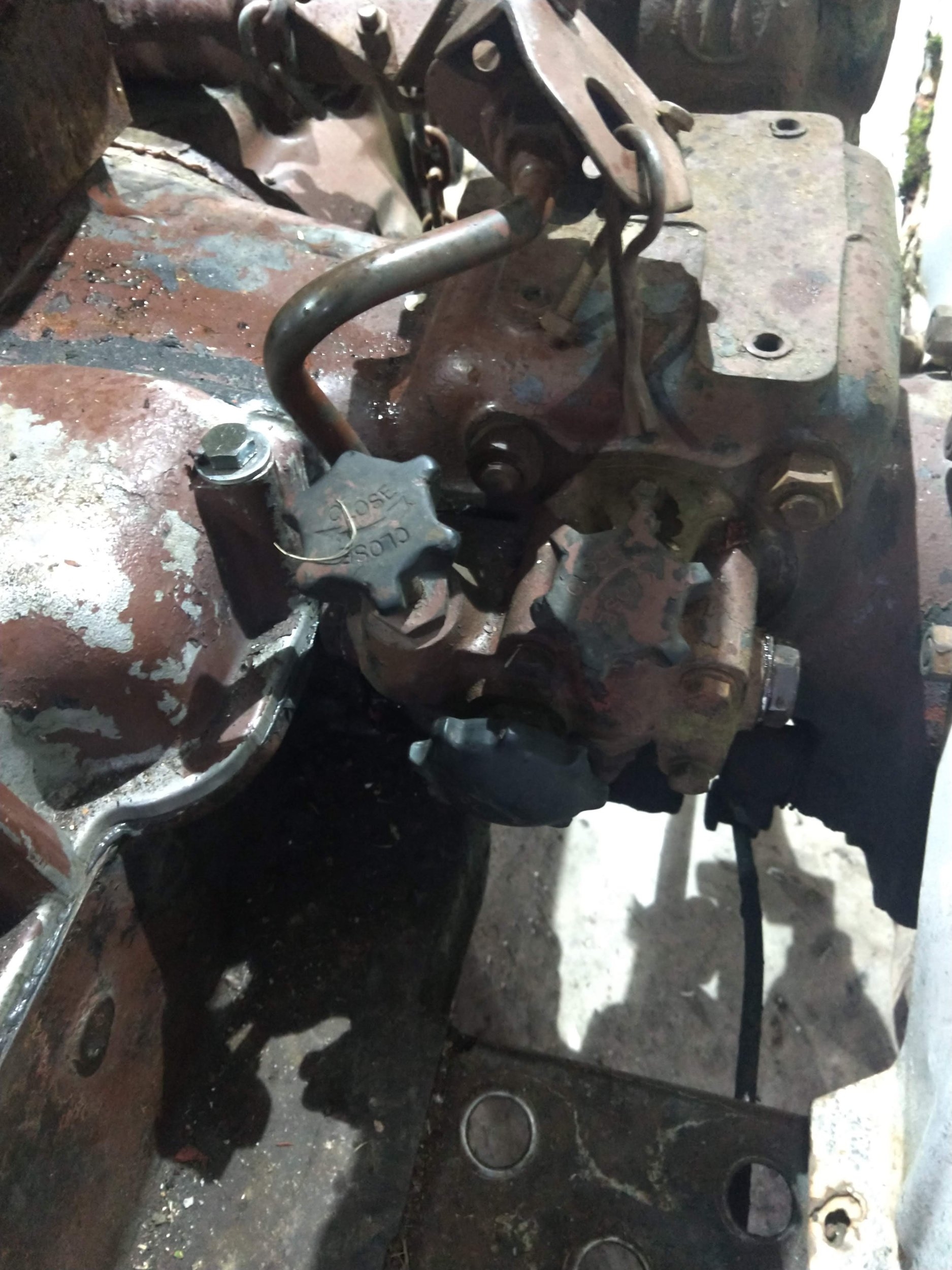

The one on the 880UE Implematic we used to have looked like this:

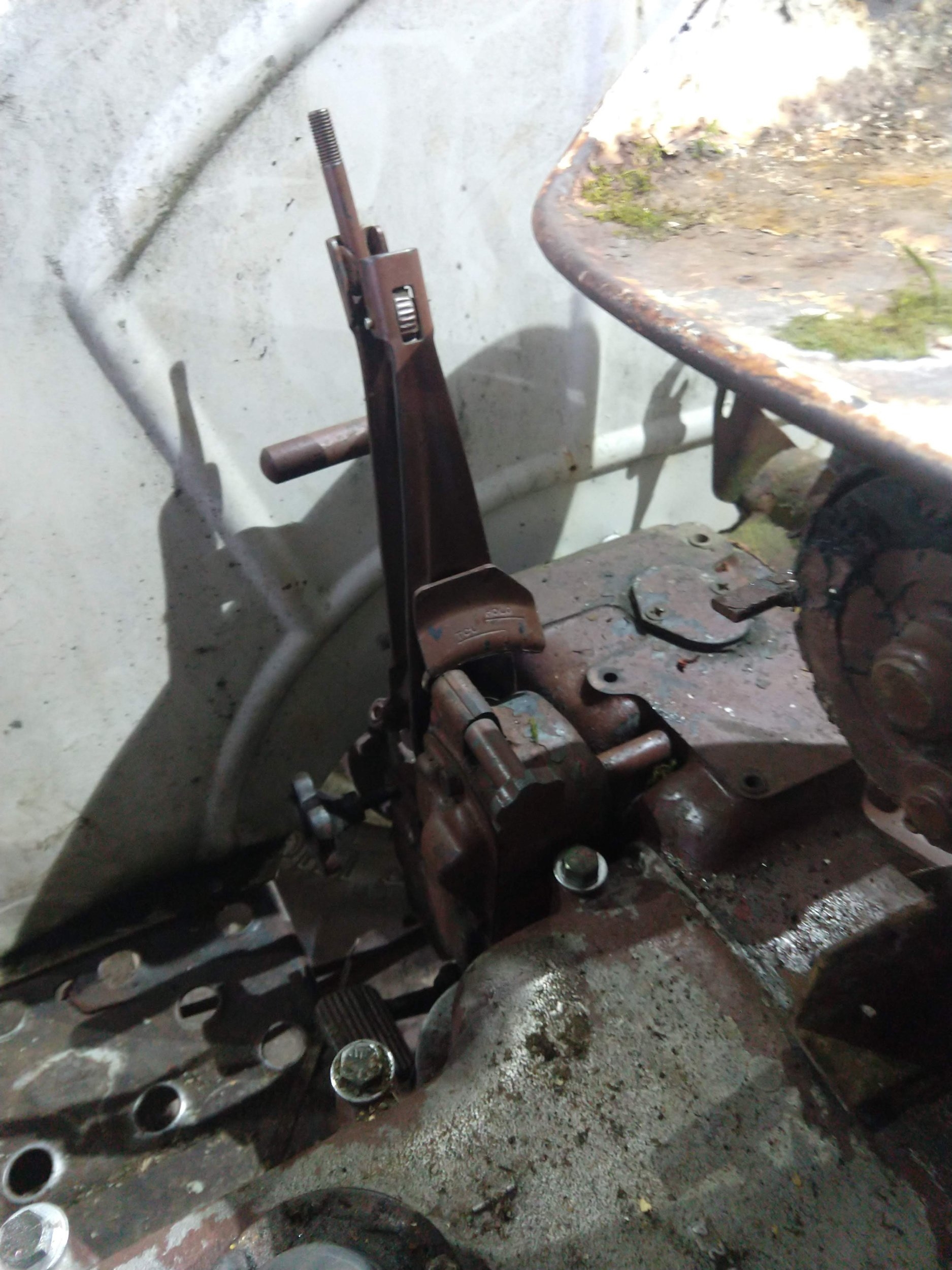

There is a valve for the 3 point, external remote and a spare, if the one for the 3 point is closed you will not get ANY flow to the 3 point to raise it up.
On the left side (again, assuming that it is similar to our 880 is a rate of drop valve, that will keep the 3 point from lowering:
There is also (on the Implematic at least) their rube Goldberg collection of connections inside that connect the valve to the lever.
Great when it works, difficult to troubleshoot when it doesn't.

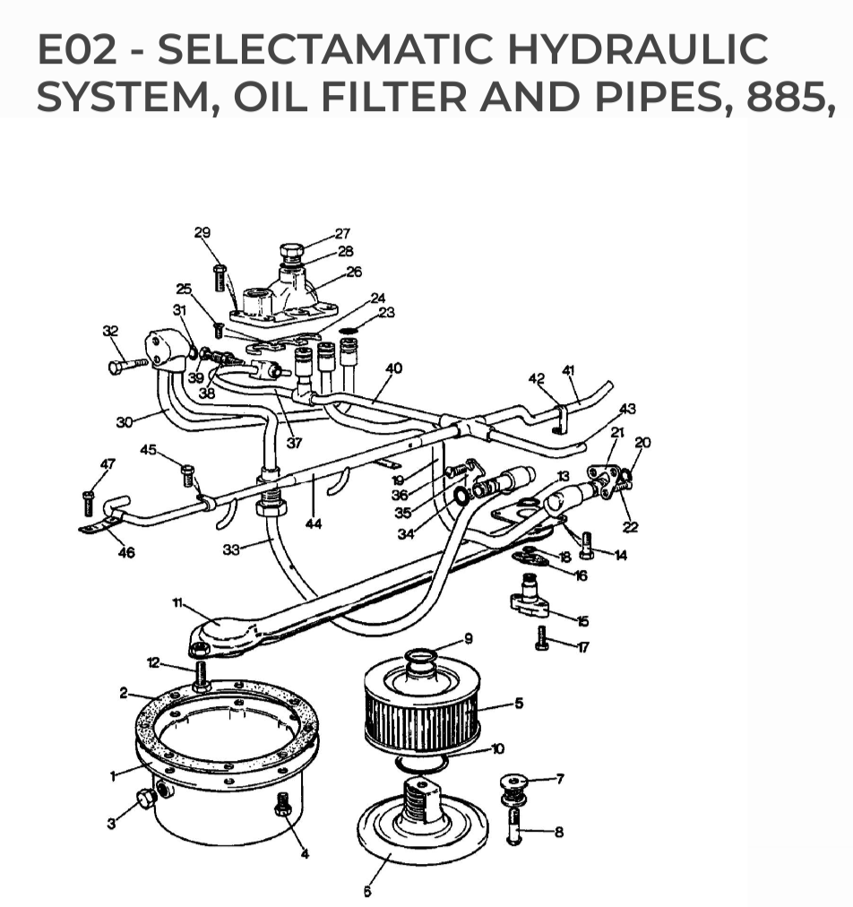

Drain the hydraulic oil, then check underneath, just in front of the back axle is a circular pan that can be removed, the hydraulic suction strainer is under that, you will want to open that up and clean that out. Mine was plugged with water/oil sludge:

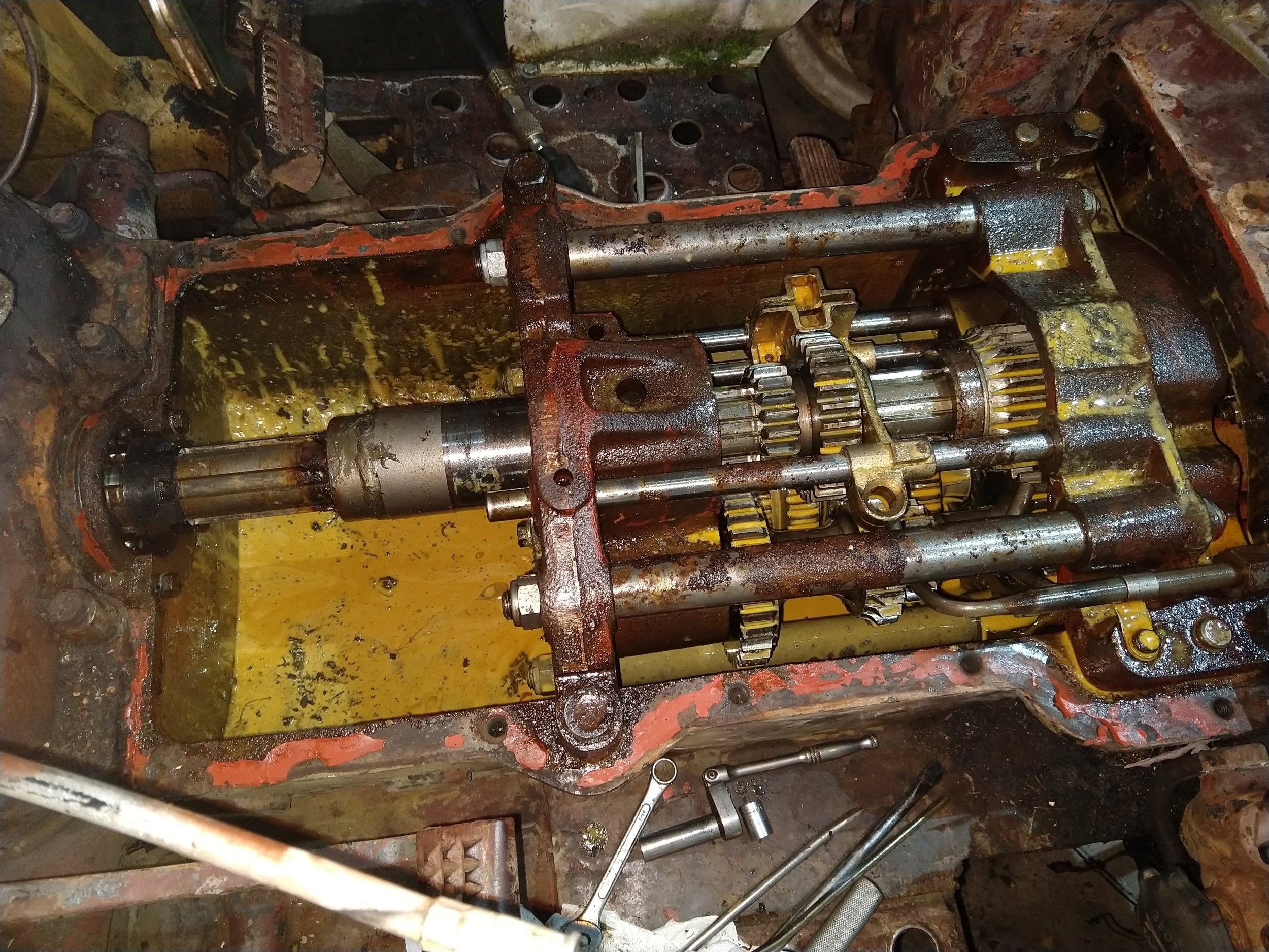

I would also remove the top plate (that the shifters stick out of) and clean the inside of the gearbox, mine was nasty:

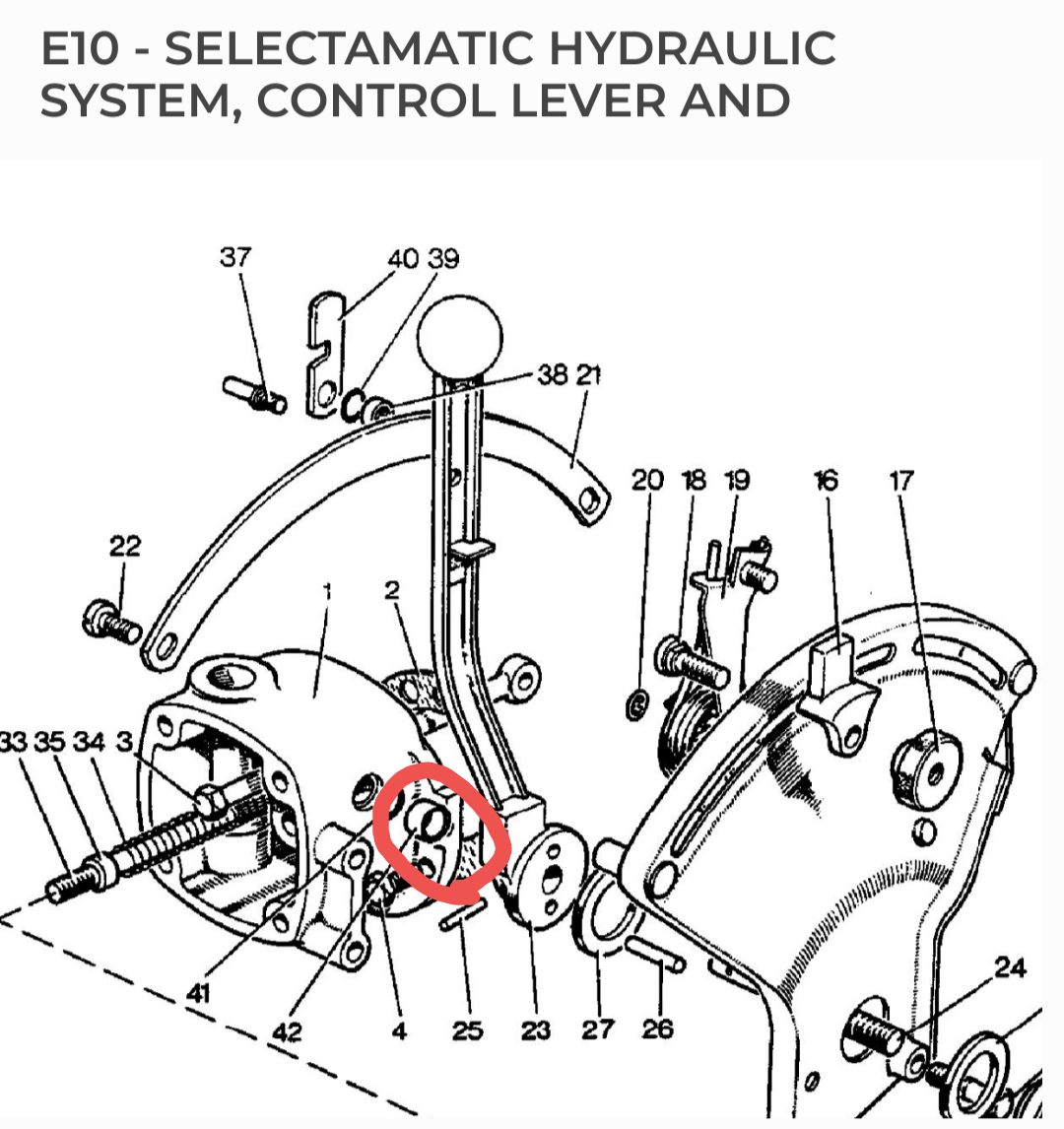

My 3 point lever was stiff here (#42): Case IH 885 - DAVID BROWN SELECTAMATIC TRACTOR(01/71 - 12/76) Parts Diagrams
