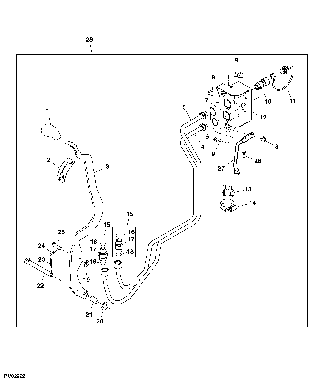

could someone help me, I have a 3320 JD with mid scvs can I run a hydraulic top link off these,
   / hydraulics #2
Yes you can, just run long hoses to the rear.
BUT: Why not get the 3rd SCV kit? You already have the valve, the kit includes the WD's, hardlines, lever, brackets and hardware to control it.
This is for the older non-CAB model (you need to know your serial number to order):
Third Scv Kit ( - 710000)

Thanks for the reply,I was hoping I could.
