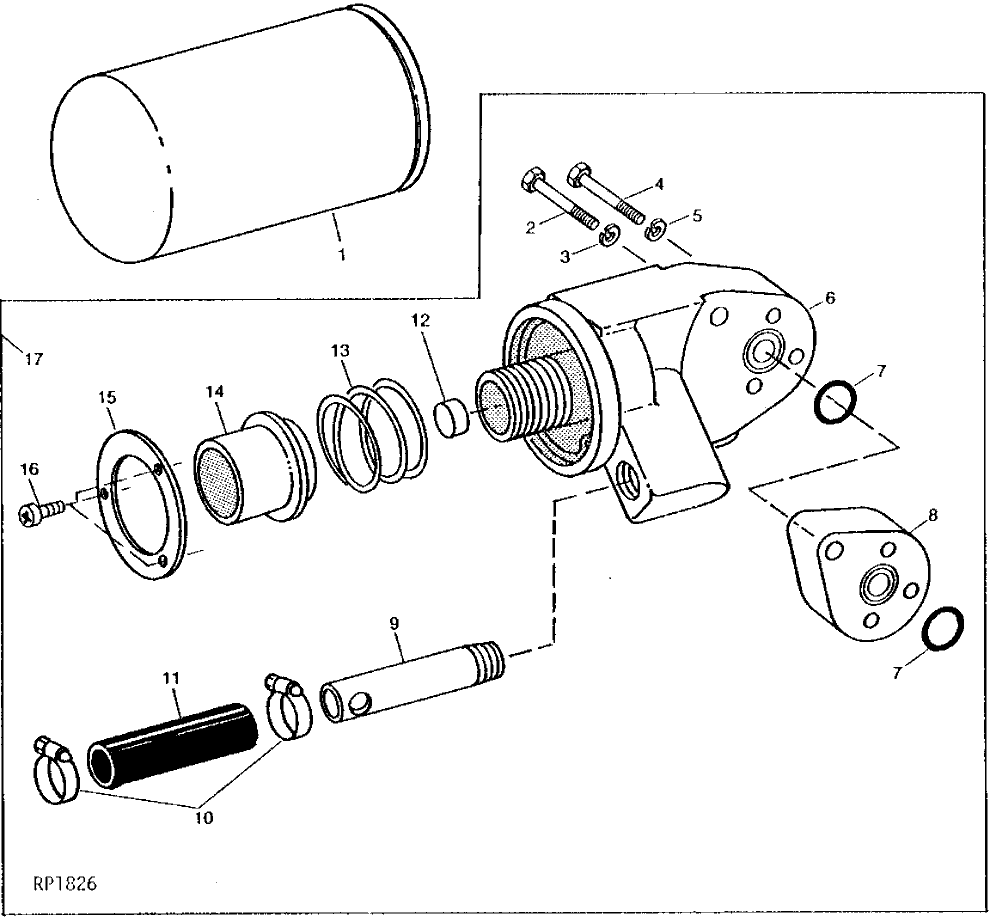

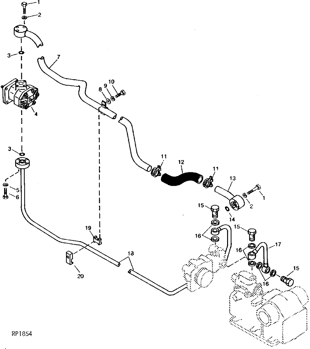

Hi All,
I just got my first JD 750 MFWD tractor. Although my husband is a great mechanic, as we are going thru this machine because he wants me to be safe, we are having problems with the hydraulics. Does anyone know if there is supply tube of some sort that opens the little door & attaches to the oil filter?? There looks like there should be some kind of tube or something. No hydraulics yet & I would like to have an answer for him so he thinks I know something other than driving this machine.We have checked the pump & lines, all are good. I love my little tractor & have waited a long time for it. I just want it running so I could start putting up my horse fencing.

Is there a tube inside your hydraulic filter that attaches somehow to open up the supply line to the hydraulics??

Below are some pictures from www.jdparts.com that I got for you. I suggest you register there (it's free) It may help you a lot...There is a quick tutorial in my signature.
I hope this helps some.

Thanks for the info on the hydraulics, that website will come in handy. They are working now. It was the screen filter that was clogged from sitting so long. I put on my york rake & had a blast.......
