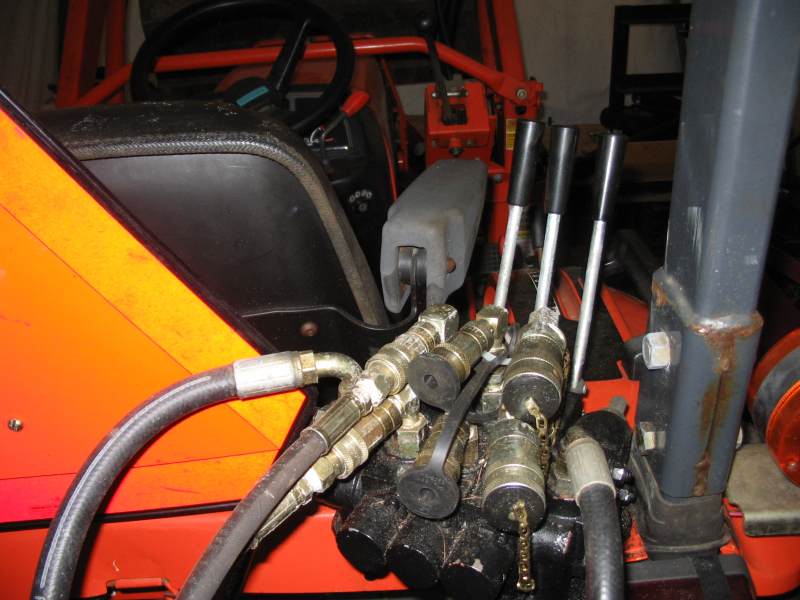

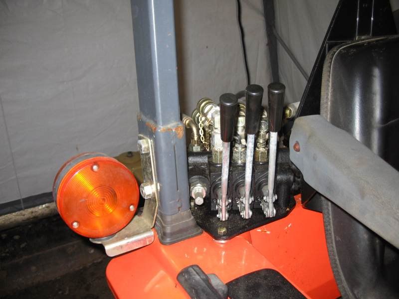

I'd like to add 2 rear circuits for controlling a hyd top link, snowblower chute, etc. Right now I have the typical two spool valve for the loader and an aux single spool valve for my 3rd loader function mounted on the fender. I think I want to install a diverter valve, but I want to get rid of the aux valve at the same time. Does that mean I would need two diverters? Do they make units that would perform both functions (divert both spools for rear and divert one spool for front on separate switches)?

I have three spools on two valves right now and three circuits, but I would like to go to two spools on one valve and five circuits. I want to get rid of the stupid el cheapo valve on the fender and replace it with a diverter setup on my main two spool valve. Would something like these do the trick (with some wiring and switches) or am I missing something?

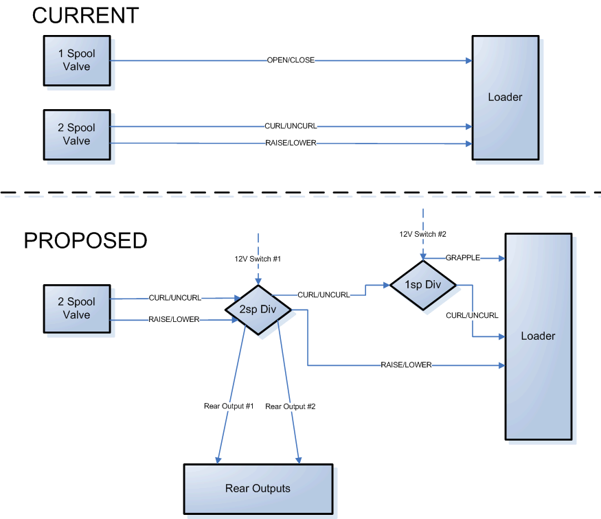

I made a diagram of what I would like to do... might help to make it more clear.
The links you provided are not diverters, but electric spool valves.
I'm not sure what the difference is then. I thought diverters were simply valves that switched flow after being activated either electrically or mechanically between a couple different paths. Unless the difference is that these require current continuously when switched while the diverters only require current to change the valve position. If I am missing something here, please clue me in.
Running them off the loader valve will severly restrict what you can do simultaneously and you will need some method of controlling which circuit will be active.
I don't see an issue with wanting to be able to use the loader simultaneously with the rear outputs (I can't look both forward and rearward at the same time anyway), and I cannot use the two loader valves simultaneously right now because both valves are mounted on the same side and not very close together.

A diverter takes one set of spool work ports and "diverts" them to one of two sets of outputs. One set in, 2 sets out. The selection takes place using a 12v switch. Diverters are not spools and they don't act like spools (ie, they don't change fluid directional flow).
A spool valve like those from Northern are not diverters. They are no different than your single spool lever operated valve except that instead of a lever you have a 12v switch.
Your proposed diagram really cannot happen as you have drawn it. You can take the loader curl/dump work ports and feed them into a diverter to control either the curl/dump or grapple. That's done all the time.
The raise/lower work ports can also feed a diverter to control either the loader raise/lower or a singe set of rear remotes. You can then use the V&M Add-A-Valve to make that single set of rear remotes 2 sets of rear remotes. You could also replace the V&M with another diverter to get the same end result. You could also get a V&M SV series 3 outlet hydraulic multiplier which would give you one in and 3 out.
However, in my professional opinion, this is probably the least optimal setup one could have. Plumbing this would be messy at best. The cost for your setup would be several times more than simply adding a 2 or 3 spool valve and we are talking about probably close to $1000 if not more. I don't recall the price of the V&M stuff but they are not cheap. A good diverter runs about $200 from Surplus Center and you will need 2 or three. Plus hoses, plus fittings. It adds up quickly.

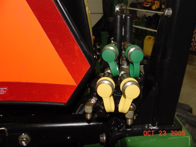

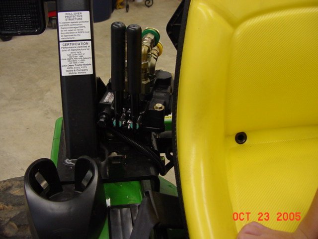

I don't quite understand your concern over hoses on the fender. I have a three spool Prince SV valve sitting on my rear fender and I don't have any hoses laying on the fender. In fact, I also have a third function valve going out to the loader bucket for a grapple and I don't have any problems with hoses laying everywhere. You might want to re-evaluate how your plumbing is done. Take an old garden hose cut it up and use it to route all your hoses. You will quickly see what you will have and how much hassle it will be. Don't forget that hoses can't be bent sharply. Also consider how you will be connecting to the multipliers, and how much room you will have to mount them. Figure a couple of hundred bucks or more before you are done for plumbing.
