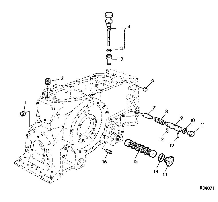

What's the tractors serial number? 2040 could be open or closed center hyd's depending on serial number which are different to diagnose problems. Is engine a 3 or 4 cylinder? Did you check frt hyd pump drive coupler to be sure hyd pump shaft is rotating when engine crankshaft is rotating. Have you checked/cleaned trans oil sump screen(parts key 15)???
