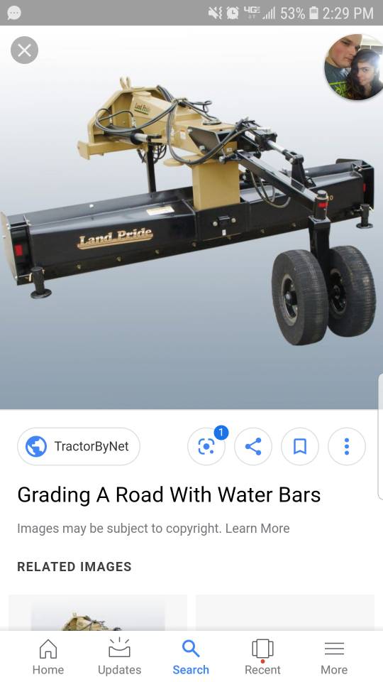

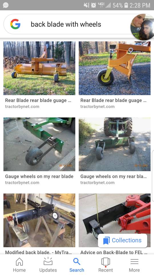

Another cheaper but not a great option is adding wheels to the back of your box blade or back blade.
First picture shows just a few ideas. But you want it further out to get better results like the 2nd picture. Then leave your top link unhooked and you can adjust your height with the 3pt Screenshot_20190613-142900_Google.jpegScreenshot_20190613-142922_Google.jpeg

Sometimes you just need the right pointers on how to use what you have.
