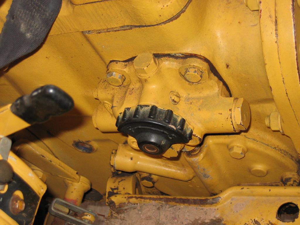

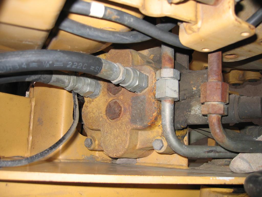

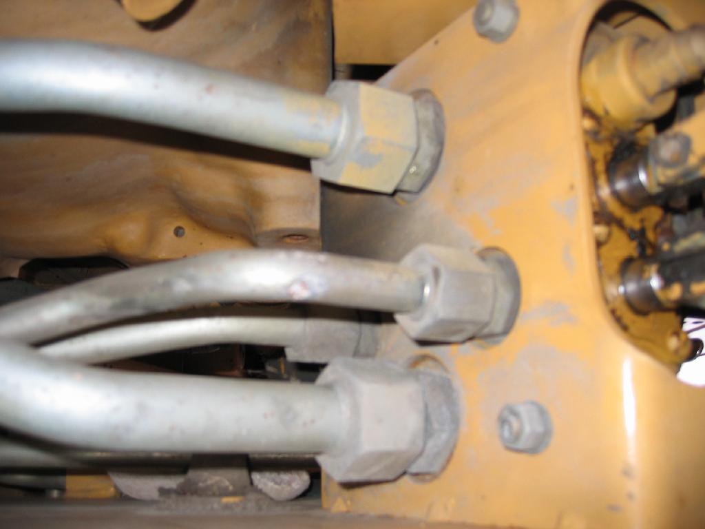

I am trying to figure out how to route hydraulics for a backhoe attachment for my Ford 345C tractor. I attached some photos of the loader valve, which I would like to run some sort of 'Power Beyond' setup cause the pump is pumping 26gpm and the remote cover that is on the top cover of the tranny. There is also a photo of a flow control valve that I am not sure exactly what it does.

My question is: How can I go about getting hydraulics back to a backhoe without the use of a PTO pump? My first choice would be a Power Beyond setup. My second would be adding rear remotes from the tractor's internal hydraulics by means of the under the seat block off plate on the top cover.

That valve doesn't look like it's configured for power beyond. But don't despair, all you have to figure out is which line is the valve inlet and which is the outlet. Since you won't be using the loader and backhoe simultaneously it doesn't matter.
Just put your backhoe valve in series with the loader valve, either before the loader valve (not recommended) or after the loader valve (recommended). You will have to determine the best way to plumb the connections since I don't guess you want the backhoe on there permanently. A couple of QD's and a loop hose will suffice for when the backhoe is off.

You cannot tee into a pressure circuit. You backhoe valve MUST be in series with the loader valve. You have to break the line and insert your backhoe in series. When the backhoe is not in the circuit, the circuit must remain complete using a jumper hose. Failure to do so will dead head the pump and your wallet will be short a significant amount of money.
   / Hydraulics for Backhoe #10
I owned and operated a Ford 4500 with FEL and 755 backhoe for 17 years. I just looked up the hydraulic circuit diagram in the Service Manual. It shows pump output going to the inlet of the backhoe valve, then from the outlet of that valve to the inlet of the loader valve, and then from that valve's outlet to the tank. There was no power beyond function back then (1967). Like MadRef and FullPull say, hook them up in series. You won't be able to operate the hoe and loader at the same time (if you can even reach both sets of levers at the same time:) ), but that was never a problem with me.
