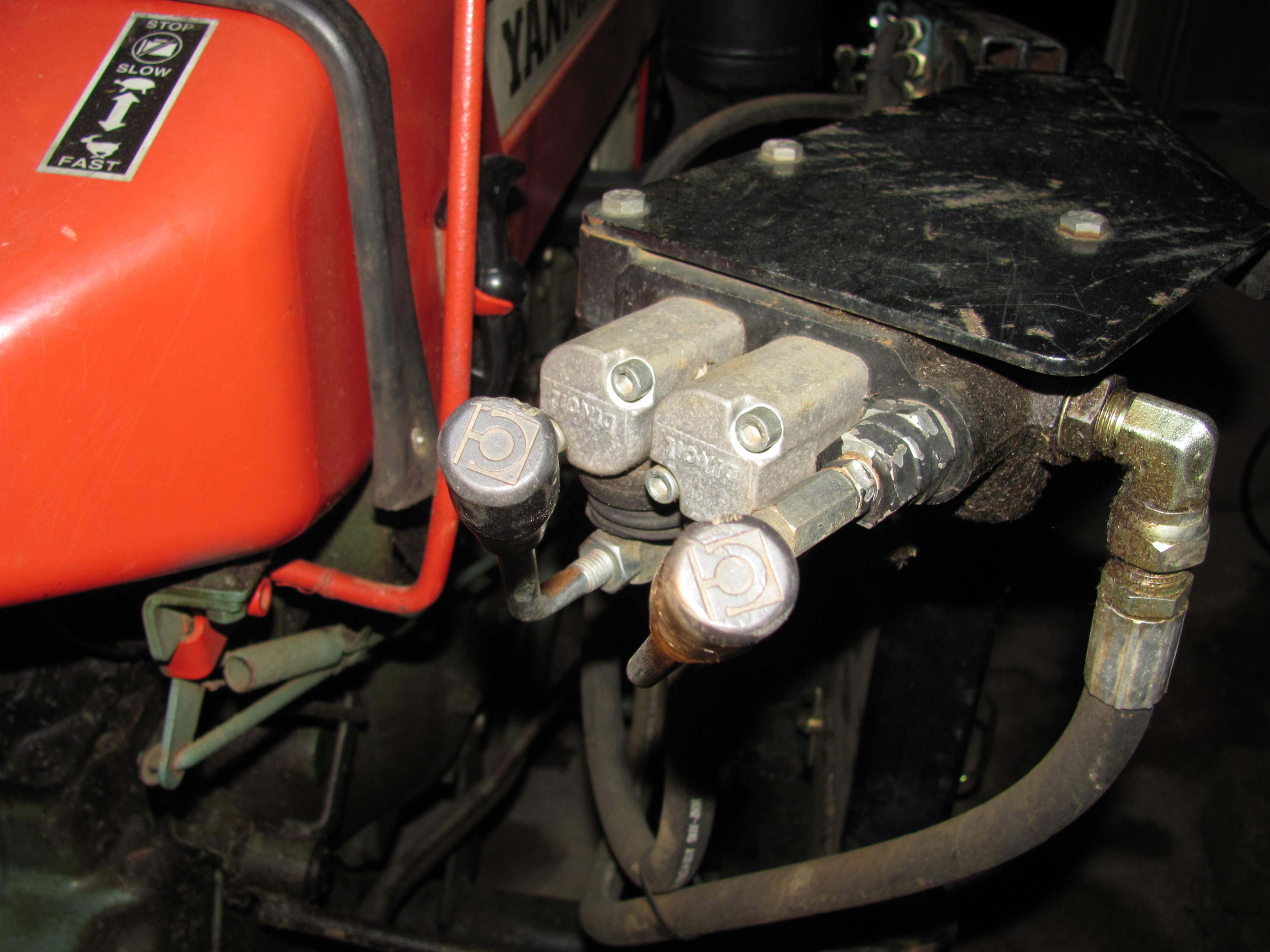

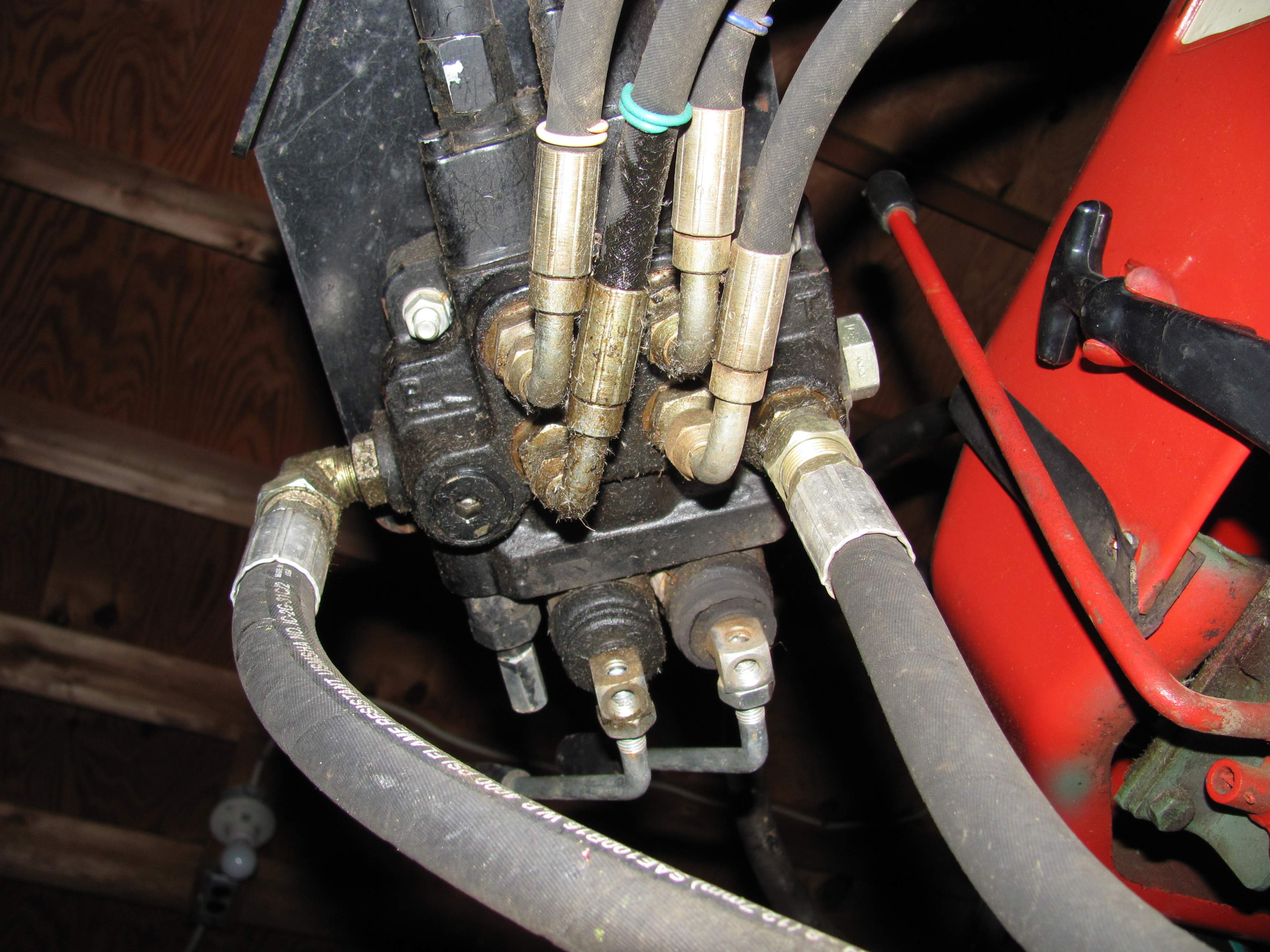

OK, ordered a grapple for my bucket, going with a power beyond fitting from loader valve. I believe the grapple has 3/8" fittings. The loader is a Koyker 120 with separate lift and curl controls.
So......what the heck do I need to buy, exactly?:eek: People have already told me how to do this, seems like I'm a slow learner.
I need a valve (type & size?), hoses (ditto), fittings (ditto)
Also....some of you have advised against quick-connect fittings. Howzabout if I use them at the loader valve, so I'll only ever be taking them off to put other attachments on (I'm thinking log splitter)?
Your help will be much appreciated.
Steve
Separate question: should my loader (Koyker 120) have down pressure? It doesn't now....

That "sticking" position is called "float", it allows the bucket to follow the contour of the ground like where you are back-dragging or plowing. Before the joystick enters that point you should have downpressure. Make sure all the linkages are lubricated well on the joystick.
Have you verified you can get a PB sleeve for your loader valve? If you post pictures of it...we can help better.
I have not verified that I can, but was told that I COULD...:)
I'll go and take a photo right now, post it in a few......

Hope these are sufficient......
On the loader front; maybe I'm pushing the lever too hard, & going straight to the float position? I'll try it again tomorrow.
Thanks for the help!!!!!
Steve
