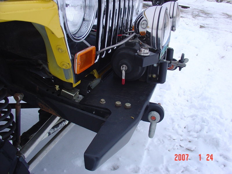

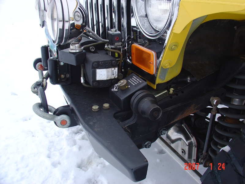

I use a MM winch on my Jeep. There are two different types, 70 series or 75 series. I run the 75 series which comes with electrical solenoids that direct fluid flow. When neither solenoid is activated the winch free flows back into the system. When either solenoid is activated the fluid is directed thru the hydraulic motor and the drum turns with fluid then returned to system. No additional spool valve is required. The output of my power steering pump goes directly to the winch, then to the steering box, then to the cooler, then back to the tank. The winch comes with a remote controller that can be used or you can wire a three way toggle switch to do the same thing. I have a toggle switch in the cab as well as the remote hookup located at the winch. This gives me the ability to operate the winch from the drivers seat of while standing outside the Jeep.
I am attaching a drawing of how it is plumbed into my Jeep's system. Mad can confirm if this would apply to your tractor's system. Also attaching a picture of the winch mounted so you can see what it looks like.
