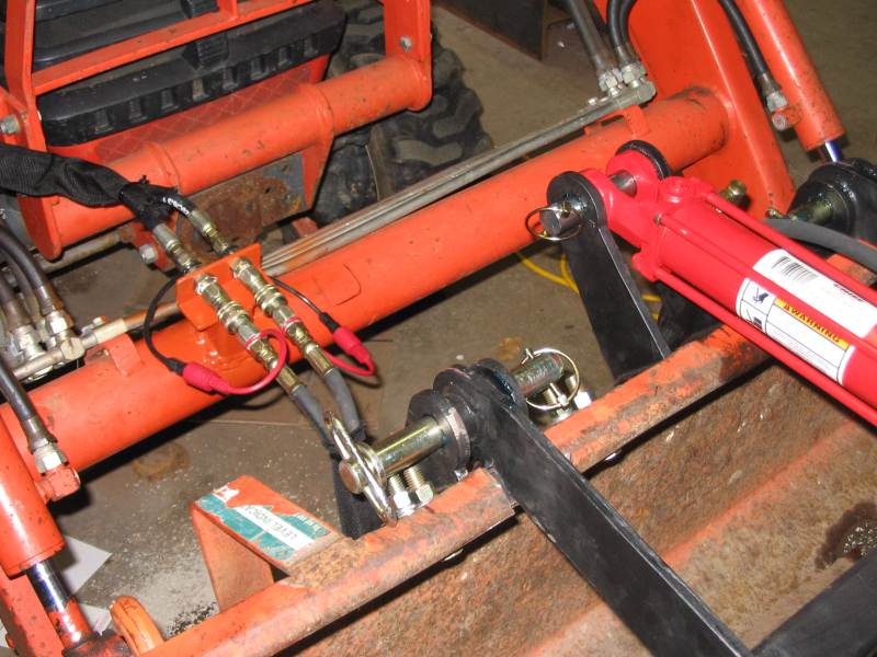

I used the WR Long kit. The mounting plate is matched to your tractor thus making installation very easy. The only thing you might want to do is change the hoses that go to the front. I replaced mine with shorter 1/4" hoses that had QD's. A short hose then went from the QD to the cylinder. The other nice thing about the WR Long kit is that you get the push button ball for the joystick end.
