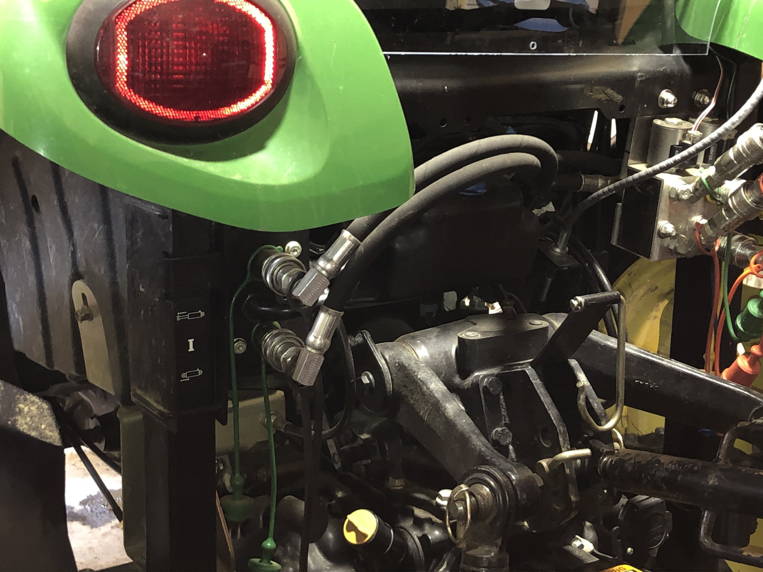

Is it worth to have a hydraulic toplink for rear facing snow blower? Reason I'm asking is because I already have a remote for the chute that I'll be using this summer for the box grader by connection a toplink to my remote valve. During winter, with an extra valve, I could connect the toplink to the blower. My current one spool valve though is not optimal and I'm changing it, so I'm considering buying either a one spool or two spools valve. It would cost about $175 for the extra spool, hoses and fittings hence why I want advice on its use on a blower. My road is not flat. There biggest slope is about a 20 feet elevation difference over 100 feet with a few feet elevation now and there over 1000 feet if it matters,
Thanks.
   / Hydraulic toplink for rear facing snow blower #2
I'm a lot more level for the driveway but for the hydro look into a Fasse Valve. Is it perfect? No. Does it work just fine? Yes. I'd try it with out it first but the valves could be a real benefit in the long haul. I wish I installed another really but I'll survive.
Saved thousands over any other options like adding #2 and 3 remotes. 3F8B5B26-79DB-4F6C-AC93-4EB9B81704E9.jpeg44A9FFC3-8C25-4F56-91E3-0BC777A8A2DE.jpeg
Factory remote on the left and Fasse on the right mounted on a custom plate I machined.
