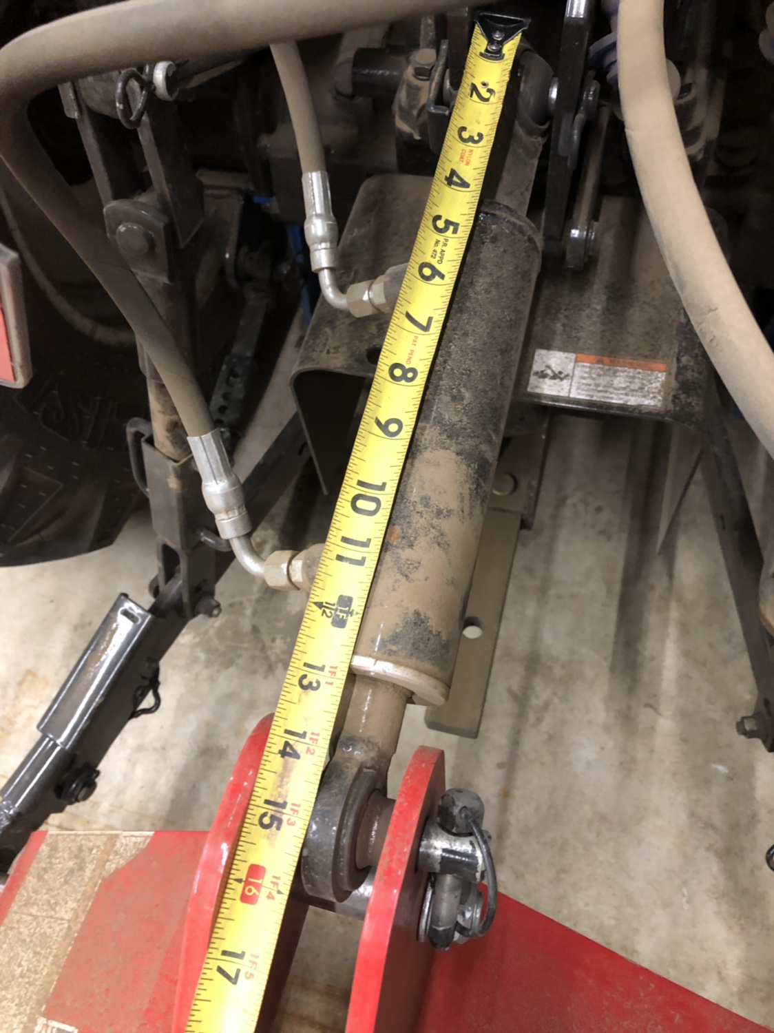

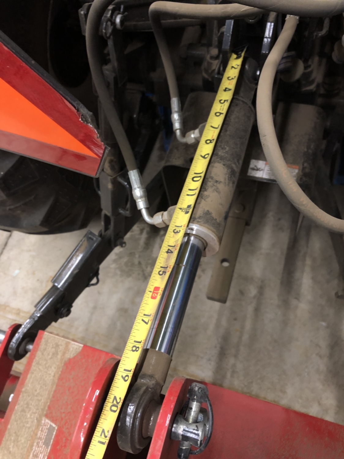

   / Hydraulic top link #10
Here are the two measurements on my XR3135. 15-20 inches
