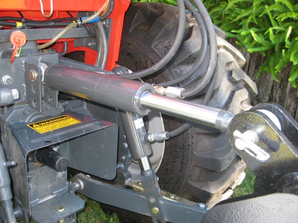

So I got my first rear blade a few weeks ago, put it together and installed it on my BX25, and off to plow some snow. What a pain in the tail with the constant adjusting the toplink in and out to bring the blade higher or lower when I flip the blade around to push or pull. Would a hydralic top link make this go easier? Is there a kit that can be purchased to work off the BH connections, that would have a cylinder and valve? Or is this usually custom work? I have enough projects to deal with right now, so I am looking for something more on the simpler side, not necessarily the economical way.

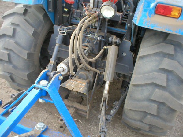

The hyd toplink will help you raise and lower a little but more change the angle of the blade, but if that is what you need to do to rotate the blade then I guess it will help and make it easier. I added one for grading but left the blade on for the winter. If you have rear remotes, it is easy to control from a valve there. I can control each of my rear remotes from a stock installed 2 spool valve. It sounds like you would have to add a control valve of some kind to make it work easy.I got my top link from Dalton . Two 2'-3' 1/2" hoses and I was away. Into one of the rear remotes sets. That control valve can feather it nicely. Don't know how I have done without it. For hookups and adjustments while your working it is great.

I am in the same boat as you. I want to use the same BH ports as well and I been reading here about power beyond, 2 tanks returns. I bought a single spool prince valve from my local hydraulic shop for less then 100 bucks and it comes with a power beyond plug. I am in a middle of another project right now so will not be starting this hydraulic project just yet. The biggest reason I havent really started this project is becuase of the location of where I wanted the valve handle to end up. I prefer to put it in the empty slot on the right but there seems to be no room for the mounting and I am not keen on the valve getting mud and dirt all over.
The other issue is the top link with and without a checkvalve for leakdowns. I have seen posts with positive and negative comments without check valve. I too want to just keep it simple and since its a small tractor, the leakdown "shouldn't" be a issue. This is all speculation right now.

As you saw, mine does not have the check valve, at this point it has not been an issue. No problem with leak down. For now I guess my control valve (no leakage when in neutral position) is solid and the cylinder being new is good. If you do plumb in a control valve, make sure it has detents to keep it in one position (open or close) so you don't have to hold it (with a bungee) to get a flow through. Maybe they all have detents, but make sure. Makes it easy if you hook up your BH or log splitter or other attachments where you need constant flow through. And of course open center valve so when not in use (neutral) your pump flow just dumps back to the tank/reservoir.

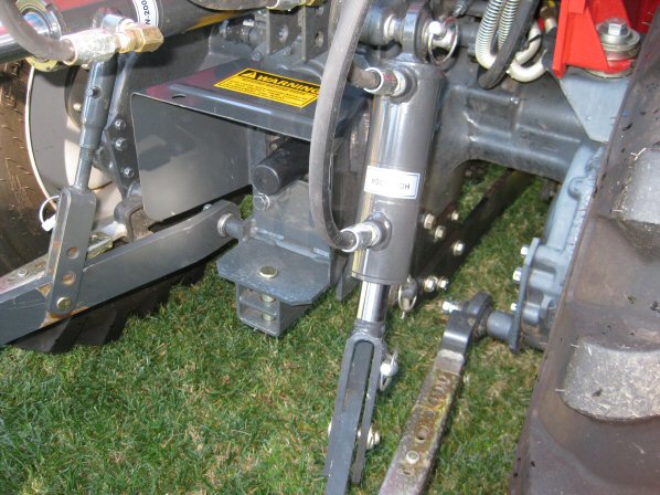

While this is true, it is not needed in my opinion. I typically am continually adjusting my hydraulics to meet my constantly changing requirements. So to have something set in a position for extended periods of time just does not happen in my circumstances anyway. I have a 2" set of "TnT" for my 3215 and a 3" set for my 7520. Neither set has given me any grief due to leak down. I am not saying that they do not leak down, I am saying that the small amount that they might leak down does not matter for my circumstances.
Most people here will disagree with me, I am only saying what works good for me. If you are tight on money, in my opinion there is no reason to spend the extra money to get the DPOCV.
