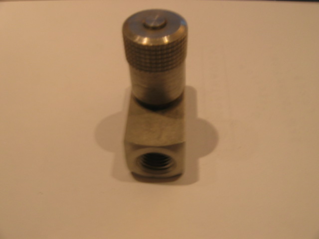

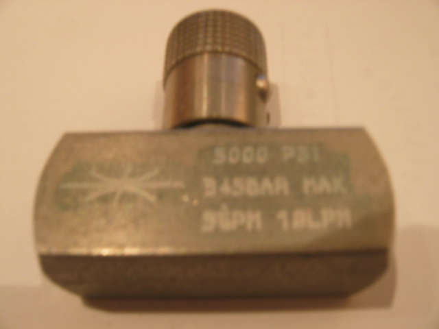

You need to install one of these. Made by Parker and will control flow 0-5gpm at 5000psi. They come in many pipe thread sizes. You can lock it where ever you want once you get it set. Parker part #N400ss. This one is stainless but you can get them in steel as well. I put one of these on the angle cylinders when I mounted my truck plow on my loader arms to slow the angle down. You only need one on either line to restrict the flow in both directions.
Dan
