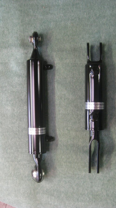

What length for a hydraulic top link is needed? Do I just measure the one that came with it for the length I need? Be nice to adjust the implement without having to get off tractor. Mainly for Box blade, and EA 7' Landscape rake and future tiller. It does have a quick hitch on it.

Normally I provide a 2 1/2" dia cylinder with a 1 1/2" dia rod. The tractor end has a cat 1 end and the rod end has a narrow (1 3/4" wide) cat 2 end with a floating reducer bushing. This allows for use of both cat 1 and cat 2 implements.
The working length is 18 1/2"-25 1/2".
Look at the following link. Hydraulic Top link size for Mahindra 3540 PST
Get the asked for dimension and look for a top link that is close to that dimension when it is extended half way.
