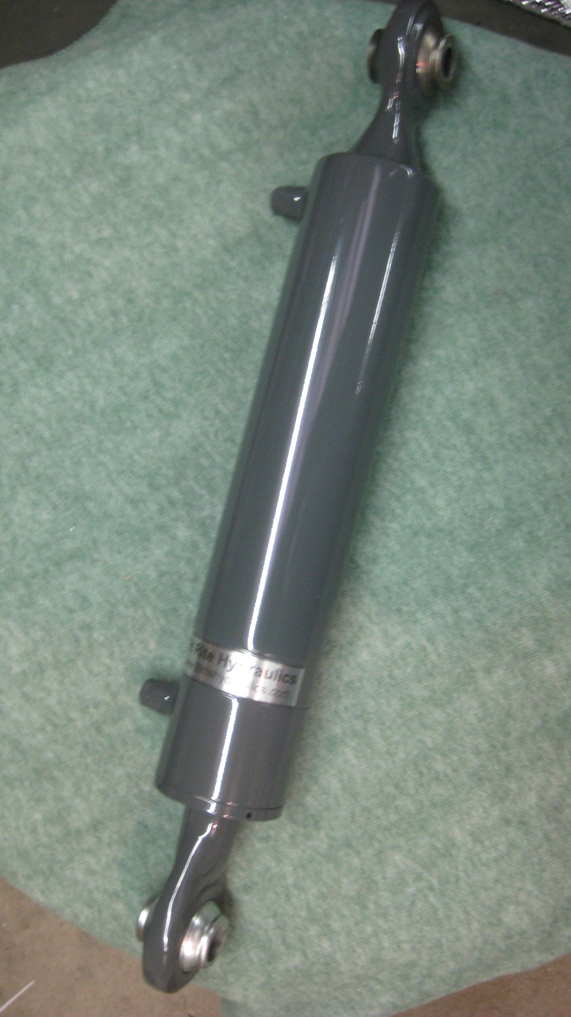

Anyone install a HTL on the M9540?
If so what size did you install?
   / Hydraulic Top Link M9540 #2
I typically supply a 3" dia cylinder with a 1 1/2" dia rod with a working length of 23 1/4"- 35 1/4" for your model.
Remember that these tractors use a cat 1 pin size at the tractor end when you are looking.
If you would like a total shipped to your door top link kit price, fill out the contact page on my website. That will give you something to compare to. ;)

Mine is a cat 2 (1 inch pin) and will have a look

Your tractor has a 3/4" pin at the tractor end from the factory. A 1" pin at the implement end. ;)
