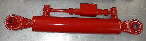

I have been reading all I can about the hydraulic top link and I have decided that I want one for my BX 22, however the more that I read, the more I get confussed. I found this thread and it seems quite concise and shows the correct top link cylinder. I know that the BX 22 does have the hydrolic lines in the rear and I know that I have to add a valve to complete the curcuit. I just don't know the correct valve that needs to be used. I think that it is a open center with power beyond, but I am not certain. How about some of the experianced people jumping in here and helping a novice? I know very little about the plumbing of this, so all the help and description will be needed... thanks Junkman.... link to TBN post that shows the cylinder for a Cat 1... 3 pt hitch...

In your attachment, you show a cylinder with ball end rod attachments. Just curious where you got that type of cylinder with those end attachments.
thanks
Duane
   / Hydraulic top link for BX22 #9
The picture of the top link cylinder junkman attached is the one that CCI sells.
CCM
