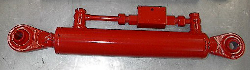

has anyone made there one hydraulic toplink assembly for a 2320?
if so can you tell me what you did and installed?

A complete Top Link kit for your 2320 that includes a cat 1 top link with a working length of 17 1/2"- 25 1/2", a hose kit with quick connect ends and a hydraulic flow restrictor would run you $240 + shipping. You might need to get the control valve, or do you already have that?

areyou talking about a divertor valve?

I'm not indicating any type of valve. Just that if you did not already have any rear remotes you will need some type of control valve. If you only want the one rear remote, then a diverter valve may be your easiest option. ;)

Depends upon how your tractor is configured. I have two sets of control valves connected to my joy stick. They're physically located beneath and forward of the right cab door. I assume they're in the same location on the open station. One controls the loader lift and curl, the other controls the two sets of rear remotes. My HTL is plugged into one of the two rear sets. I have an illuminated electric switch on the right console that determines which is connected to the joystick. When I want to operate the loader, the switch is in position 1. When I want to operate the HTL, I have to move the switch to position 2
But that's not the only way hydraulics on these CUTs can be configured. If yours is not like the above description, another owner will hopefully chime in.

Complete with the anti-creep DPCV for $185. This has a hardened and chromed push rod with teflon rings. Forged CAT 1 ends. We have been selling these hydraulic top links for over 15 years and the first to market these on TBN.

IMO, and I use a top link all the time I would get one without the check valves. Much easier to feather the adjustment without checks in the lines.
