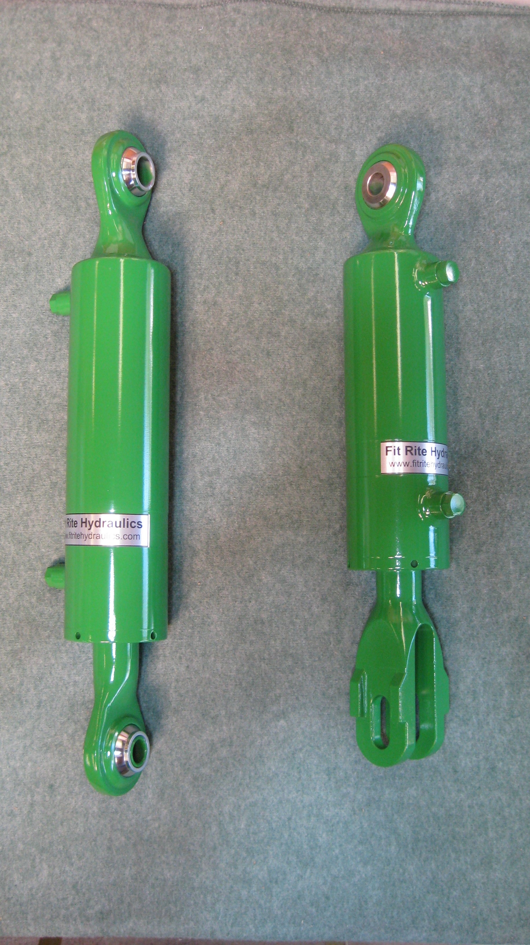

Fit Rite Hydraulics. And here is what I would be providing. If you don't get it from me, here is what you should be looking
A cat 2 top link with narrow cat 2 ball swivels at both ends. A 3" dia cylinder with a 1 1/2" dia rod having a working length of 19 1/4"- 27 1/4" similar to the unit on the left in the picture.
No issues with a full 3pt quick hitch.
The rear SCVs on these tractors have not been an issue regarding leak down. The issue with having a check valve is that makes the cylinder unable to make use of a float feature if you have that feature with your SCV.
The cylinder is available with the check valve, just not really needed for your model.;)

To add to Brian’s comment if you don’t find one with a narrow cat 2 ball you’ll need a grinder to make it fit. I went with one from Agristore USA and the check valve banjo fitting can also contact the top link bracket when raised causing damage/leaks. Ask me how I know. Other solution is buy a cylinder with the fittings oriented to the side (as it appears Brian’s is) vs top.

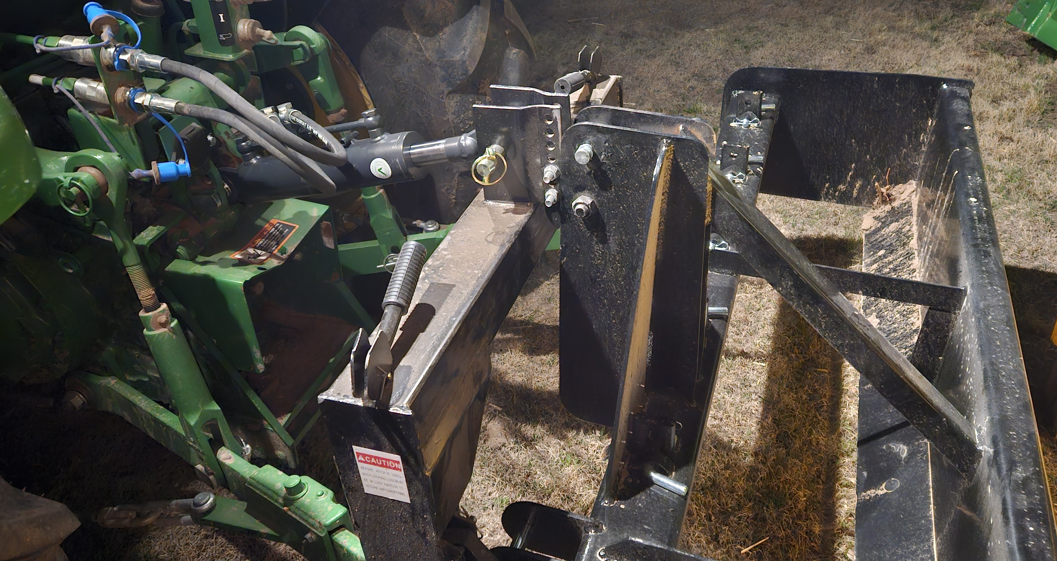

I ended up going with a Spare Parts Holland off of Amazon. I had to grind down the eye on the top side, but that only took about 15 minutes. I also removed the keeper so it wouldn't get jammed. Other than that, it seems to work well.
I tried it a little with the box blade. It makes hooking and unhooking with the quick attach easier and I really like being able to adjust the angle of attack as I go.
The Fit Rite setup looks nice, but I didn't want to wait for the lead time.
