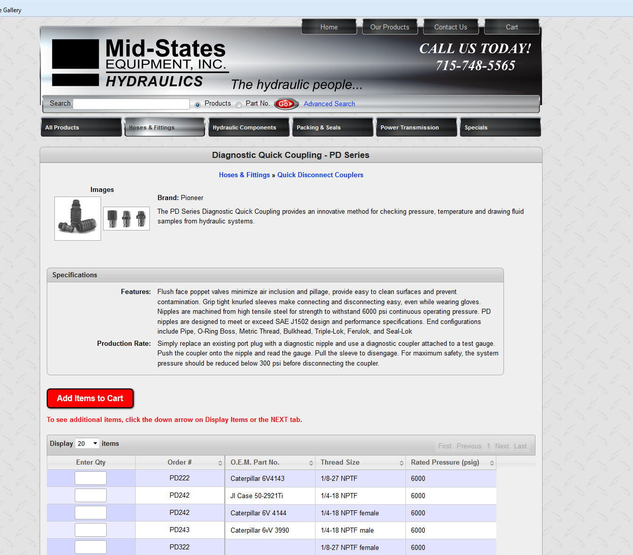

Where can i find the female quick connect for all the hydraulic test ports on John Deere equipment, such as those found on 7410 tractors and 9X00 combines?
I cant bring my self to spend $1,000 on a set of gauges from Deere, sorry.

You might try this place.

Have you searched with Pioneer? A good dealer with a catalog should be able to provide reference and order one.

A couple choices, all cheap compared to JD... Motion Industries or any Parker Hannifin/Arequip stocking dealer will have the QD and glycern filled guage you need. I got mine at out local branch of Motion Industries (It's a Parker btw., and a guage for 40 bucks).

Judging by this catalog, the Pioneer part# is PD242 for a coupler with female 1/4" pipe thread. Now ive just got to find a dealer either online or near me.
   / Hydraulic test port quick connect #7
PD242 is listed in the photo I posted. Try calling phone # 715-748-5565
My internet was being slow last night and wouldn't load that page, i'll try them Monday. I found one place online i could buy them for $28. I'll make sure to buy 2 to have one on standby.
Thank you all.
