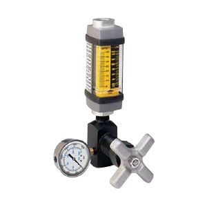

Looking for ideas --- I see a number of technicians using the QuadriGages (low, medium, high gauges mounted on a "tree"), also sourced through HydraCheck and many "low cost" hydraulic test kits on the market.
I have an old JD flowmeter, would like a general hydraulic test kit for checking main pumps, relief valves, steering, etc (don't need adapters -- have a tool box full). Recommendations?

Ok -- did an upgrade ($700 total) and have pretty much everything I need in a complete hydraulics test kit:
Hedland 0-50GPM Flow Meter
Adapters
Control Valve w/PSI Gauge
Just used on a 5065E -- isolated the problem in one minute (after spending 30 minutes hooking up the adapters/test ports). The flow meter was installed horizontally and works in any direction (unlike the picture suggests). No more trips to the dealerships and down time.
Helpful to know what problem you isolated when using the Hedland kit. just curious how it worked for you.
   / Hydraulic Test Kits -- Thoughts? #5
My experience when I served as a JD dealer service manager for "13 long yrs" that the Hedland flowrater is a very good hydraulic diagnostic tool.
Was an overall flow problem (GPM)----- system was running at about 40% spec and the main pump was worn out.
Darn handy tools -- saves a service call / trip to the dealer.
