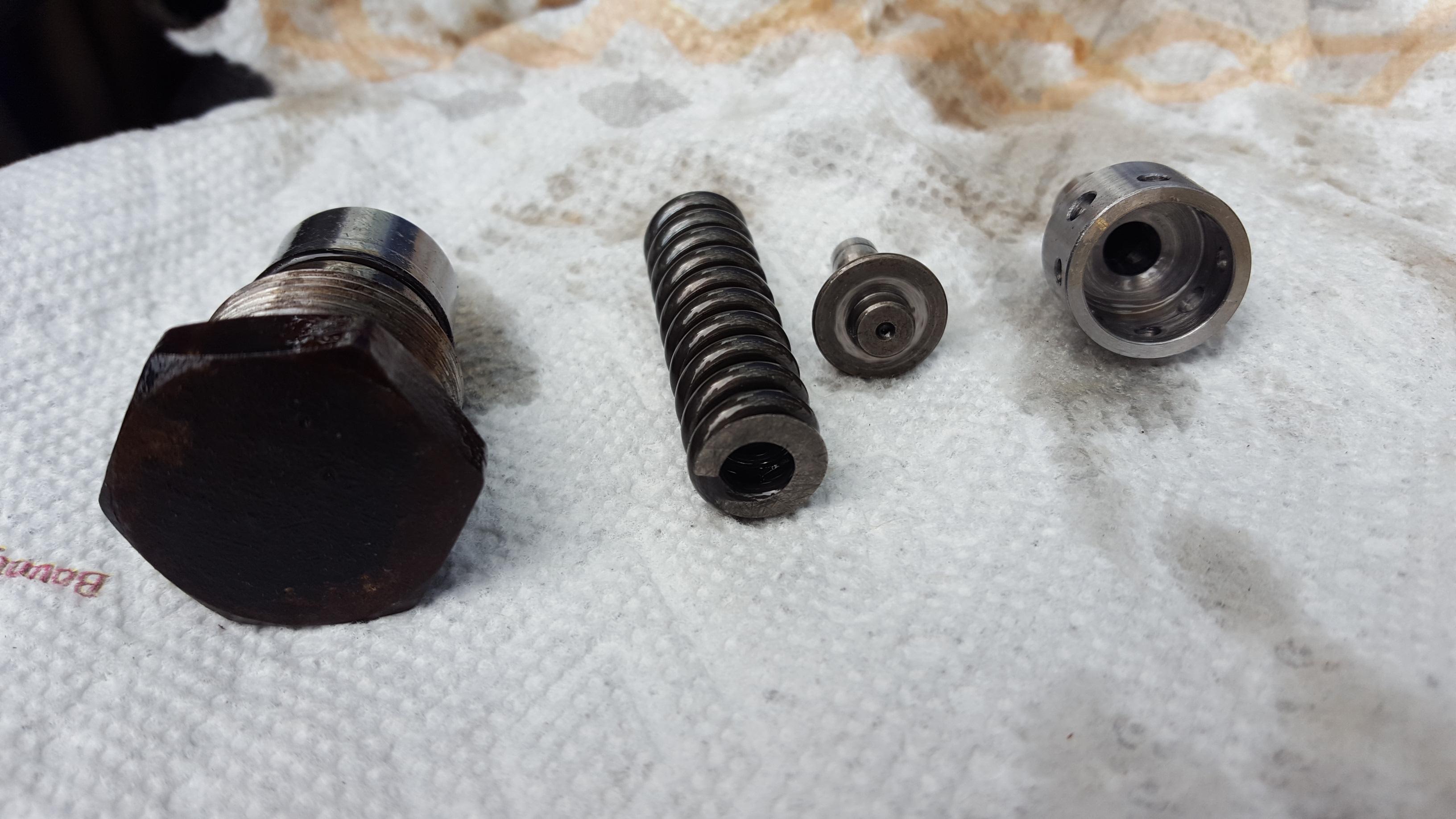

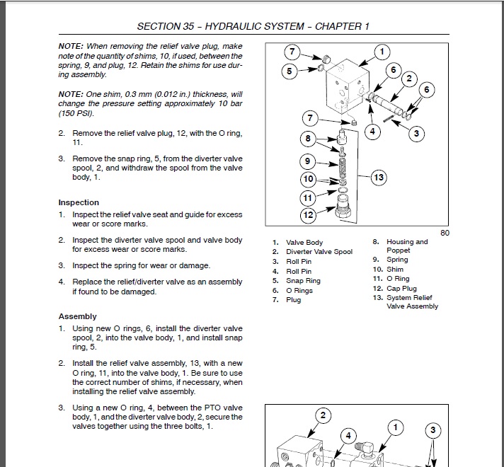

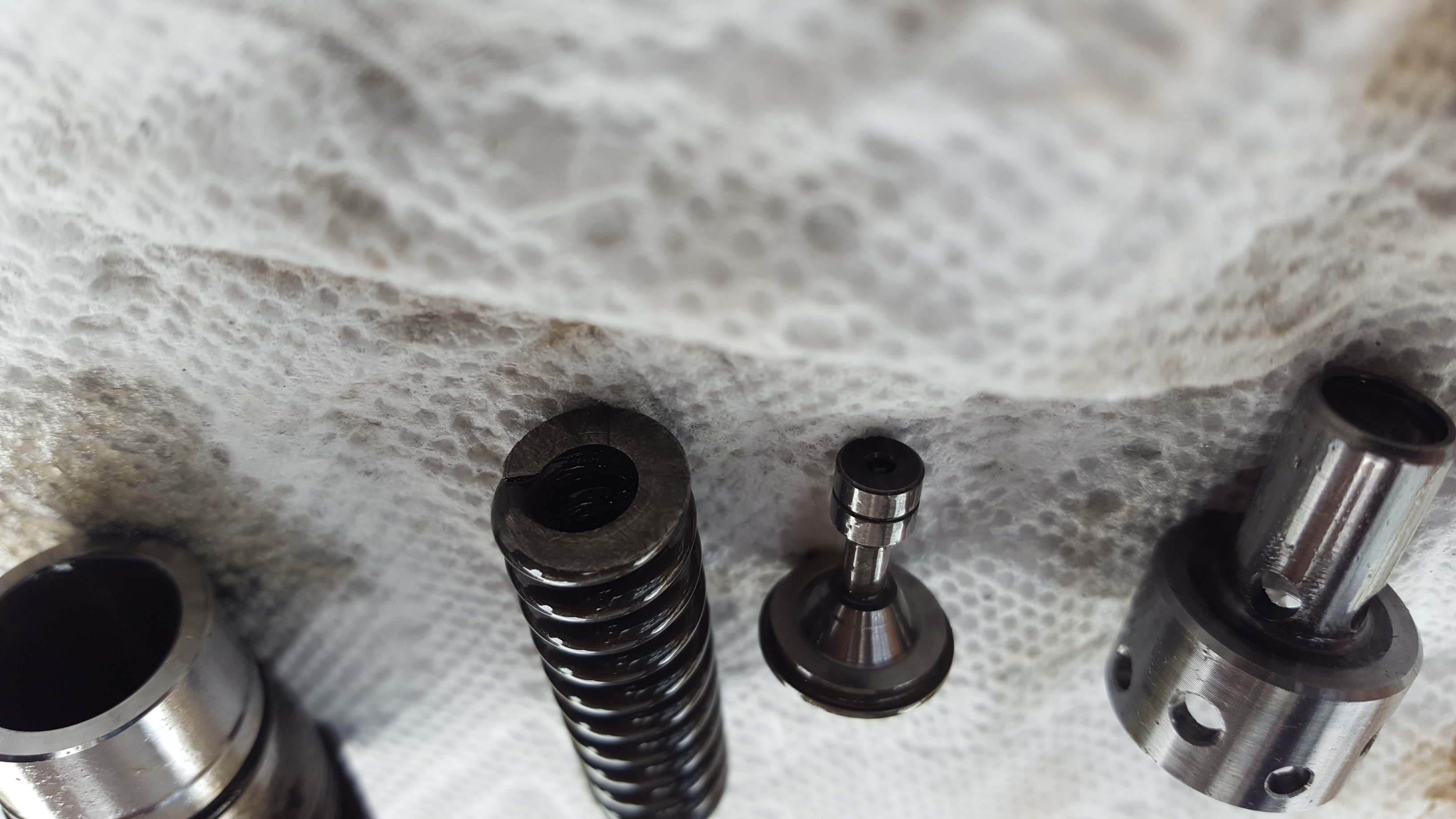

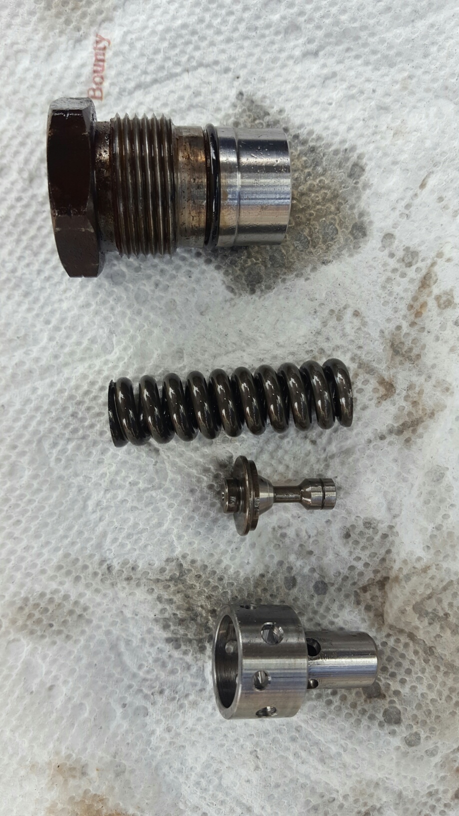

I pulled the relief valve this morning. There were no shims in it, which seemed odd since the manual calls for them but, I don't otherwise see any obvious issues with it. Since the shims only add 150PSI each, I can't imagine that the lack of them is the root cause of this.
I'm working on removing the whole divertor valve but am having some trouble getting the PTO line off of it. Decided to take a break before I started throwing things. :)

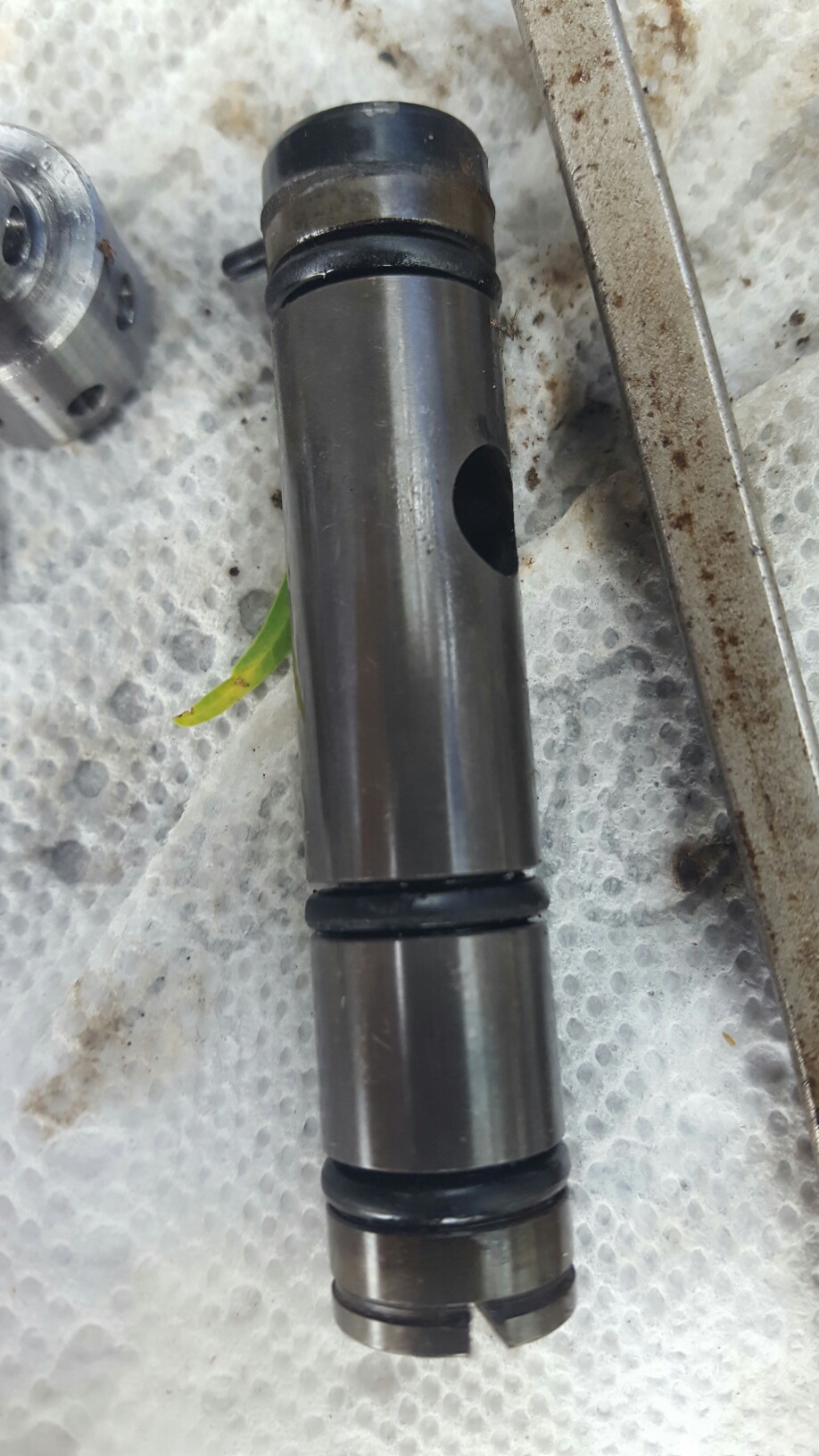

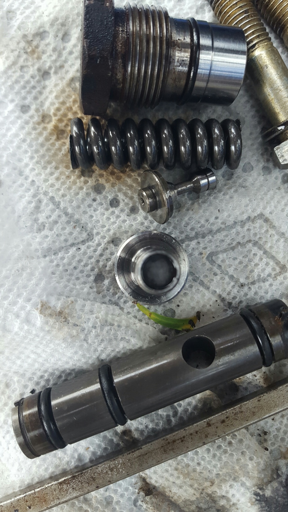

Got the divertor valve out, it looks OK to me also. I guess I'm just going to replace all the O-Rings, the filters and the fluid (again, this fluid was changed 15 hours ago) and see if that helps. I don't know what else to try/check. I guess if that doesn't do it, it's going to have to go to a shop.

What does the diverter valve do on your machine? To me "diverter" indicates it directs fluid to multiple points. If this valve is attempting to divert or dirct oil to various functions and is sticking or binding it could cause the symptoms you are describing. If the spool and or bore have nicks or scratches on them be very careful when polishing them to prevent rounding of the metering edges / "lands". This can adversely effect the valve operation.

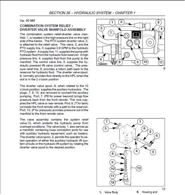

It decides whether the valve block sends fluid only to the 3 Pt or to additional hydraulics, like and FEL. Here's the manual page which describes it better than me.

If this is not a sliding valve I doubt it is your problem. I was refering to a spool that slides in a bore against a spring load.
   / Hydraulic system troubleshooting help, I'm stuck
The only thing I can think might be an issue with it is that it could be leaking fluid past the o-rings to the bypass and causing me to lose my pressure. Maybe the same problem with the relief valve, I'm going to replace them all and see what happens.
